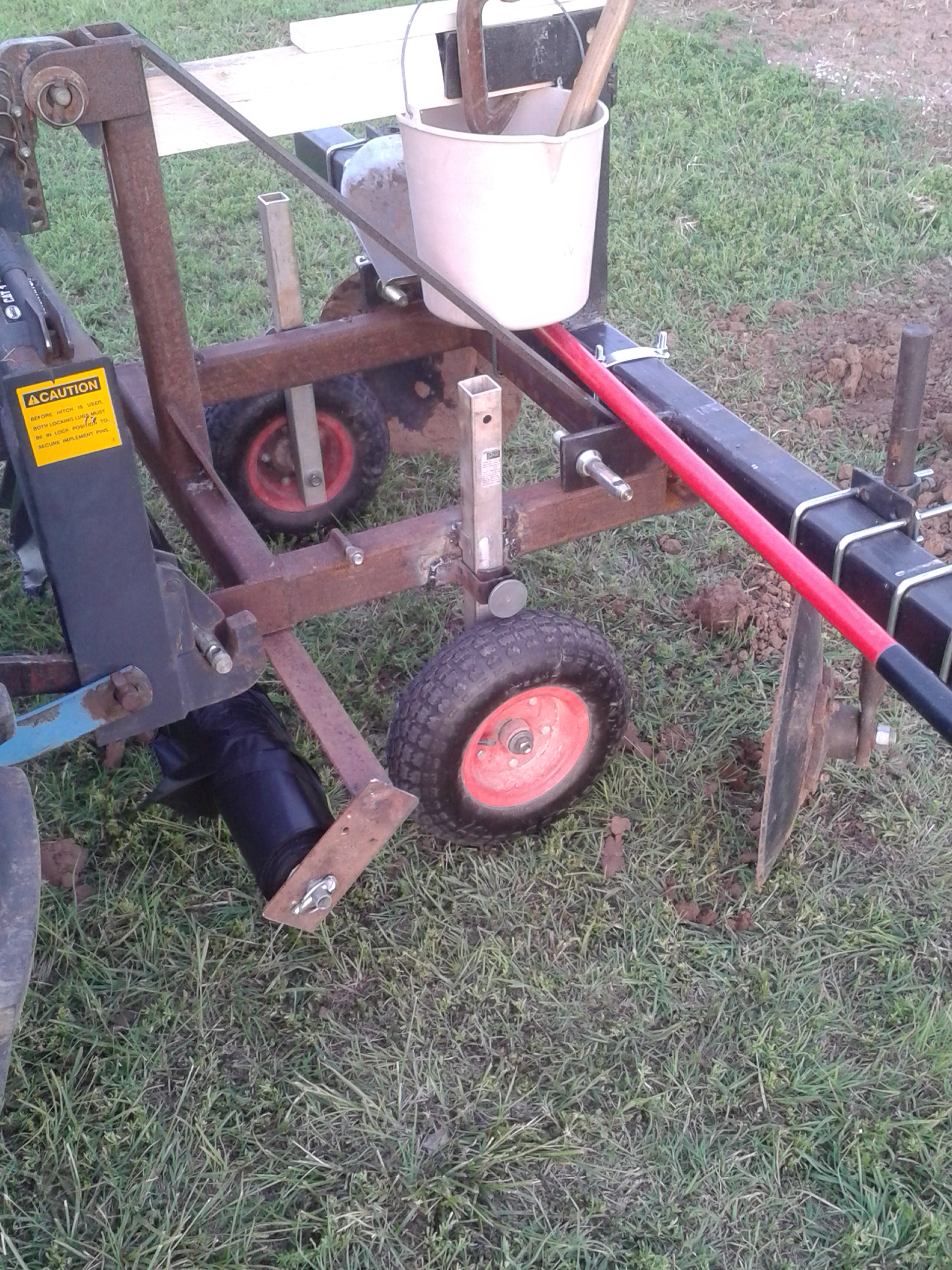

I made one, looks funny and is shorter than store bought ones, but it did work. I studied what they were doing and how they worked by watching you tube.

I'm trying to figure this one out as well. I've built a disc hiller that works great. Looks like you incorporated yours into the design 851, that looks good. The longer, store bought ones form a bed, don't they? Do you have anything you'd do different if you built another? Mark

Well I move those disc in some to form the bed. I have one of those hand roll sod rollers that is clamped to the tool bar at around 8" from the ground. That what seemed to work for me.
Doing it over, make it longer, use smoother type tires. I would still have my tool bar removable because it is used for other things.
When I enlarge my garden, I'll probably buy one already made. Can't remember where I found one for around 1200.00.

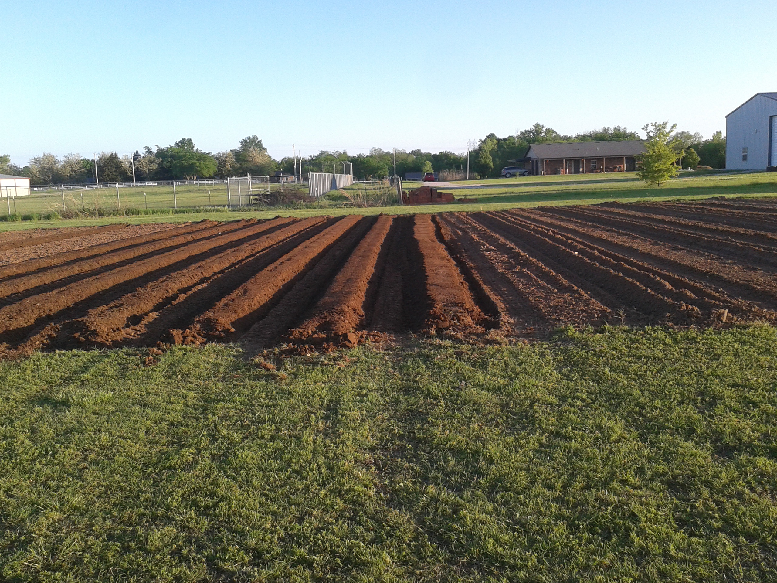

here are some pictures of some rows
