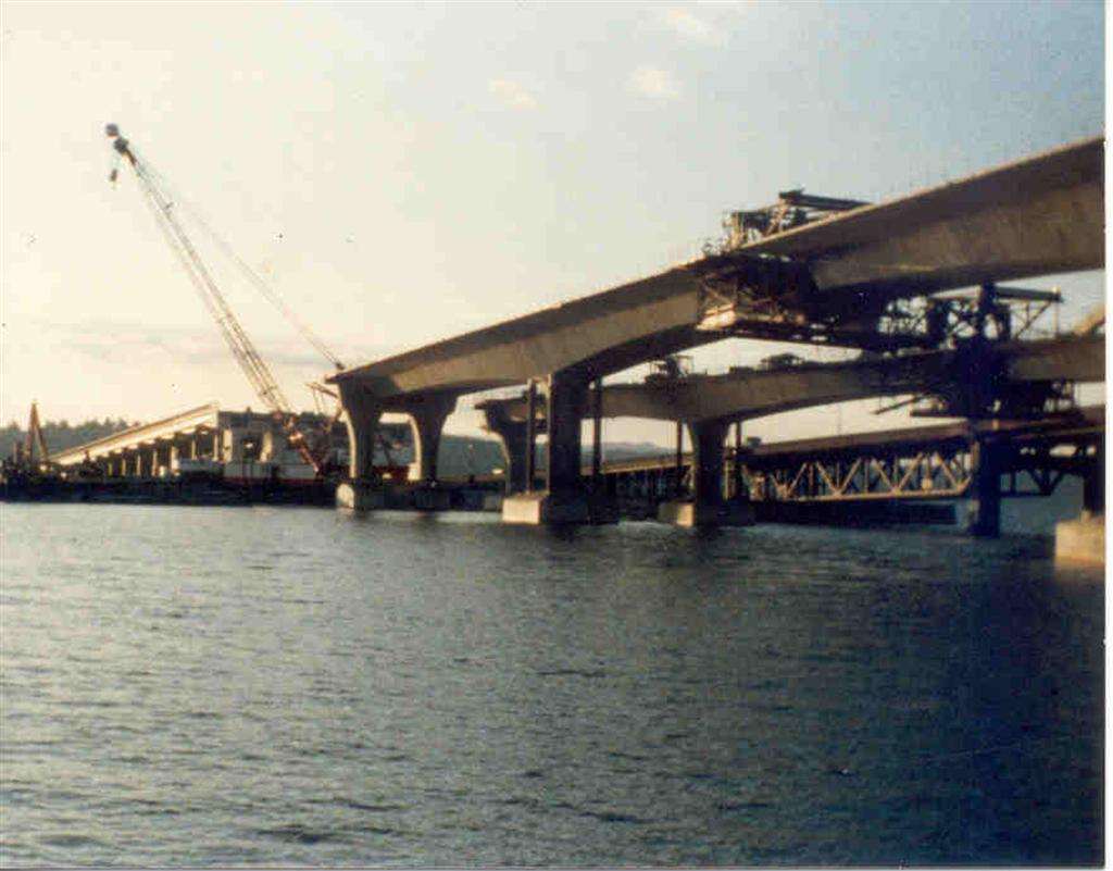

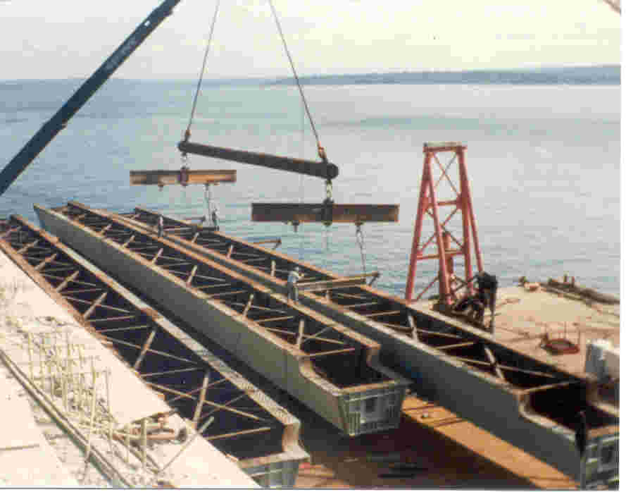

Rut roe, I welded these down with a wire feed.:D
   / Plate thickness for pintle hitch #14
with all due respect, I am sure you know what you are doing and you know how to set up a machine and multipass a beveled vertical t joint while laying on your back. and then have it xrayed... I get it... you know what YOU are doing with a wire feed.
BUT we are talking about a first time welder doing load bearing work with a harbor freight wire feed.
maybe I am right, maybe I am wrong. Weigh the facts here and you make up your own mind.

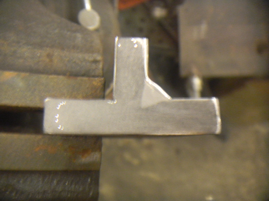

Your broken weld might be more a fault of using the wrong wire or welding on a heat treated frame without the using the proper procedure rather than from welding with a wire feeder. What ever process is used, a 10 ton hitch on a truck should not even be considered by a beginner welder. Some jobs just require experience and know how and a heavy duty hitch is one of those things. There are flux-cored and solid wires to cross to most stick electrodes. The welders sold at Home Depot even though they say Lincoln on them aren't a whole lot better than HF welders. If you want a good welder the box stores aren't the place to go.
   / Plate thickness for pintle hitch #20
I've said it before, and I'll say it again. When it comes to wire feed welding, there is no substitute for horse power! :thumbsup:
