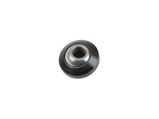

I've put nearly 800 hours on my PT-425 and am starting to get concerned about the amount of play in the four joints of the lifts arms.
I lubed them every eight hours, but even when I first got the PT it seemed that the balls of the lift arms turned on the bolts (got lube into that area all the time also, just in case).
The bolts are not loose, but no matter how tight they are, the ball doesn't turn in the lift arm, just on the bolt.
So - I'll probably replace the bolts at some point, but wonder if there's a way to replace the balls.
The good news is that the looseness of those joints and the quick attach plate play from wear over the years, when I plow the blade has enough play that either end can go up or down an inch or so.

The swivel eye joints are designed to swivel, not rotate. If anything should wear out, it should be the center, as it rotates.
To upgrade this a little. Although the swivel eye probably does not wear out, if it did, then you could cut it out and weld in a new one. However, if the mating surface for the swivel eye is worn, you would have to cut off the end piece and weld a new swivel unit back on. As in 13279 below.

As I said before, the ball should not rotate, but have a side to side movement.
I would loosen the sides to allow up and down movement, or you will be wearing both the center, and the ball, wearing out the race part of the assembly.

In an ideal world, the rotation of the lift arm on the joints would be perfectly aligned, and you wouldn't need to have a swivel.
If you expect misalignments, either because of inaccuracies in assembly, or because the user of the equipment can be expected to bend the lift arms, then adding swivels will keep the equipment fully functional.
But, yes, the equipment should rotate on the bolt/swivel interface, not the swivel/arm interface.
If the arm is moving laterally on the bolt, then washers would help confine the movement to a single bearing surface and minimize the amount of dirt on the load bearing surface.
