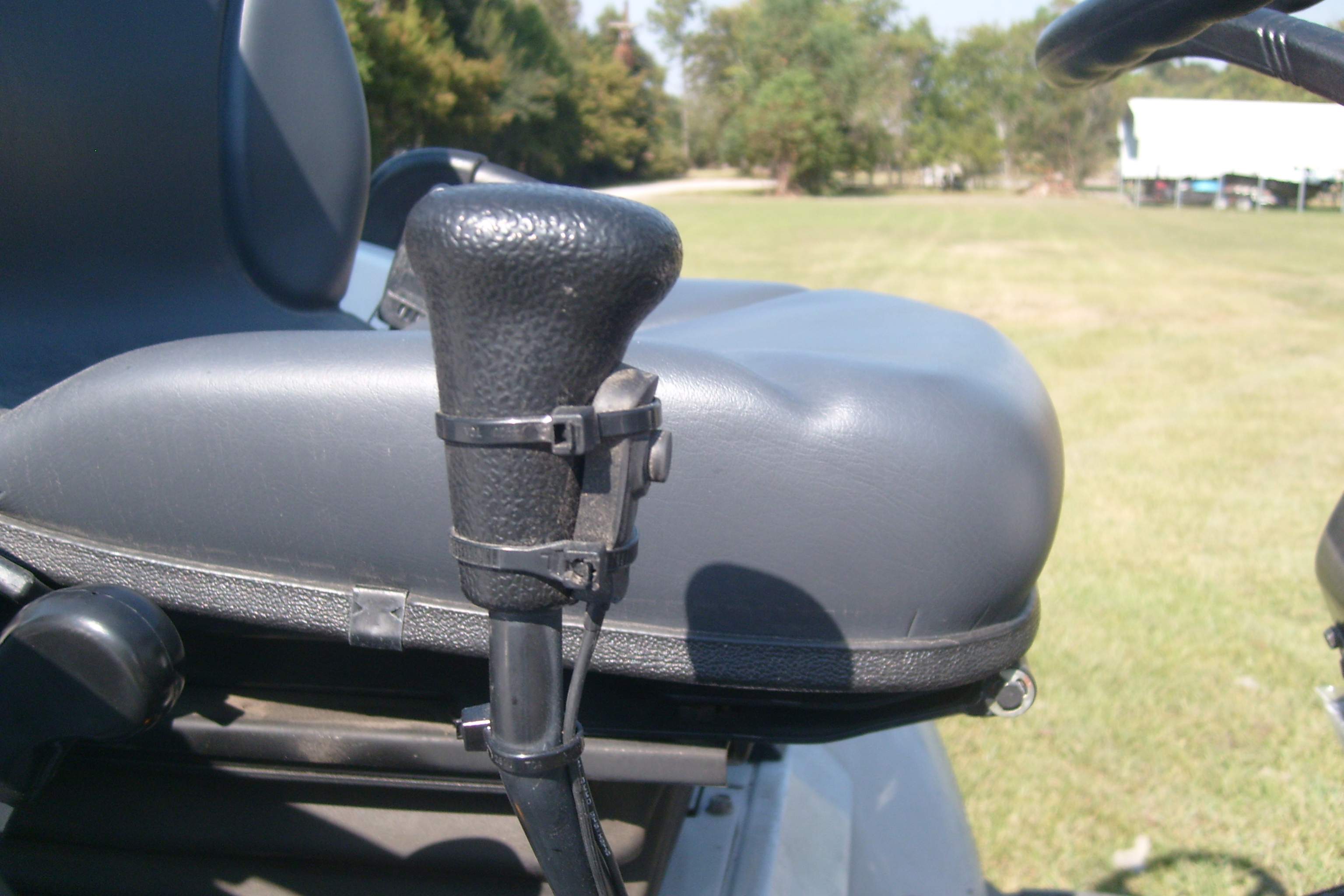

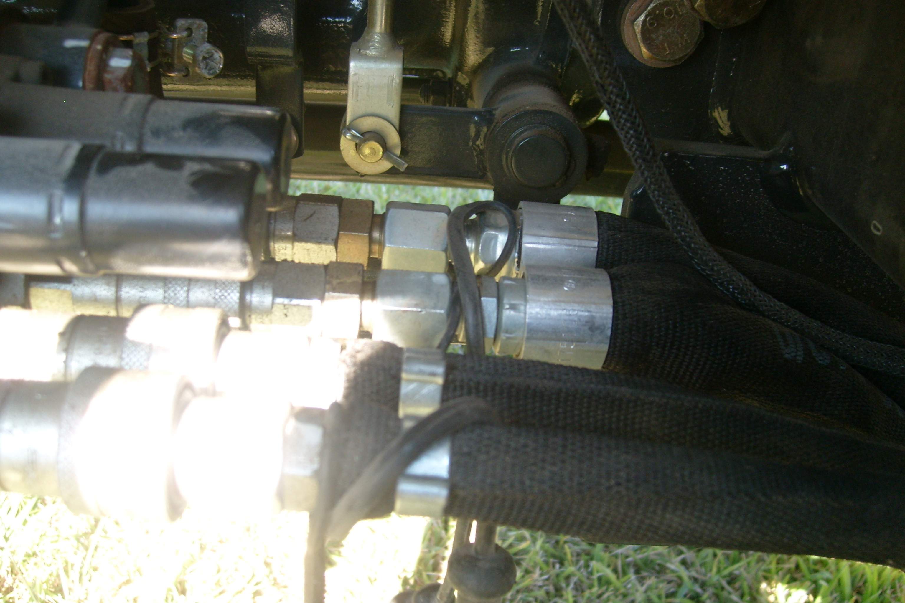

Thanks for posting the additional pics. Though I must admit I'm even a little more confused. Is the front remote actually a third function instead of an Aux? It seems likes it might be given the wiring and solenoid attached to the FEL. Is there a button/switch used to activate it? Also what is the source for the hydraulic fluid? It looks like it might be in common with the curl function? It would be interesting if it was plumbed as a power beyond type configuration, although I'm not sure if the Bobcat FEL joystick spool supports that.
Steve
steve looks like the two lines closest to the motor that feed the fel out of the qa's go into that diverter with solenoid to send fluid to the front aux their is a thumb button attached to joy stick by wire ties sorry its tough getting good pics of that area but included a couple more .
sorry I'm not the best on hydro but learning a little as I go , so I might have misdescribed front as aux when it is somthing other. with that said with the set up I have other than grapple what can this be used for ?
