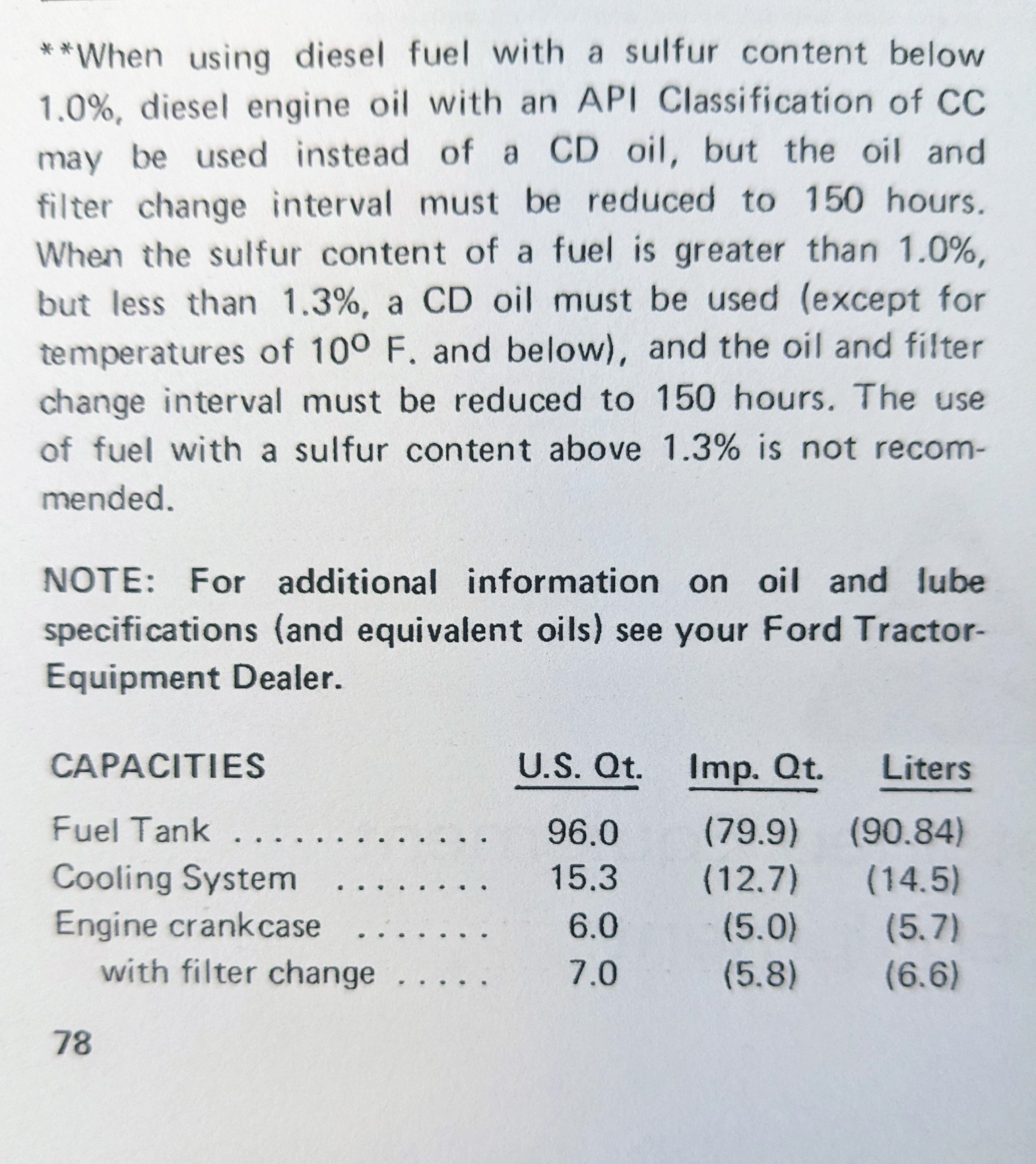

I do not believe I said 1975? I did say 550. So possibly 1978.
Manual is not where I thought it was.
As soon as I locate it, will post what the reference is in the operators manual.
Ok finally found the manual, I conflated a couple things and am in error.
under 1% sulfur reduce oil change interval
The part I got backwards
The use of fuel with sulfur content above 1.3% is not recommended
This 550 did have a CAV injection pump failure just before i bought it and was replaced.
My 1993 Rhino tractor has a decal that recommends a fuel system lube be added.
Good Stuff!
Looks like the operators manuals from late '70s/early '80s semi-tractors.
That's the way it was.
Thanks for posting!
