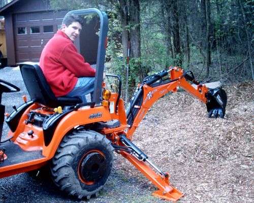

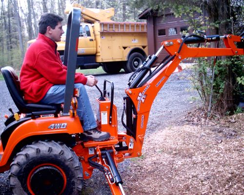

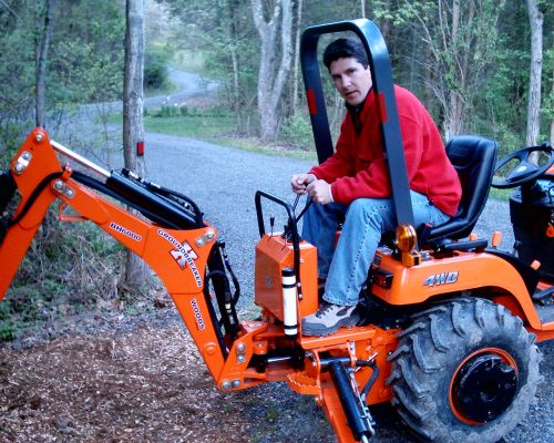

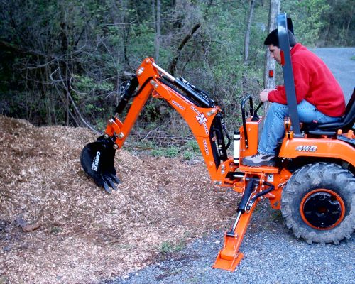

I don't have any pictures of myself on the tractor under the ROPS on my BX23 but the pics the other posters put up gives a pretty good representation of the operator position to ROPS height. What they don't show however is that the ROPS on the BX23 is also tall enough that you can stand up in the backhoe operators seat and still not hit your head on the ROPS. I have thought a few times myself that the ROPS is too tall - mostly because I keep thinking about adding a canopy to my tractor, and I think a canopy on the BX23 will look goofy because it will so far above the tractor. But as far as giving a nice operators station for the backhoe the BX23 ROPS is pretty good.

I'm 5'10" and clear fine (2"-3") Previously I posted about the distance from the seat back corner to the ROPS on the BX2230 during the installation. Look at the pics of that incredibly handsome man... I mean tractor.
