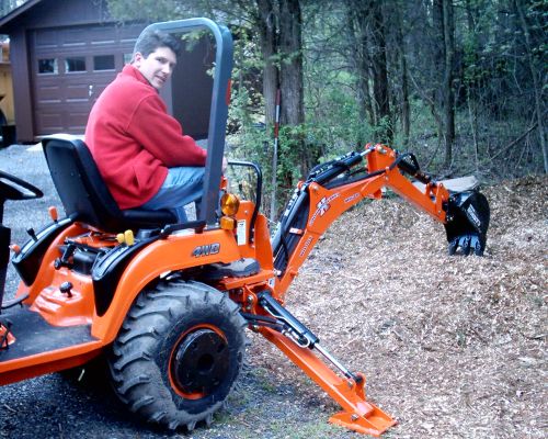

Is that guy really digging wood chips with a backhoe?

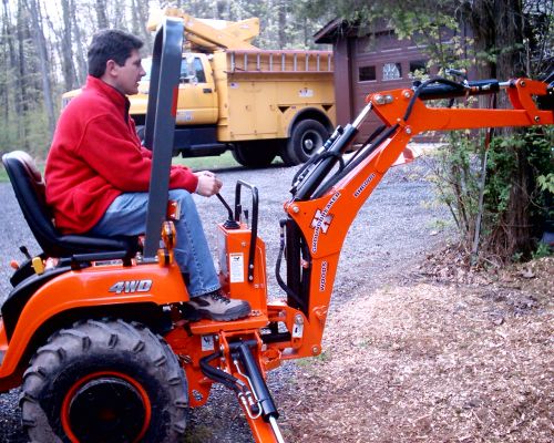

   / Please, Groundbreaker X #22
OK, we've seen just about enough of this dude.

   / Please, Groundbreaker X #23
I think at 5'10" it will do, but I think I would want a taller rops if I was over 6'. One thing I notice though is that you are kind of hunched over when you are leaning forward. Sometimes I like to straighten up an look over the hoe when I am digging in close. Nice setup though. SHould work great for you. Enjoy!
   / Please, Groundbreaker X #24
Woods and SCB
I can tell you for a fact that at 6' 2" I can find the ROPS with my head easier than I'd like. If I had another 6" it wouild not be an issue.
   / Please, Groundbreaker X #25
Sometimes I slouch to lean into the controls, but in regular use when I want to see over the hoe I'm leaning forward well in front of the ROPS. I would assume a 6' person would be the limit. So far I only notice ducking the bar when exiting /forums/images/graemlins/wink.gif
   / Please, Groundbreaker X #26
Why would you need to lean over the hoe if all you do is dig woodchips /forums/images/graemlins/grin.gif /forums/images/graemlins/grin.gif /forums/images/graemlins/grin.gif
Seriously though. I think I like the external cylinders. With mine internal it always makes me wonder if it is properly greased. I like that they are black too.
   / Please, Groundbreaker X #27
It is obvious that you have yet to dig.... the paint is still like new on the hoe bucket. I believe that I might have thought of a perfect solution to the ROPS hight. Have a piece of steel made that has the same bolt pattern as the ROPS and weld one on top and bottom of a piece of 4" square 1/4" wall square tube and make an extension to the ROPS. That way, you can customize it to the hight that you want and not modify the original ROPS. If it is fabricated properly, it will be extremely strong and hold up in a roll over accident. Just make sure to use Grade 8 bolts, lock washers, and nuts.
