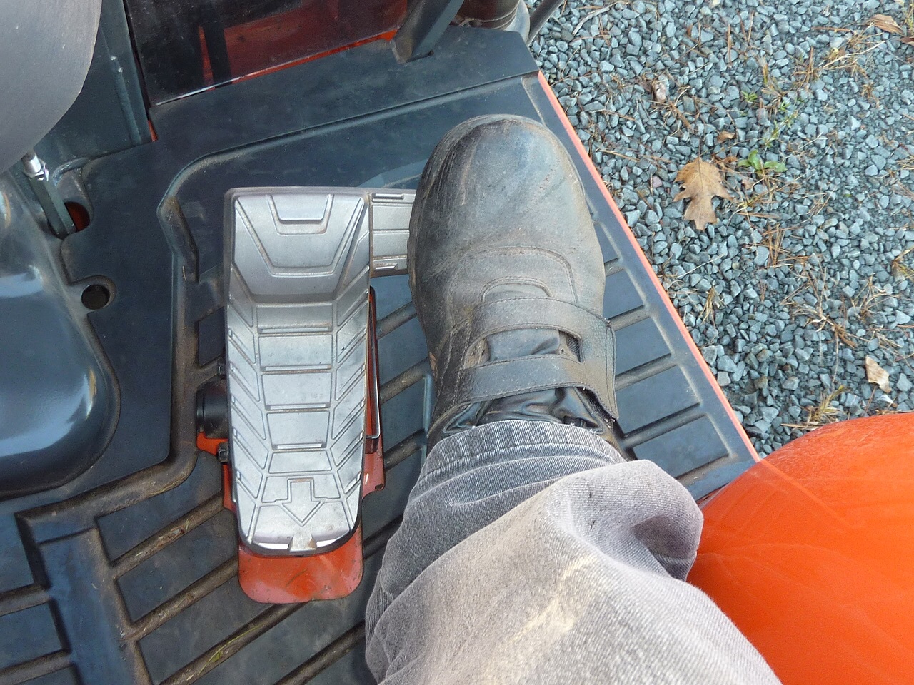

Did you try the rocker pedal on a Kubota Grand L? It痴 way better IMO than the rocker pedal on the standard L痴. View attachment 621349
Hmmm.... I guess it's time for another visit to the Kubota dealer for me. I've not looked at all their models, but just assumed that they were like mine & all had "upsidedown L" shaped type of rocker pedal shown in tractorable's post #43. Mine has that same pedal. and just like him I also use it in both directions by moving my foot so that I push it down in either direction using the front of my foot - just as jchonline described (post #42)....although I'd say he described the motion better than I have.
Anyway, when used that way, the pedal is a reasonable compromise between a true rocking pedal and two different pedals like most of the world prefers. And it has safety advantages for the transmission; it's impossible to push both down at once. Think about that....
What I'm saying is that I thought that ALL the Kubota models had that same upside down L shaped rocker pedal. Is that wrong?
This may be a case of the classic definition of ignorance on my part, i.e. thinking that all the models had the same L shaped rocker just because all the models I looked at did.
I may be way wrong there.
rScotty
