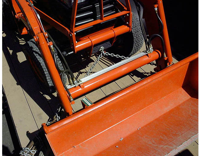

The back is easy - I've got a nice clevis on the drawbar to run my chain thru.
What do you guys use on the front? I was hoping to loop a chain thru the front bumper, but the loader bucket is getting in the way. /forums/images/graemlins/crazy.gif I need to pick up some binders at my dealer, so of course I'll ask what he suggests as well.
Suggestions? Pictures would be great
Thanks

Hazmat,
I don't have a TC18, but this is how I do my B2710. I use a shackle in the front bumper. Had to drill out a 5/8" hole in the bumper, but now I don't get any paint damage by wrapping a chain around the bumper. (See attached photo)

I run a chain through the front weight bracket with the bucket raised, attach chain to front of trailer, tighten binder; then lower bucket and let it rest on the chain.

Von,
Thanks for the pic, does the chain hit the bucket at all? Should I care if it does?

I use a nice beefy 10k# ratchet strap on the back, and a chain in the front wrapped around the bumper / brush guard I made. I use a screw type binder on the chain.
