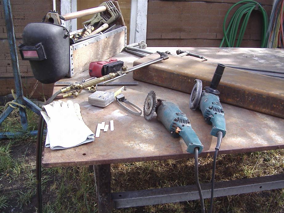

Edit: I forgot budget...whatever I save by not having someone else do it. I like the challenge of DIY. Somewhere in the 500-1500 range for all equipment seems reasonable. This includes helmet, startup consumables, clamps, gloves etc.
the items in this picture (and what you can't see in that tool box) will probably set you back more than $1500.00 and you don't even have a welding machine yet.
if you want some throw away junk welder for cheap... they are flogging them right here... i think i'll even buy one myself.
if you want something decent that you will be able to get parts for in 20 years...
a structural engineer shouldn't have much trouble finding out which are the two brands to buy, or being able to afford them.;).
...except that the structural engineer moved away from Big City and is trying to make a go of homesteading and odd jobs! I do have angle grinders, wire wheel and a place to work.
Folks keep talking about putting these welders on your shoulder and walking off. Just how long of an extension cord do you have!
