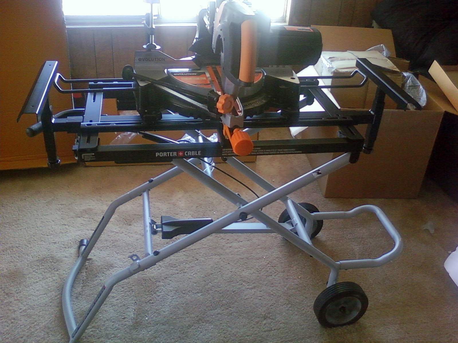

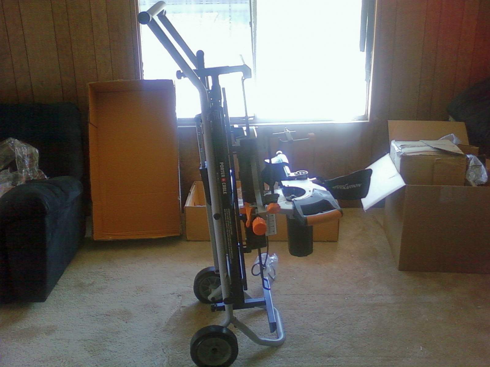

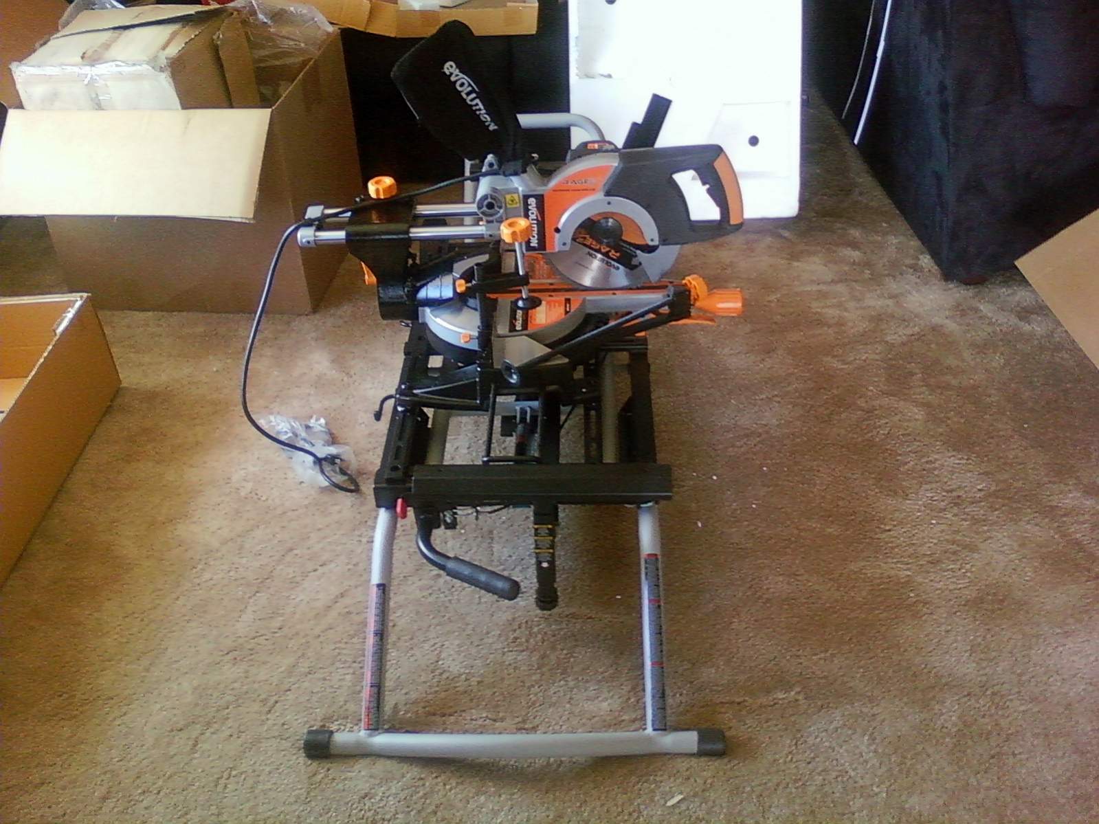

I have used an abrasive chop saw for years and have had several Milwaukee
and De Walt probably the better ones i have owned
I was wanting to point out >> What i think is a more versatile alternative
to an abrasive chop saw...Being able to do both metal and wood and masonry
Being able to use this one saw to replace two saws is a cost and space saver
I only paid 260.00 for the rage 3 which is a sliding compound miter saw
you can get the chop saw version cheaper
Then got a Porter Cable mount for the saw at Lowe's after comparing to the others
As far as hot sharp metal chips i have been around drills,mills,lathes,saws,welders,grinders,torches,sanders.since i was a little kid
it's just part of it
