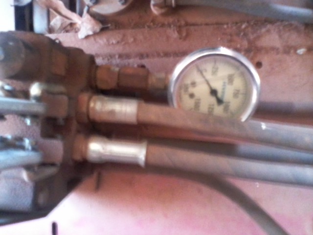

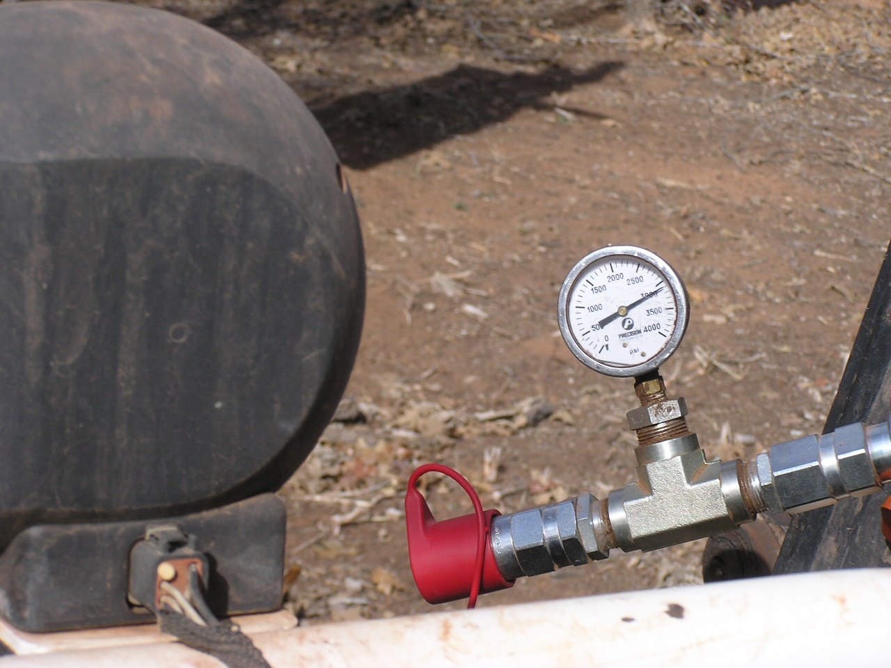

Next dumb question where does the pressure gauge go if the reliefs are in the spool valves? Doe it go on the outlet of the first valve in the sequence? I.E. when I turn down the relief on the spool valve how do I determine the operating pressure?

I like to put pressure gauges close to my relief simply so I can see it while making adjustments. The pressure gauge should be placed between the pump and the relief valve. If you decide to use the double pump system, you would need a gauge for each relief. You also could use quick connects and use just one gauge, and swap for which ever relief you where adjusting.

Wow OK, I assumed the relief valve as part of the 4 spool setup would be the first in line and would only lower the pressure downstream (towards the spool valves) but I guess that makes sense as it would lower the pressure on the whole line.

Yep, the pressure anywhere in the line can't be higher than the relief valve setting, that is how it protects the pump.
The gauge can go anywhere in the pressure line.
On the TORO+Loader it is in the alternate pressure port on the control valve body, where I can see it from the seat.
This is for the other machines with quick connects:
The view from the seat of the V417 showing maximum Aux pressure:
