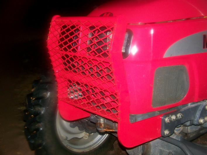

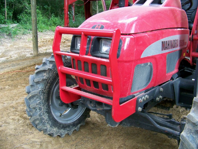

I modified my grill guard as soon as I could.:thumbsup: It came with just two uprights and two tubes.:(
I added flat strap in an upside down "T" between the tubes and a flat strap below the bottom tube, then added expanded steel to it. I had it welded, but bent the expanded steel at work on our 6 foot brake.:)

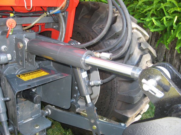

Get the 2nd remote so that you will have the controls for the top and tilt cylinders that you are going to buy with your next purchase. ;)

first off, congrats to mrwinkey on his purchase. second , do wives come with a 5 year warranty ? what kind of arrangement is that on the pic of the top link ?

hey bindian , my grill is a two piece design . guess they had to break it in the middle for hood to clear. i do like your idea.

Not sure what you want to know. :confused: It is a picture of my hydraulic top and side links.

How often do you use the top/tilt? Dare I ask the cost?

I use mine all the time, I am always grading my work in progress. :D Too purchase the top and tilt cylinders with the hose kits, your looking at $510 plus shipping. But then you have the cost of getting the 2 rear remotes and Mahindra only offers one OEM remote, so you would need to go aftermarket of some kind. One of the dealers that I sell to that is in Northern Calif. does the complete setup and gets you 3 remotes for I believe $1600 or so. Once you have top and tilt hydraulics, you will never be without them again. ;) You probably could get a complete setup from him if you needed to. The 3016s are his big seller.
