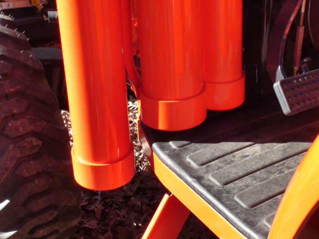

The 4" pvc pipe has worked well for me. Mine is set vertical next to the loader mount.

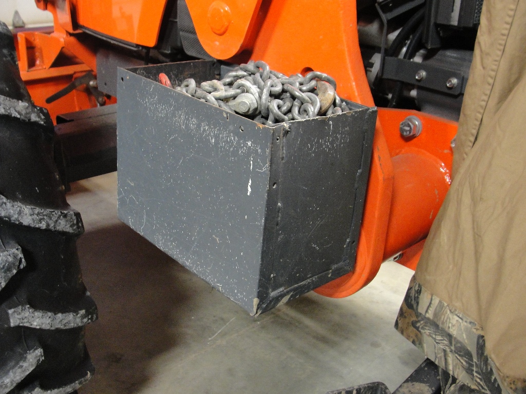

I fabbed up this chain toolbox for my Kubota B2650 out of 1/8 steel, welded it all together, welded mounting studs on it to mount the box to the existing holes in the loader frame. I made the lid pivot in the front so no hinges to give it a nice clean look. Worked out really well.

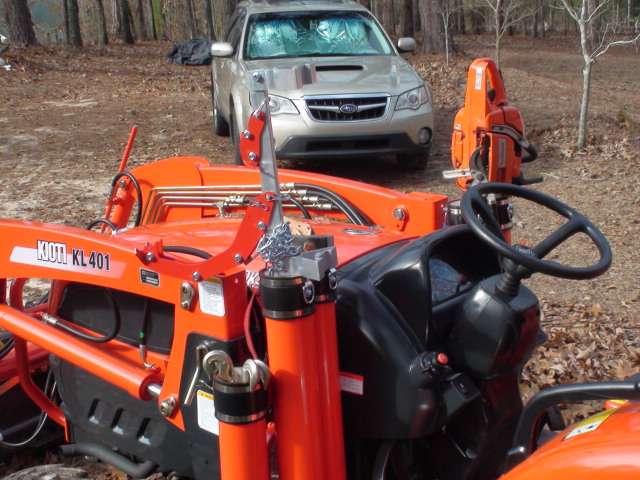

I carry/store four chains on my tractor and use them very often. Here are my PVC pipe setups. But I do not see an easy way to transfer installation to your tractor:

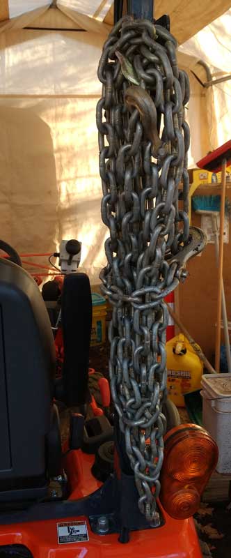

I mounted a grab hook on the ROPS. 20 foot chain hangs nice there.

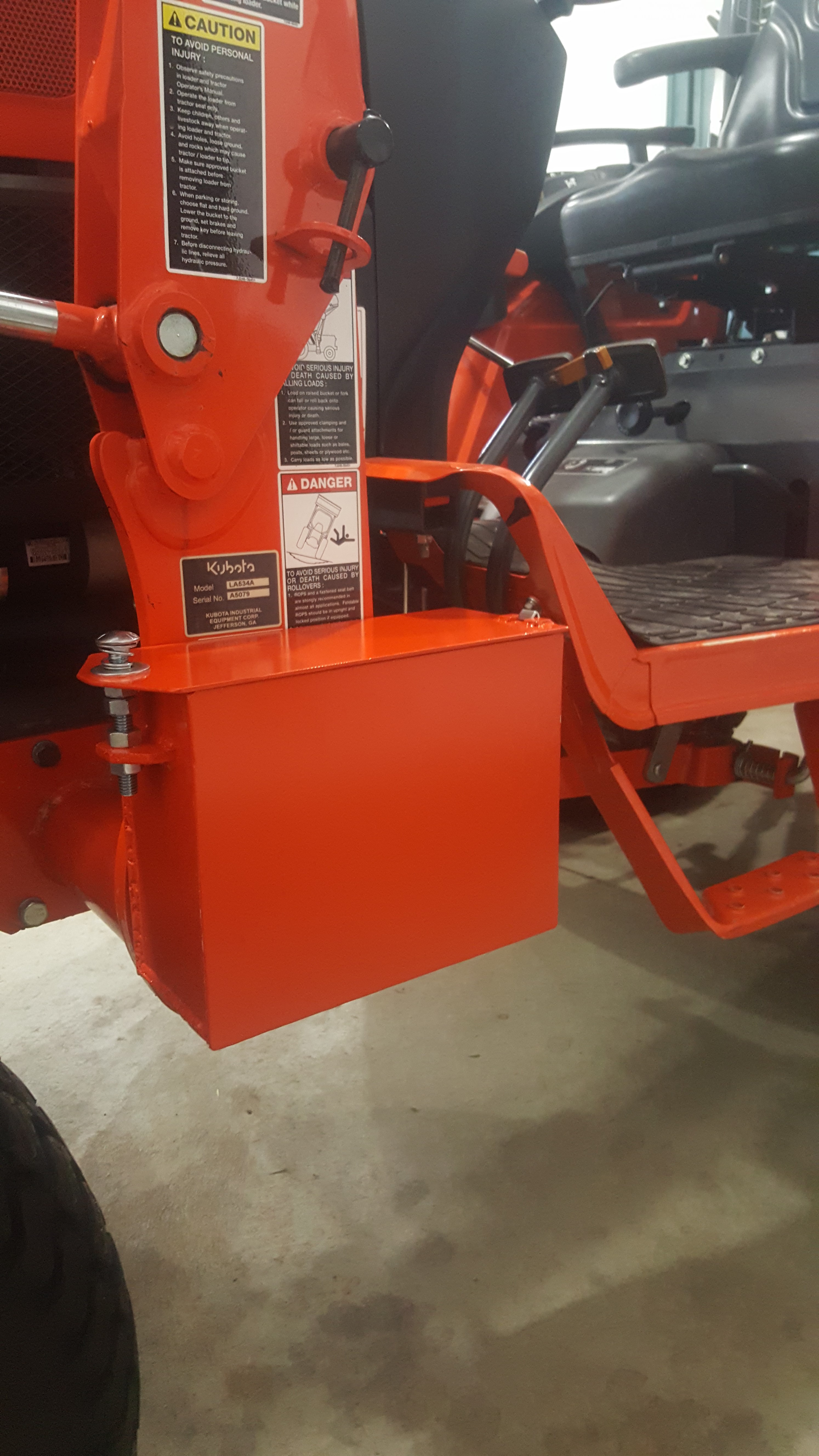

I always carry chains. For my use it's the most needed tool.
Built this one which is fastened to the FEL mounting bracket. Second pic is what's in it.

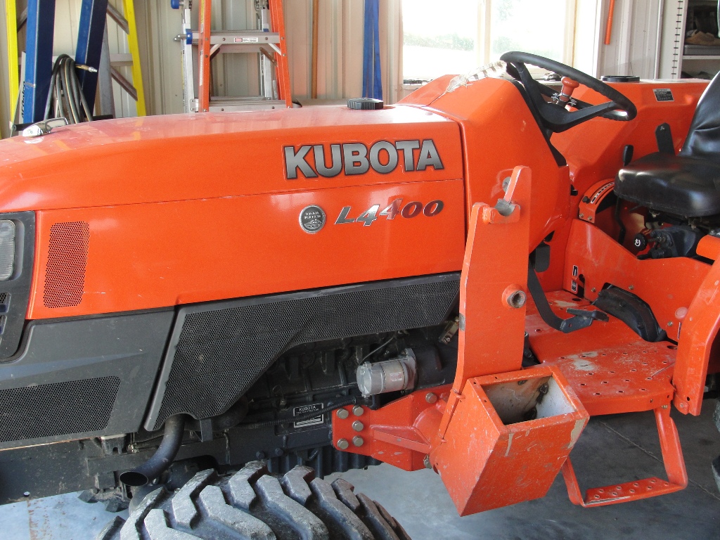

Here's a slight variation from a previous tractor.
I want the chain box as near the operator station access point as possible. Step down onto the ground and grab a chain without having to walk around the tractor.
