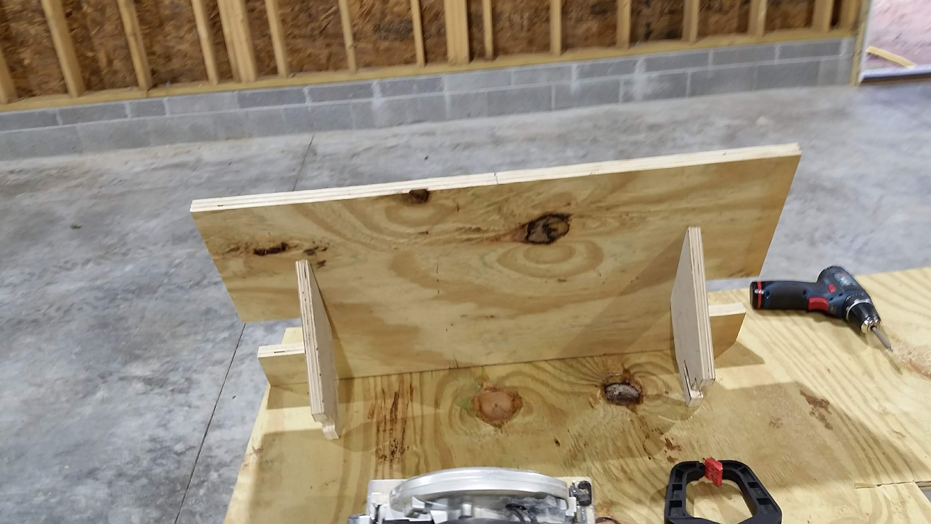

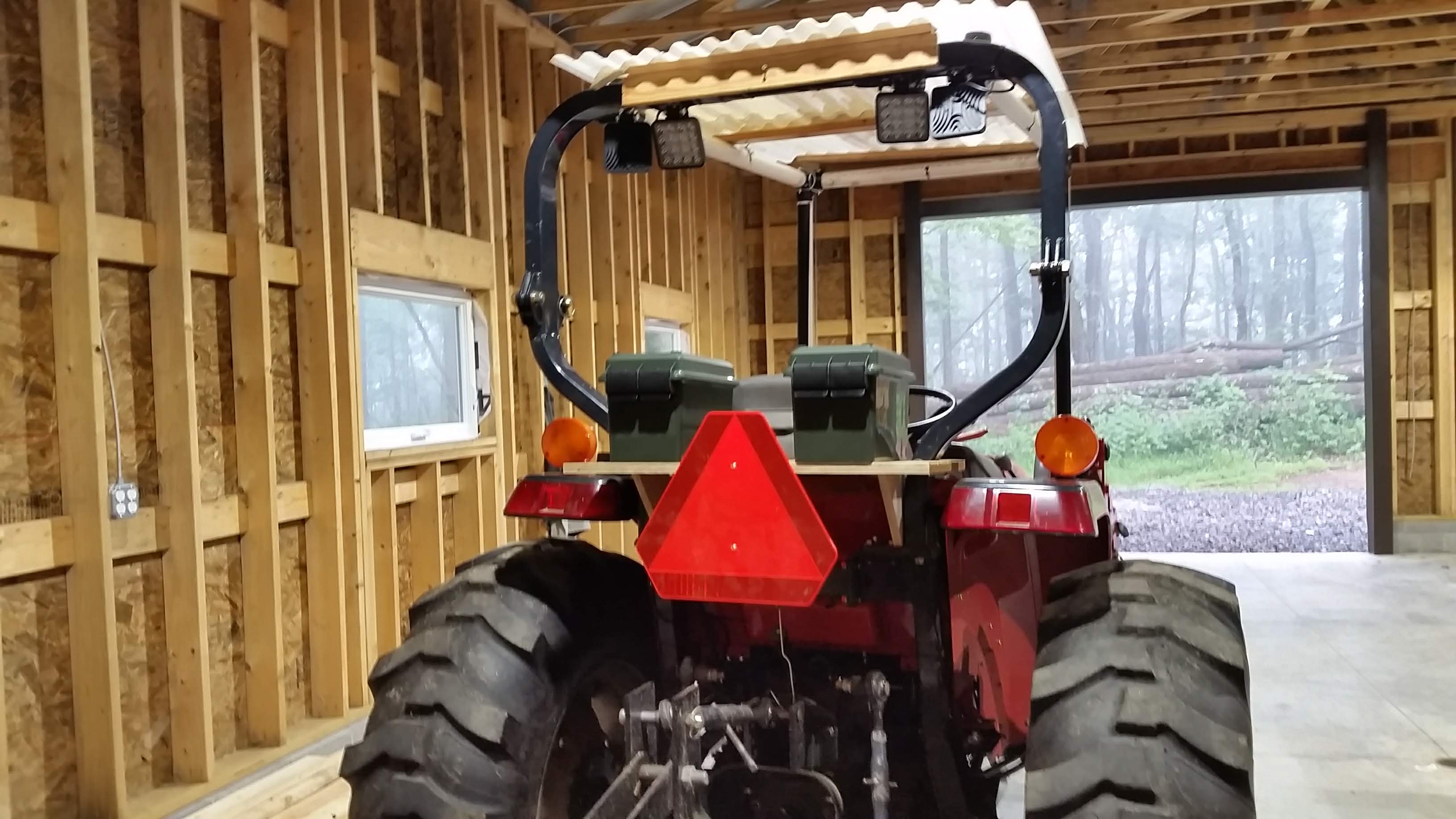

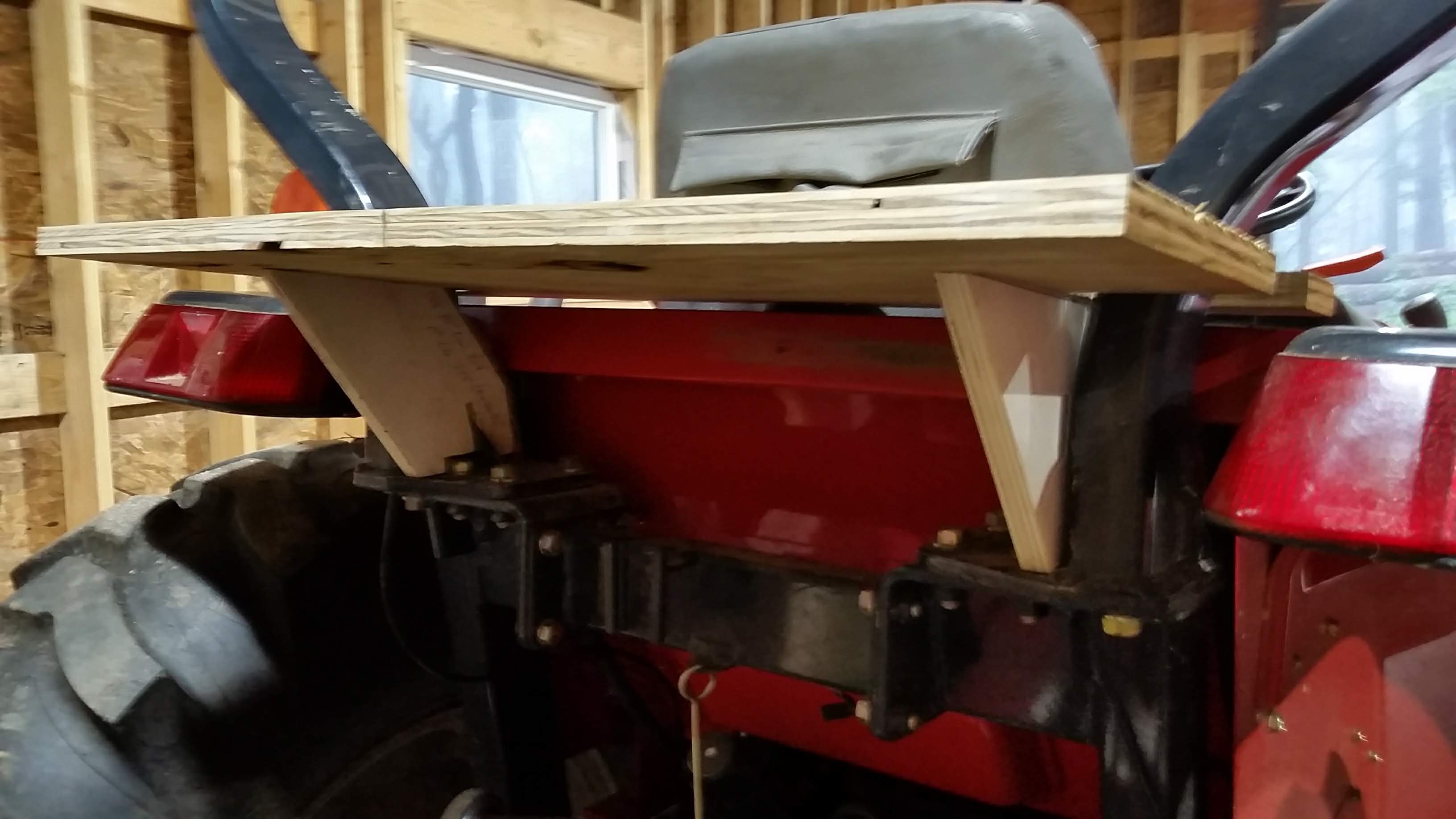

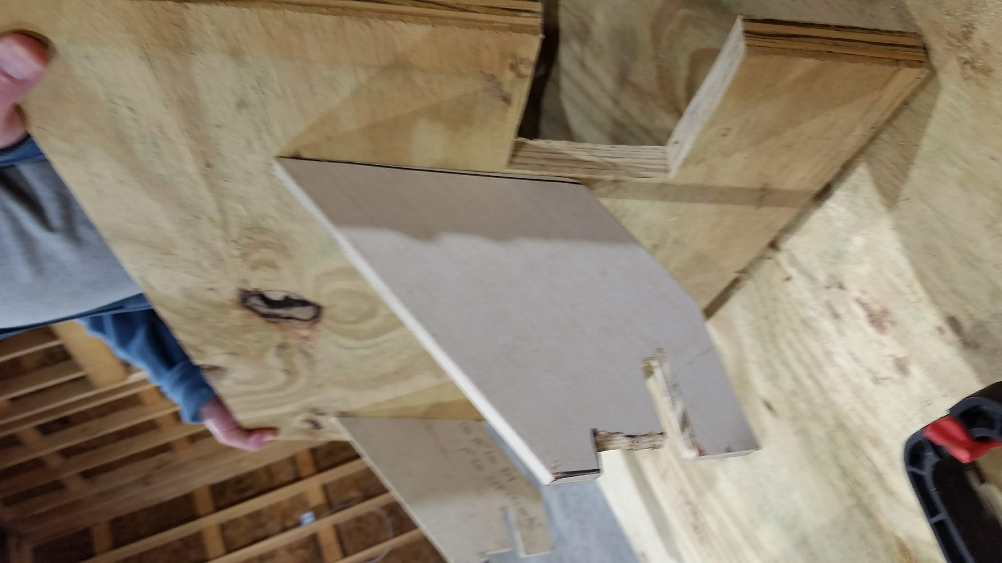

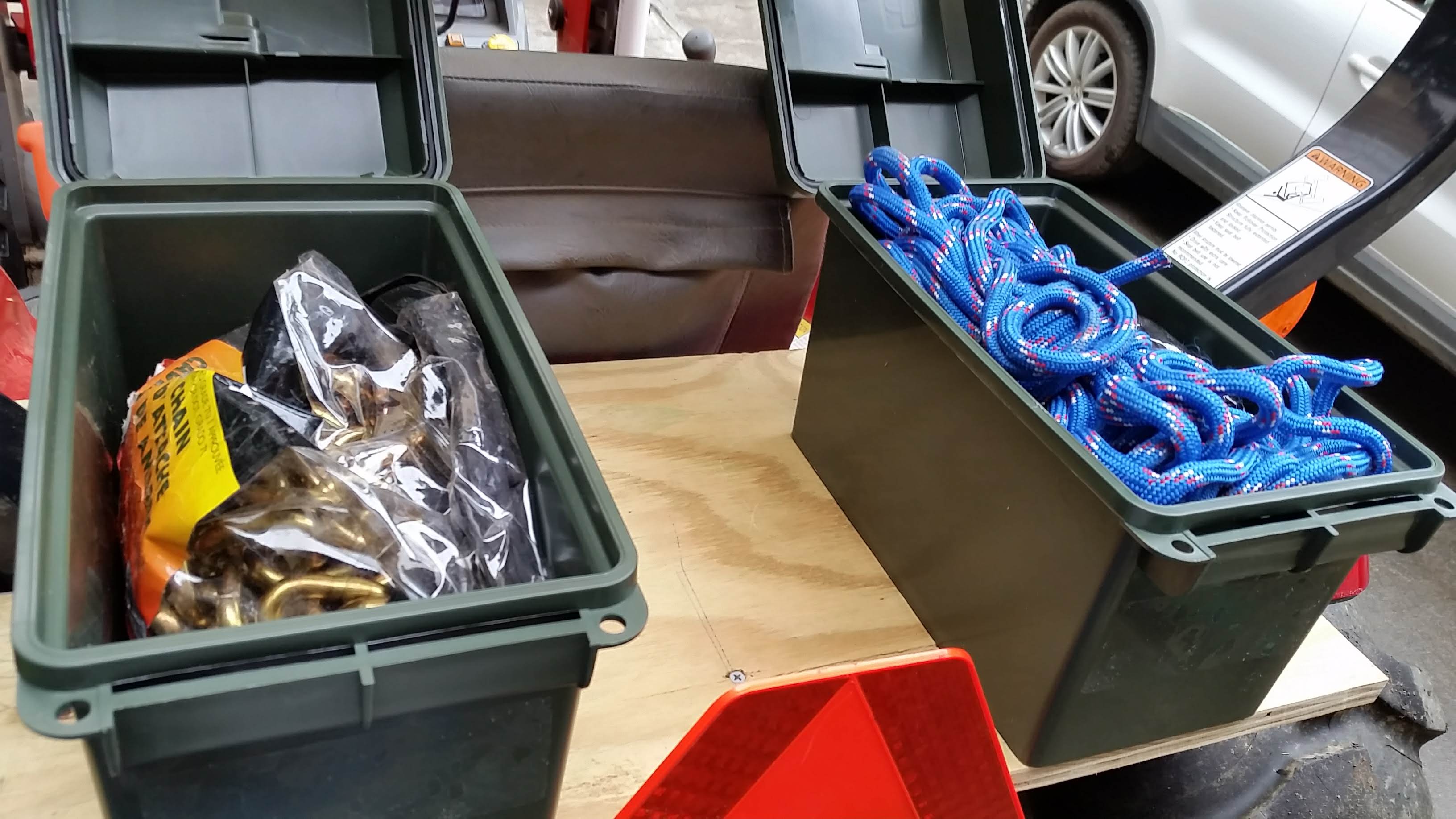

We didn't see this thread until after we came up with our solution for carrying our chains.
What we like about this idea, is that the containers are within the tractor foot print, the whole assembly can be lifted off the tractor should there be a need to do so, and we used the ROPS bar to hold everything in place without drilling or modifying it or any other part of the tractor.
We know a lot of you will say, "Why wood?" Because we have it! The tractor lives indoors when not in use. Maybe a second generation will be made from metal!
