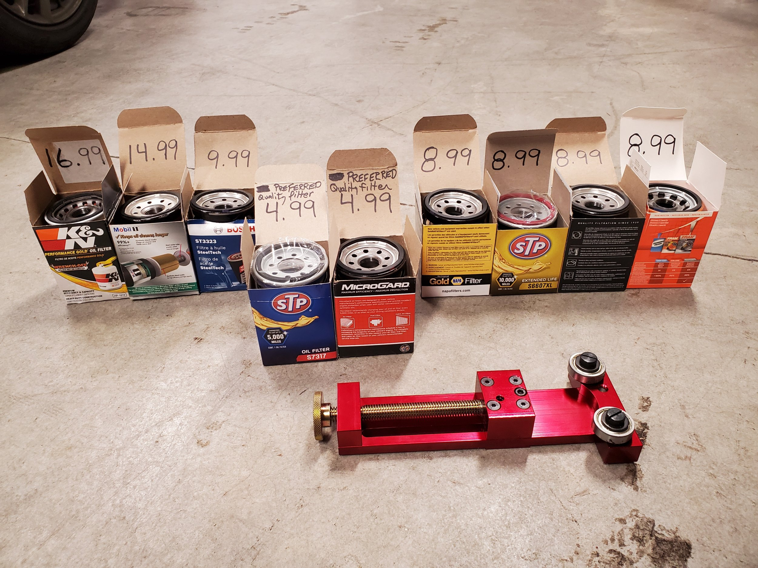

Test of 9 filters in Dec 2020 that fit a Honda CRV. I purchased 9 different filters from the local auto parts store and cut them open to see what was inside, build quality vs price, and what filters were being multi-branded. I am comparing ONLY the Fram to the filters I now prefer ( STP standard and Microgard ).
I can not speak to nor do I presume that each filter represents all other filters from same manufacturer for different vehicle models. I am limiting this review to filters that fit the 2016 Honda CRV
The price in Dec 2020 is the number on filter lid and ranges from $4.99 to $16.99.

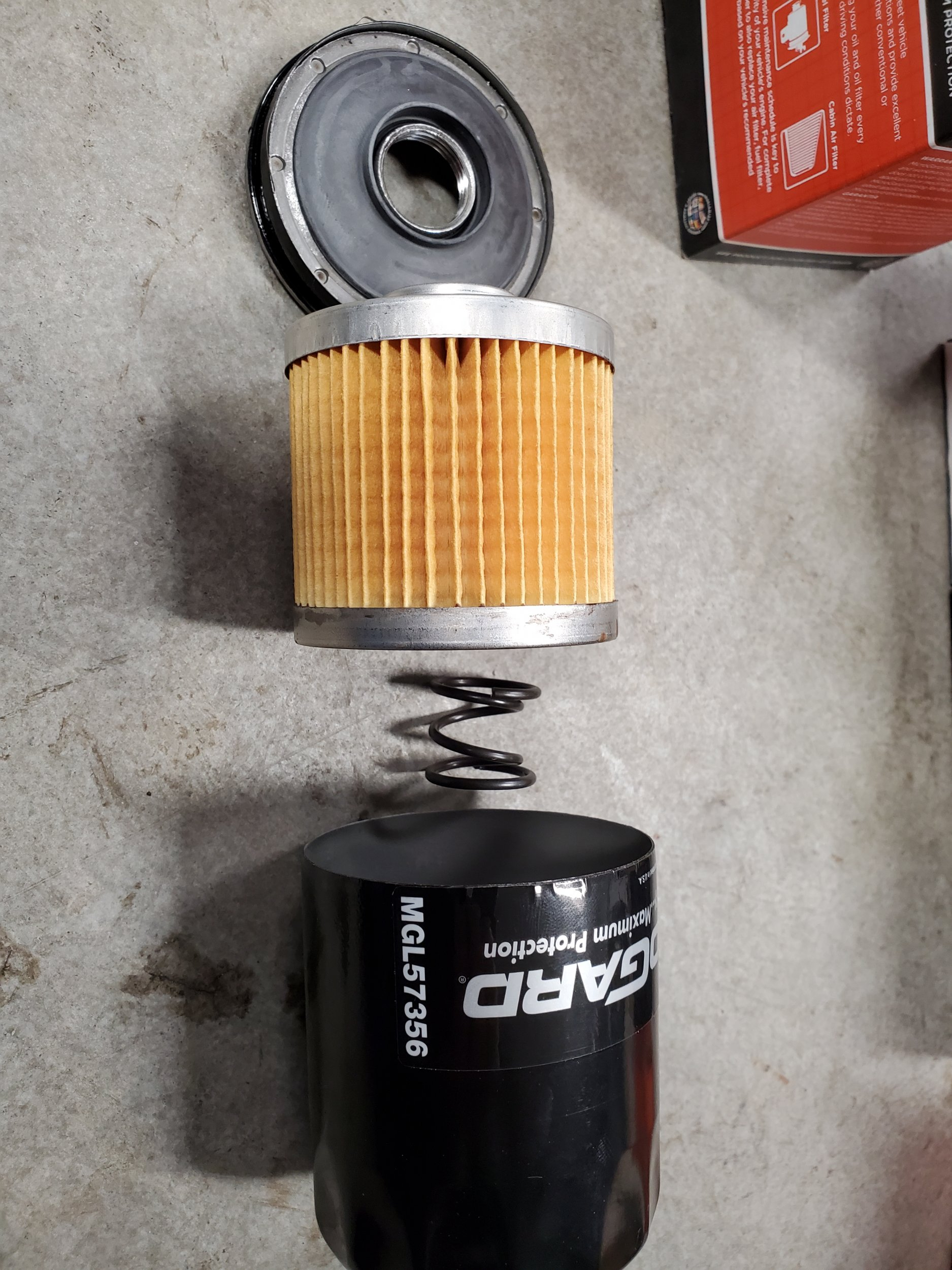

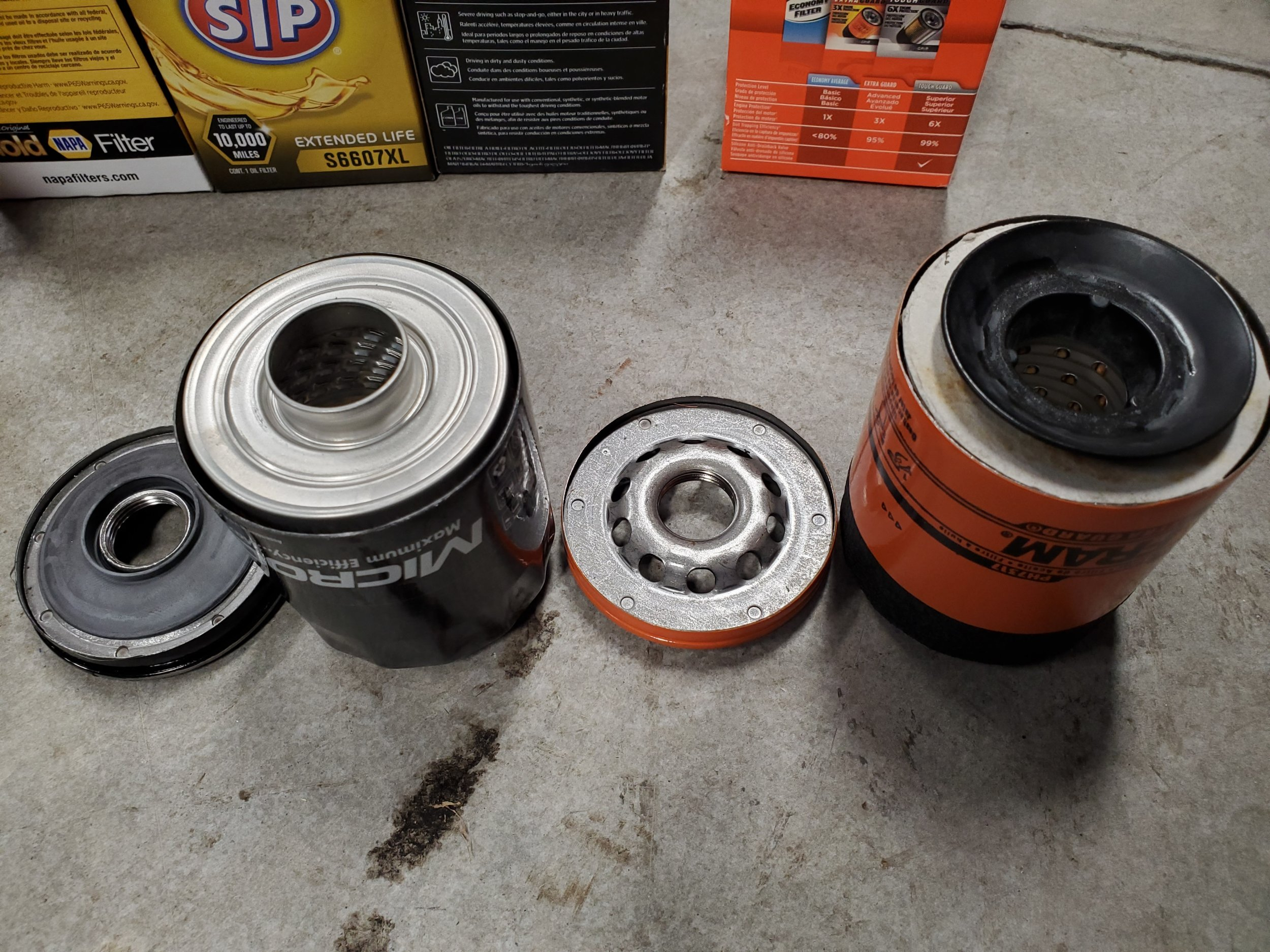

STP standard and Microgard must be made by same manufacturer as build components and assembly are identical.

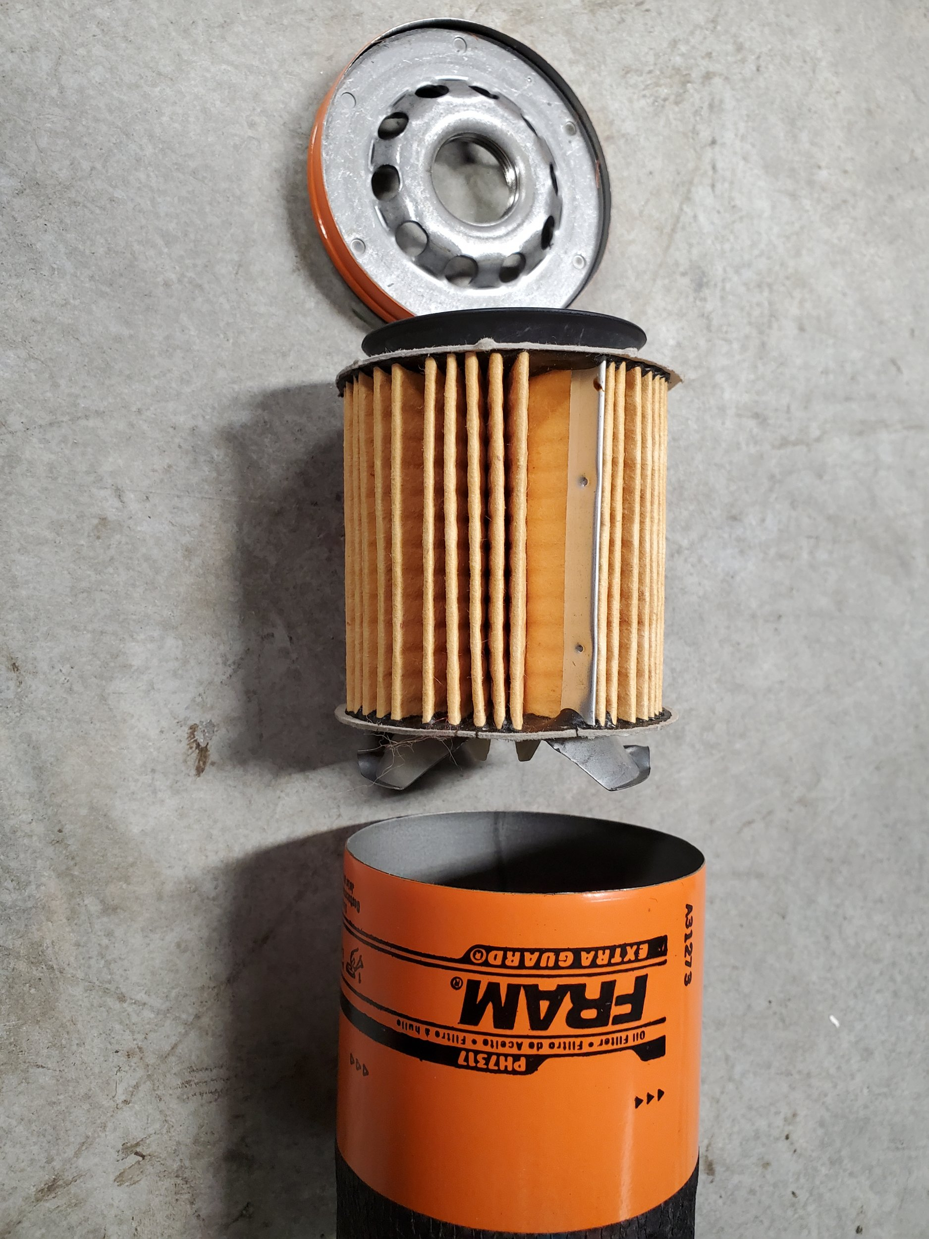

There are huge differences between the Microgard and Fram. The paper element in Microgard is captured between two metal caps whereas the Fram's paper element is between two heavy paper caps. I could easily see the Fram's paper caps leaking due to high pressure either due to cold thick oil on startup or paper getting soft due to oil saturation. Fram does not support the paper end caps in any way.
The oil inlet on the Microgard fits into and past the rubber gasket and is held in place by substantial spring at the filter's opposite end whereas the Fram uses a relatively weak spring meant to press the rubber gasket against the threaded end cap.
Microgard cost is $4.99 vs Fram's $8.99 cost.
Food for thought.
Food for thought.
Wow, the Fram you pulled apart is much different construction from the one I pulled off the shelf in Advance. Mine looked more like the Microgard you show. Yours has the paper end caps like the trash filters of old sold by Fram.
I had to go out and check what I ended up buying just now to see if it was from a different product line. Turns out it is, and I got the "Fram Drive" FD9688 filter. I don't know what they're originally designed for because I went off a chart that gave thread size and gasket diameter, and that was literally the only one that matched up from a couple different stores. Unfortunately I didn't take a pic of the internals but until I do my 30 hour oil change this spring I guess you'll have to take my word for it. Annoying that you can't count on a major American brand to make consistent quality products. Also, do they understand that they're killing the brand by doing it that way?
Something of note, I did buy mine in November of 2021, so who knows, maybe this quality improvement is recent. I'm guessing more likely that what I bought is considered a premium product line from them. Regardless, I retract what I said above. Can't vouch for them if they're still running the paper end caps on some models. Sorry if I misled anyone.
