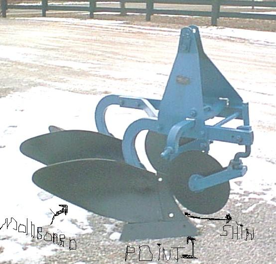

If it is a 2 piece setup dearborn, wear parts are impossible to fine. A 3 piece has parts availability. Ken Sweet

Here is a picture of a 3 piece setup. Ken Sweet

Thats just like the one i destroyed. Still would not recommend that when you can find one with trip protection for a similar price
