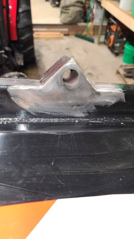

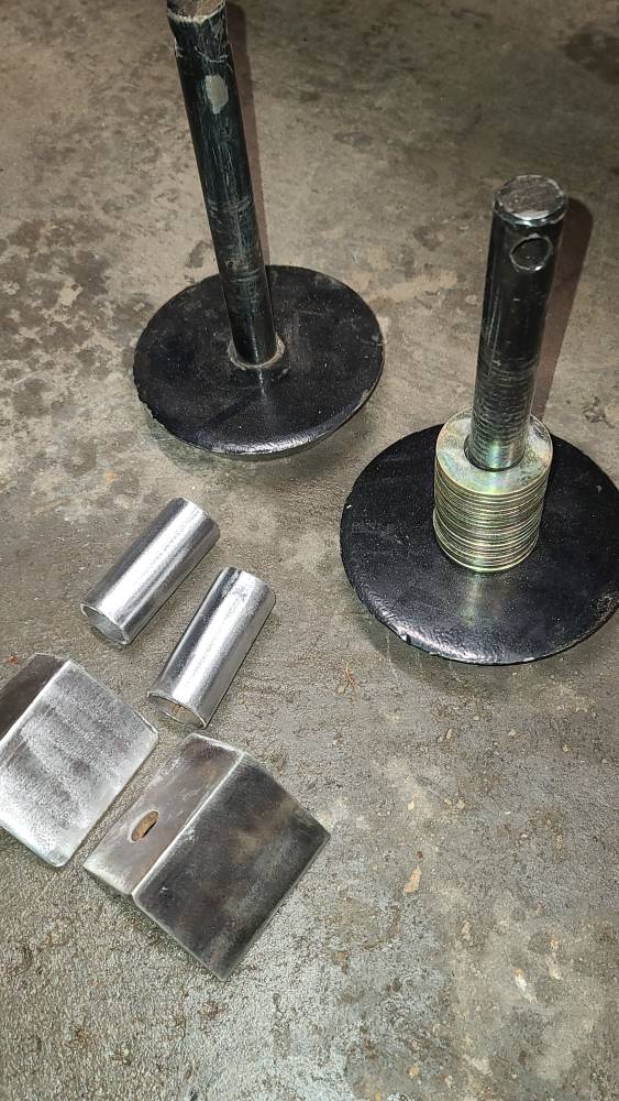

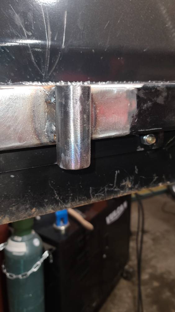

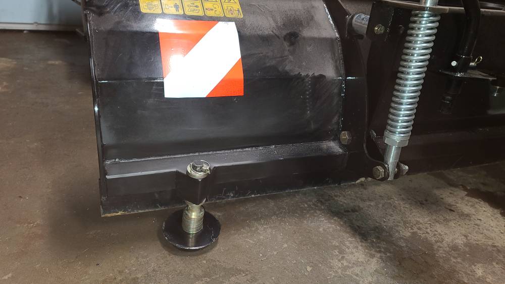

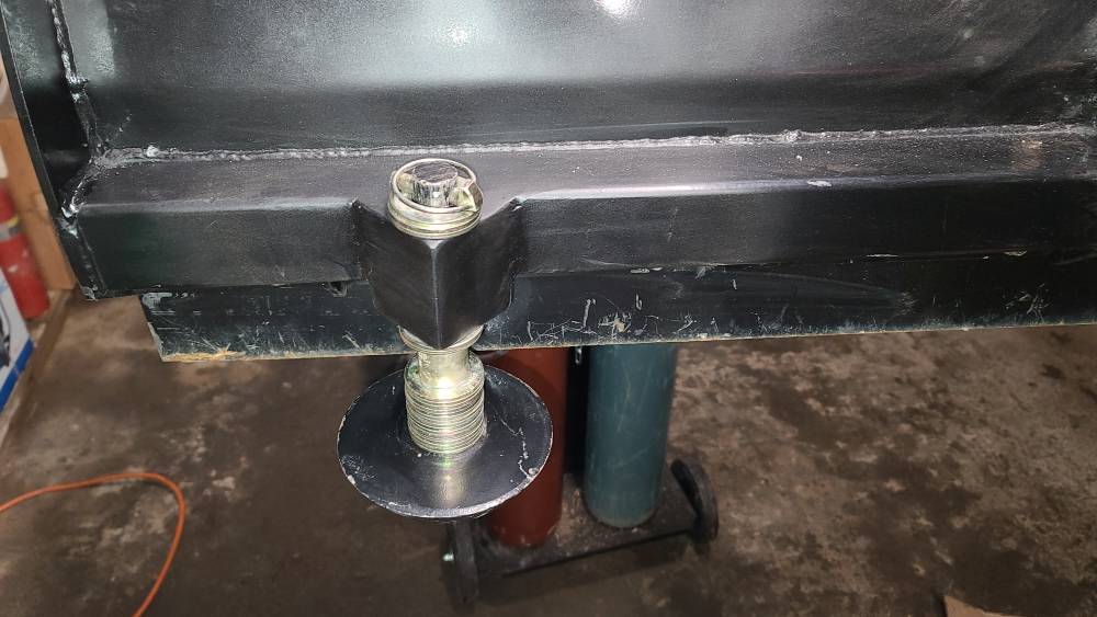

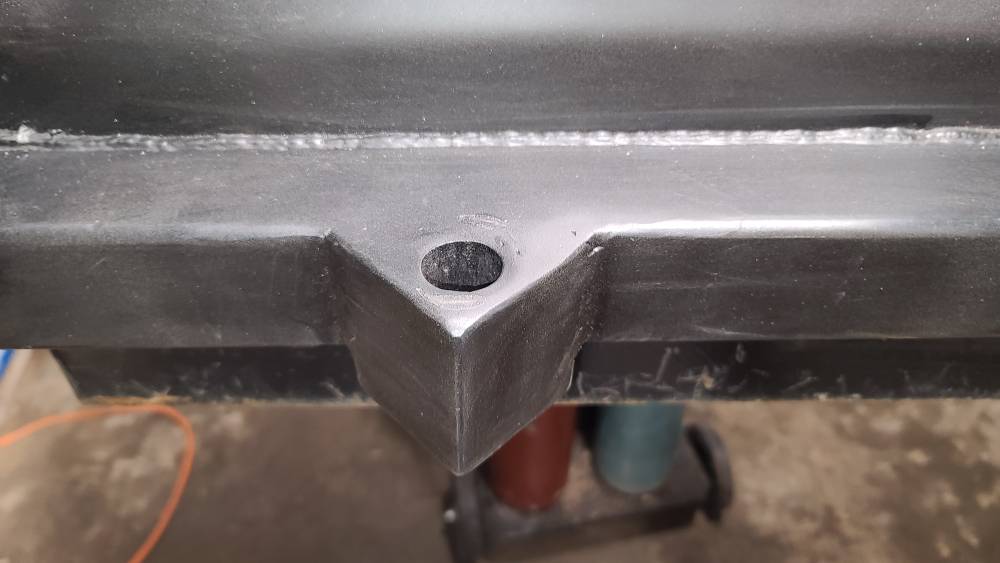

I have the same exact plow that you do.
That being said, I have run snow plows most of my life, Boss, Meyers, etc on pickups and commercial vehicles and I will tell you that this quick attach plow setup on the front of a loader on a tractor like this did take a little bit of getting used to, but after a week or two in various conditions have got it down and am very happy with it. On my Homestead I have a lot of loose Rock and dirt and also 5 miles down an uneven mountain road that we have to plow. One of the problems that I resolved was the fact that it did not have feet. So I was able to buy a replacement feet kit with washers spacers and everything for $53 on Amazon and I fabricated brackets for it until we got a good layer of compacted snow to fill in all of the uneven surfaces and rocks sticking up then I was able to take it off and use that blade on its own.
And now it works amazingly well. 20201218_002145.jpg20201218_004017.jpg20201218_013459.jpg20201218_022910.jpg20201218_023021.jpg20201218_023759.jpg
