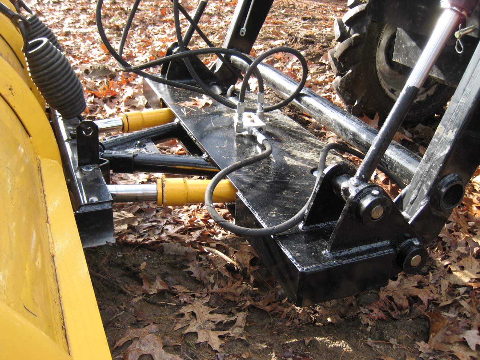

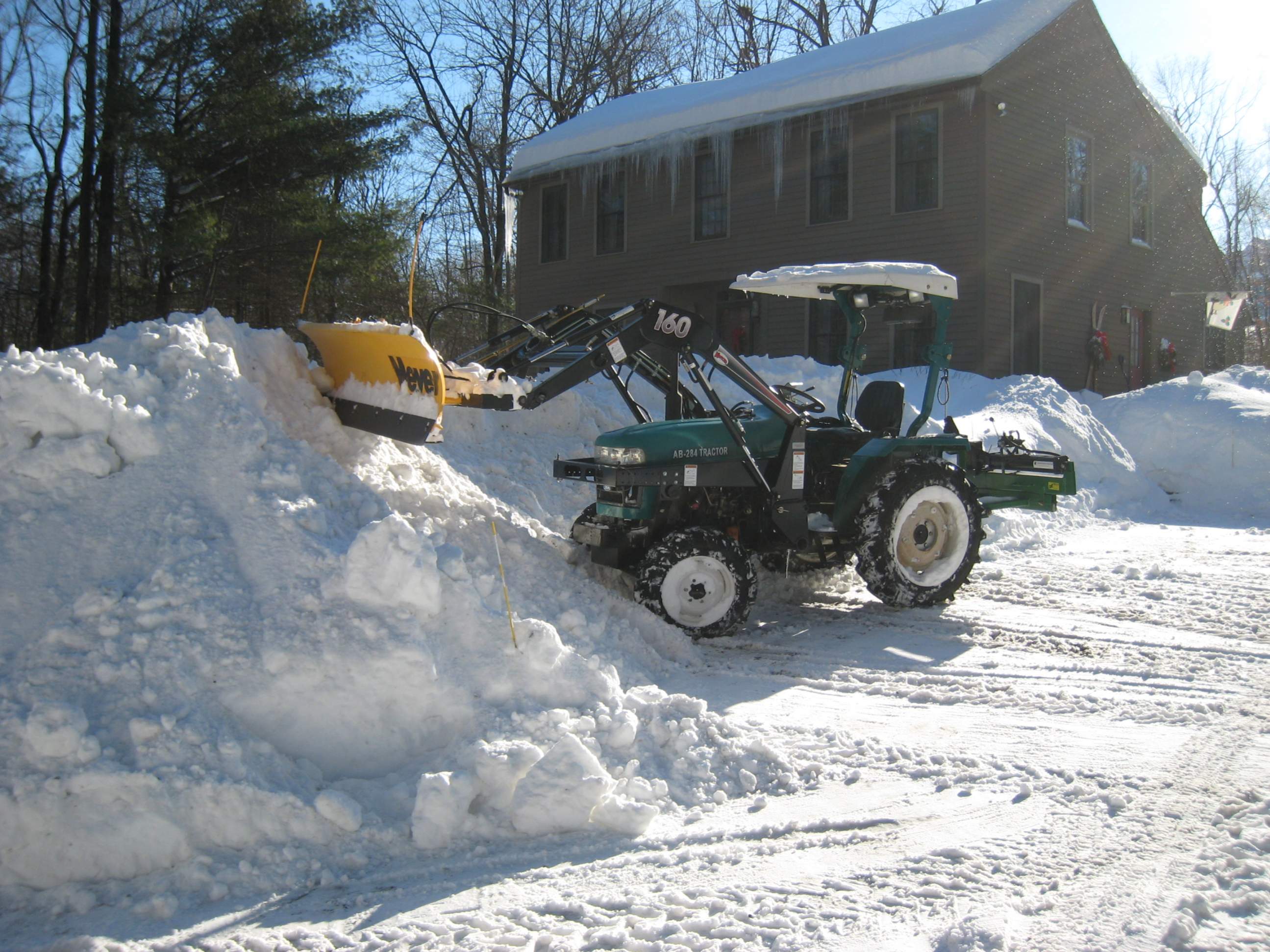

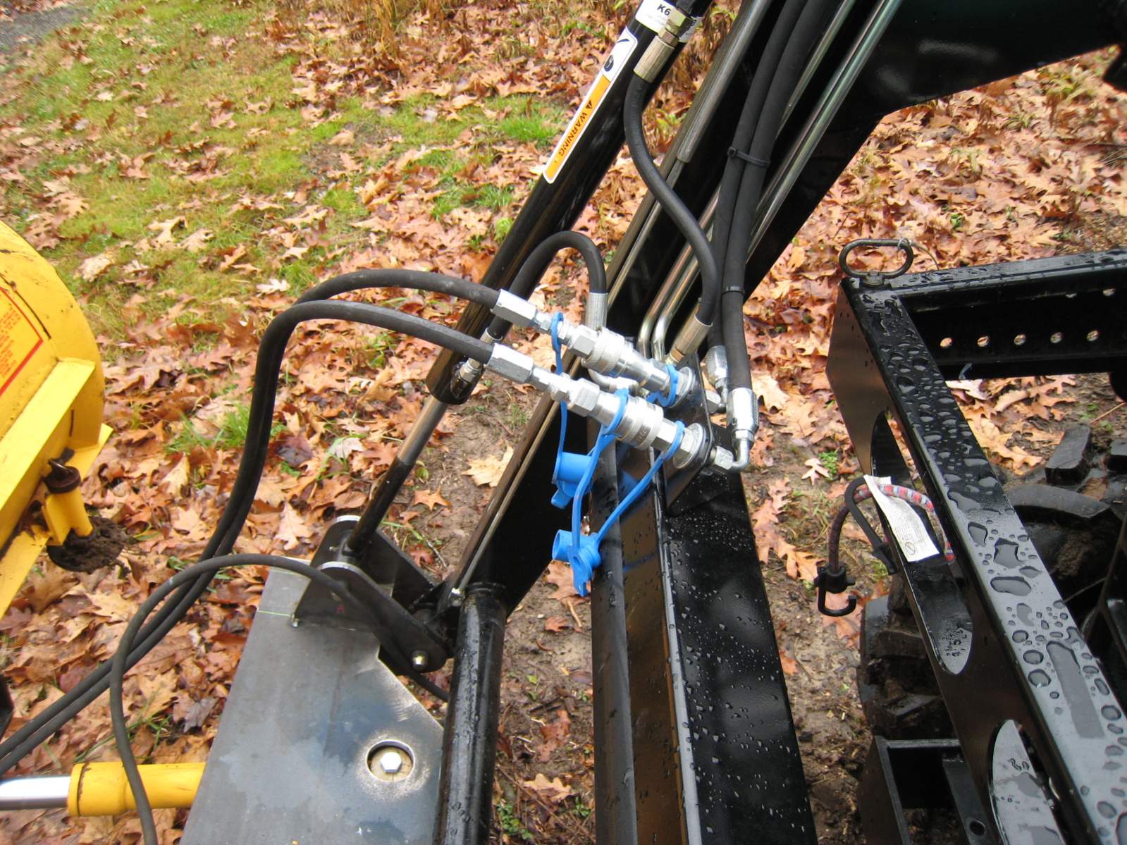

I used a roadworthy Nissan Pathfinder SUV with Meyer plow for years. When the Pathfinder became unroadworthy I used it for several more years for only plowing my 400 ft gravel drive. Since the vehicle was rarely driven I started it periodically but it was a never ending process of mice in the heater, mice eating wires, the damp smell, rusting rotors, rust, rusted 4WD/Low Range floor levers, etc.
I bought a low cost tractor and grafted the Meyer onto the loader. First the plow mount was made in plywood and then brought to a weldshop for fab work and tacking. After one final fit, it was welded and painted. By adding two remotes in front plus a valve, I could angle the plow.
Since I use the tractor all year round this system works much better for me. I couldn't split wood or dig stumps with the Pathfinder :)

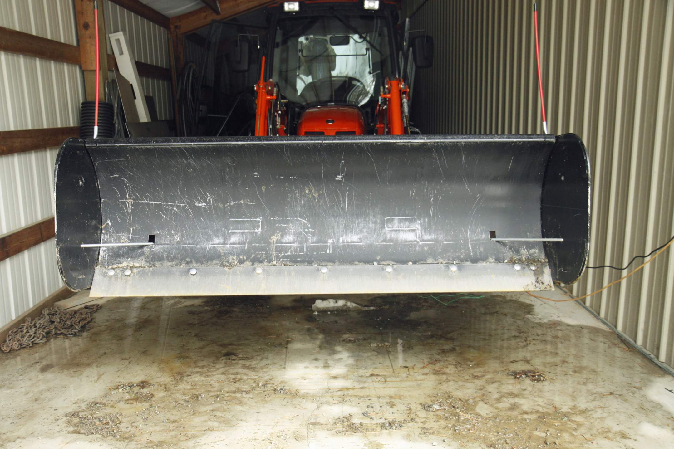

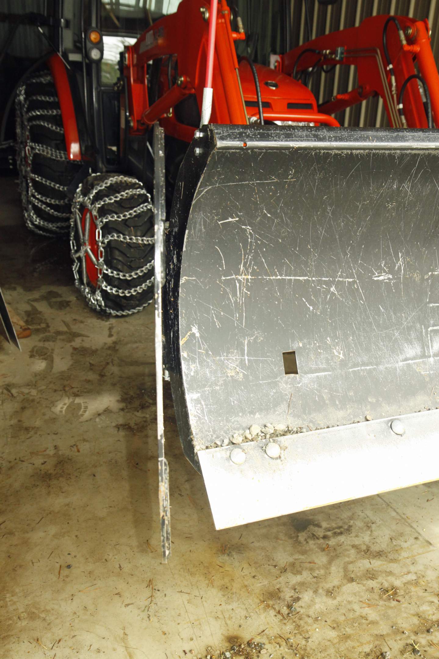

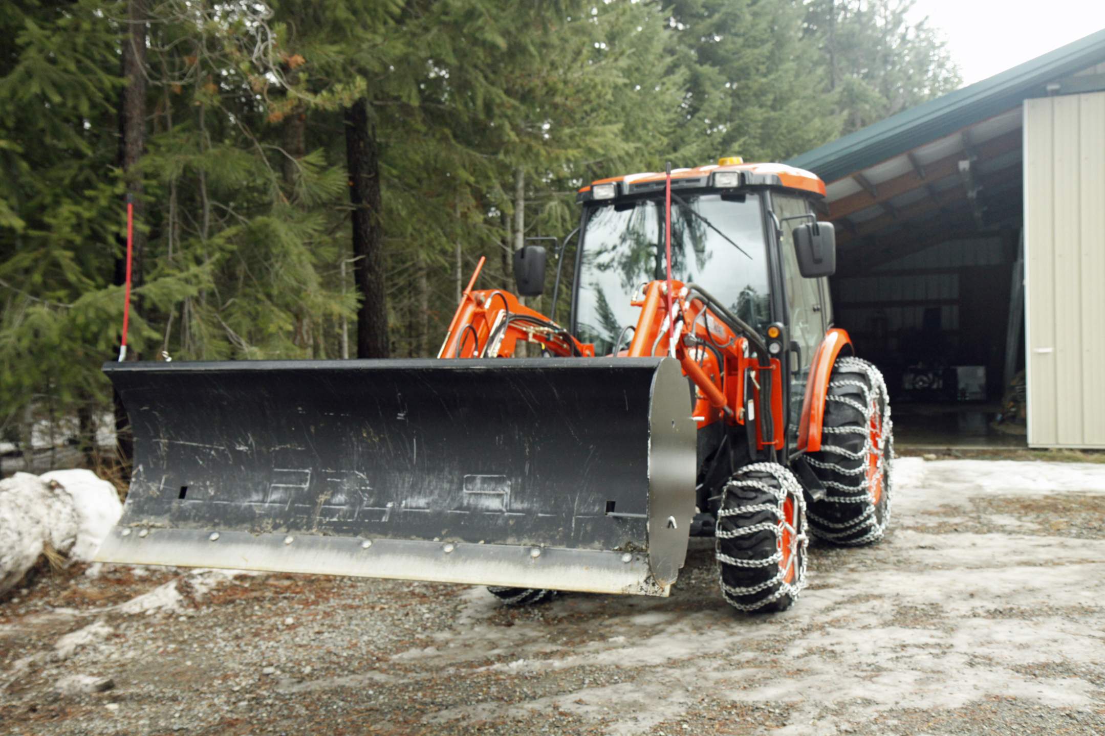

I finally got to use my Quick Attach loader mounted snow blade to move 9-10" snowfall today. With all 4 tires chained with 2link ladder chains i found the following.
1. The initial 2 passes to handle both sides of the center of the road i was able to operate my 84" snowblade with my DK45HST tractor in high range with maximum angle deflection IN FULL float mode and it worked fantastic. Moved alot of snow at a good fast clip. The tractor DID NOT get pushed around at all like it did without the chains.
2. The last 2 passes on the outside section of the roads was done in mid range as the snow was now very deep. It worked great also. Never bogged down the tractor and the finished product was about 22-24' wide clear road.
3. The side gate option to the blade was way worth the cost. Kept any blowback off of the road
4. The hardened shows worked OK, but the road isn't frozen yet, so they tended to dig in too much.
Overall i was impressed. Was a little leery of how much snow a 45HP tractor could push. The answer was alot :):thumbsup:
   / Plow on truck or buy a tractor #36
What brand QA blade did you buy?
Also - what's a side gate option or at least how does it function?
   / Plow on truck or buy a tractor #37

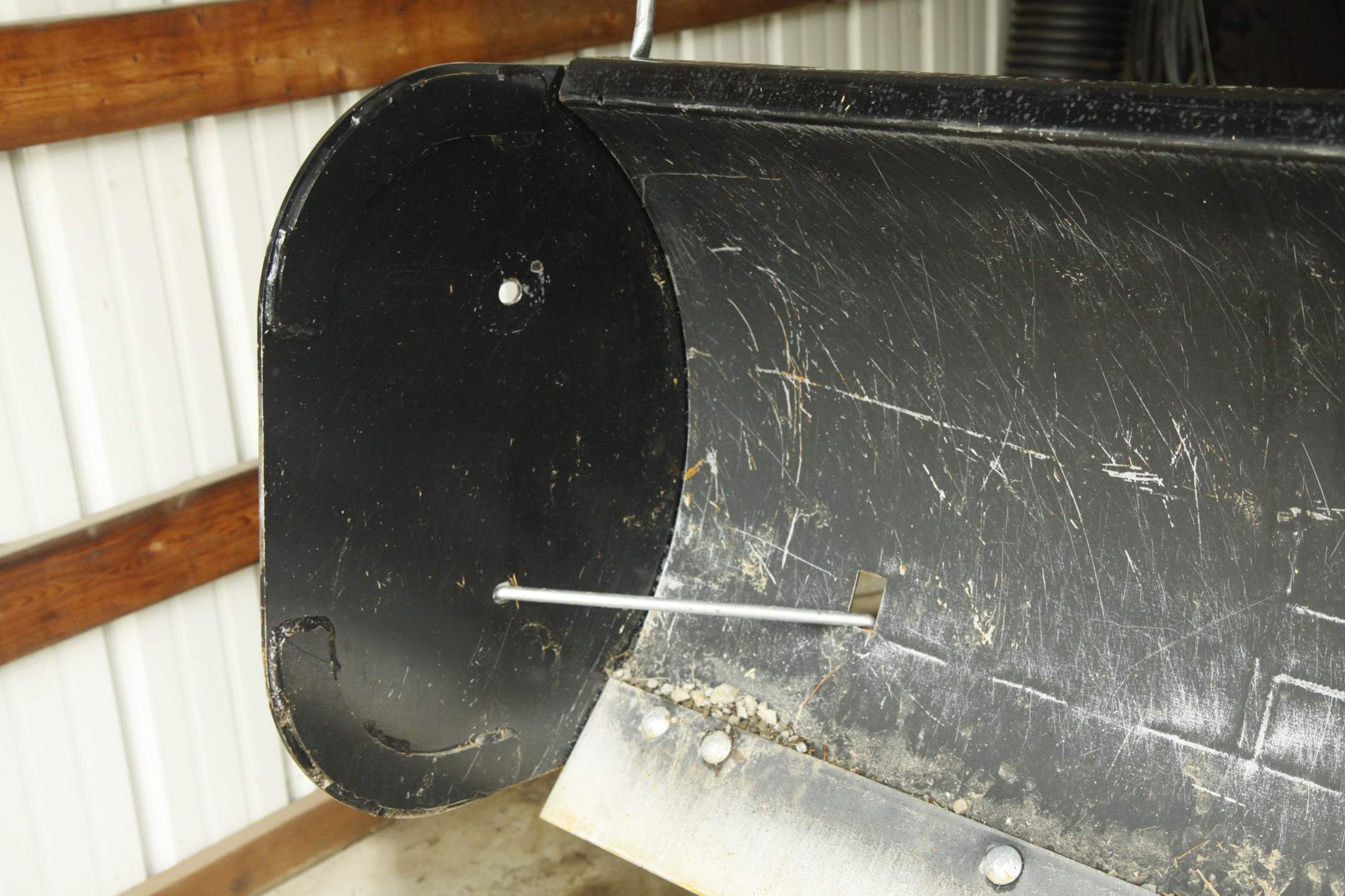

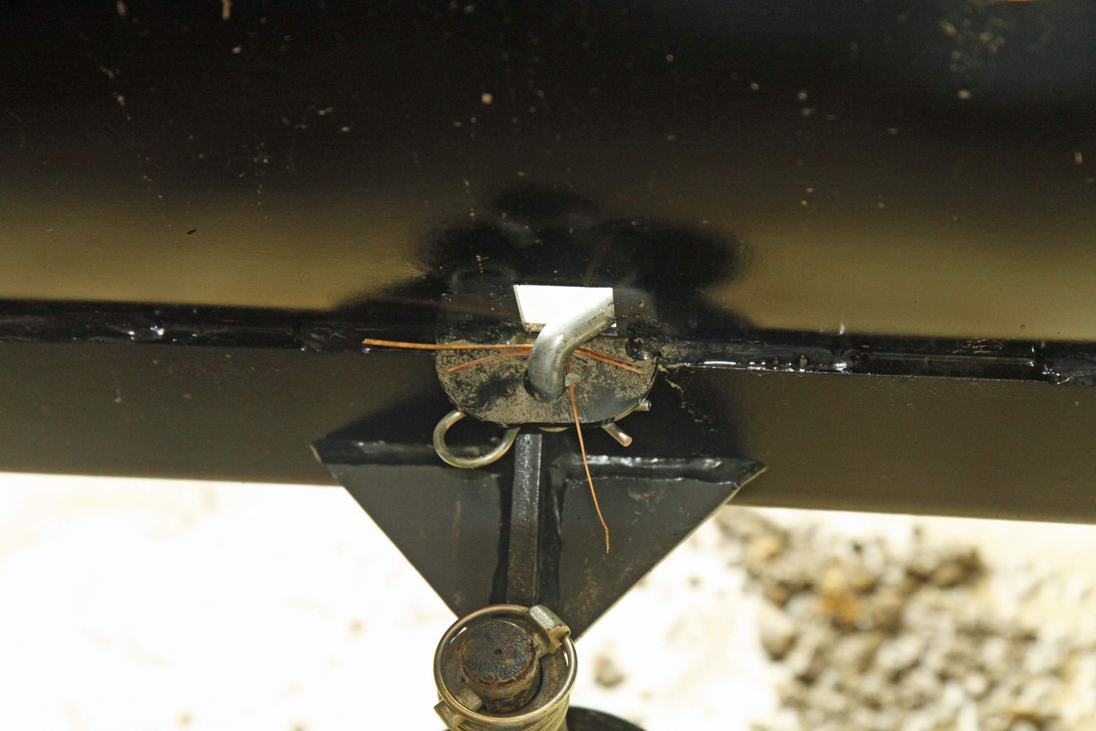

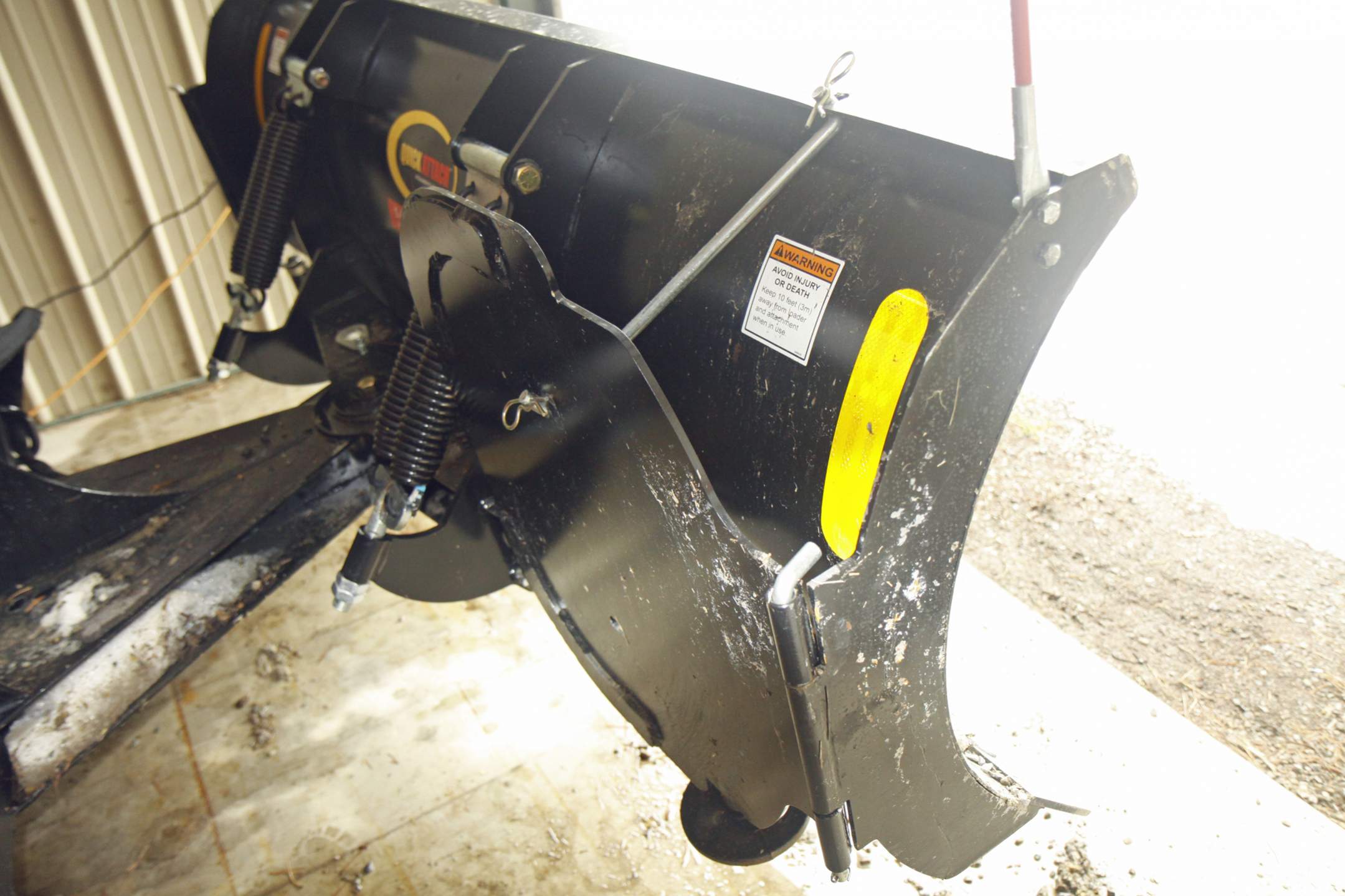

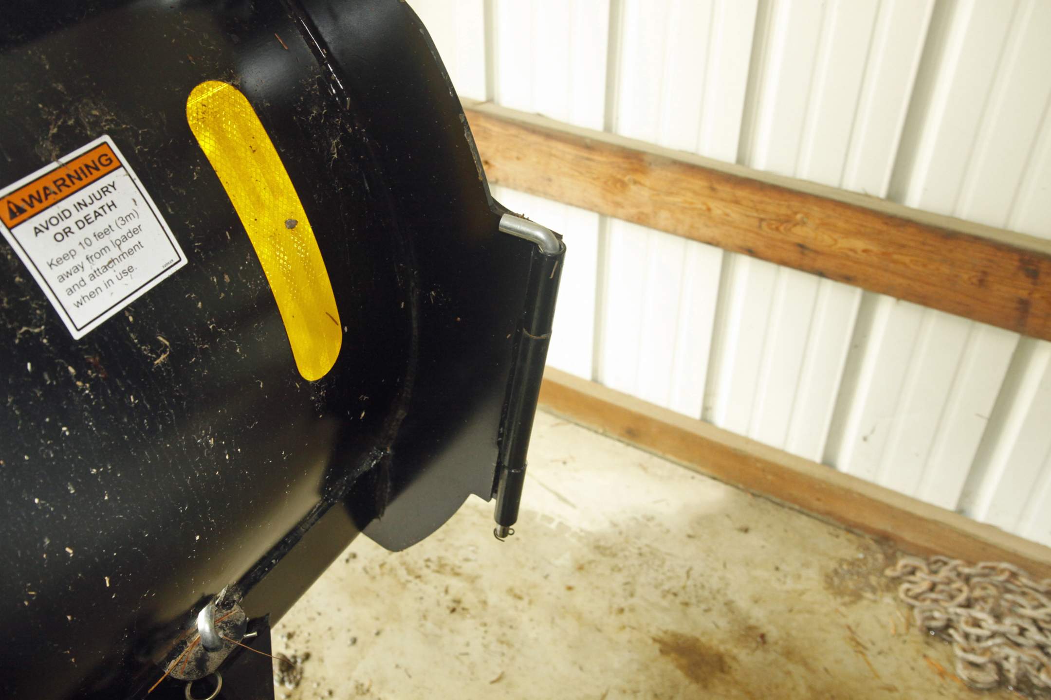

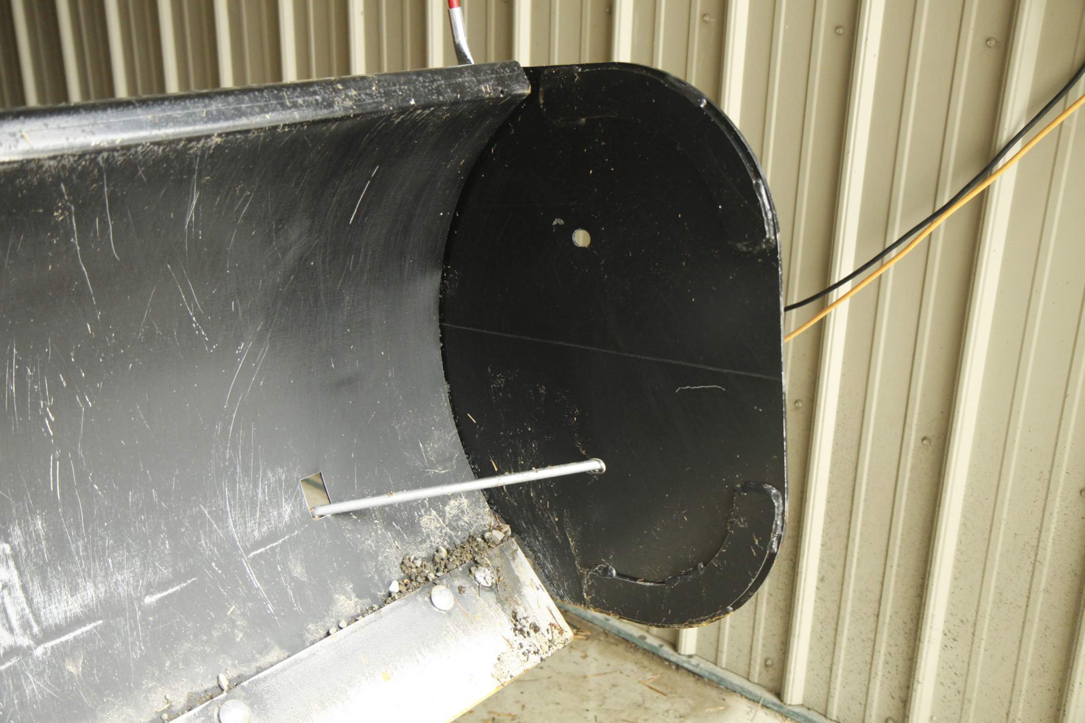

I purchased the "Quick Attach" quick push style brand snow blade
Snow and Light Material Blade : Quick Attach Attachments, Inc.
the side gates simply are hinged on the blade and swing into place and lock down to allow for conversion from snow blade to a snow pusher...or for controlling snow from escaping out one side while you plow.
When im plowing the street, i can prevent snow from wrapping around the high side of the blade and leaving a trail on the road. It truly works slick
Here are some pic's a took that someone else wanted to see.
the first is with both gates closed . then a few pics of the gates closeup.
The 4th is the hinging area. the gates stay with the plow.
their latched in place. You simply rotate it open and pin in place when not used.
