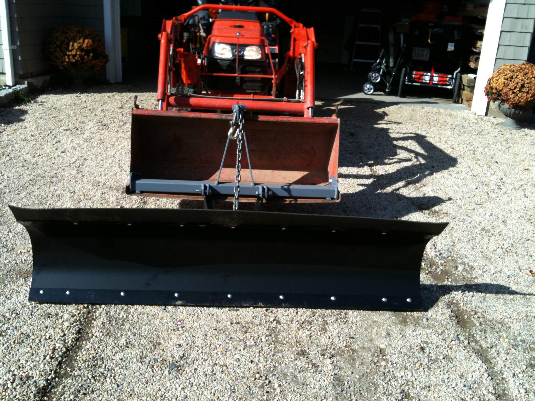

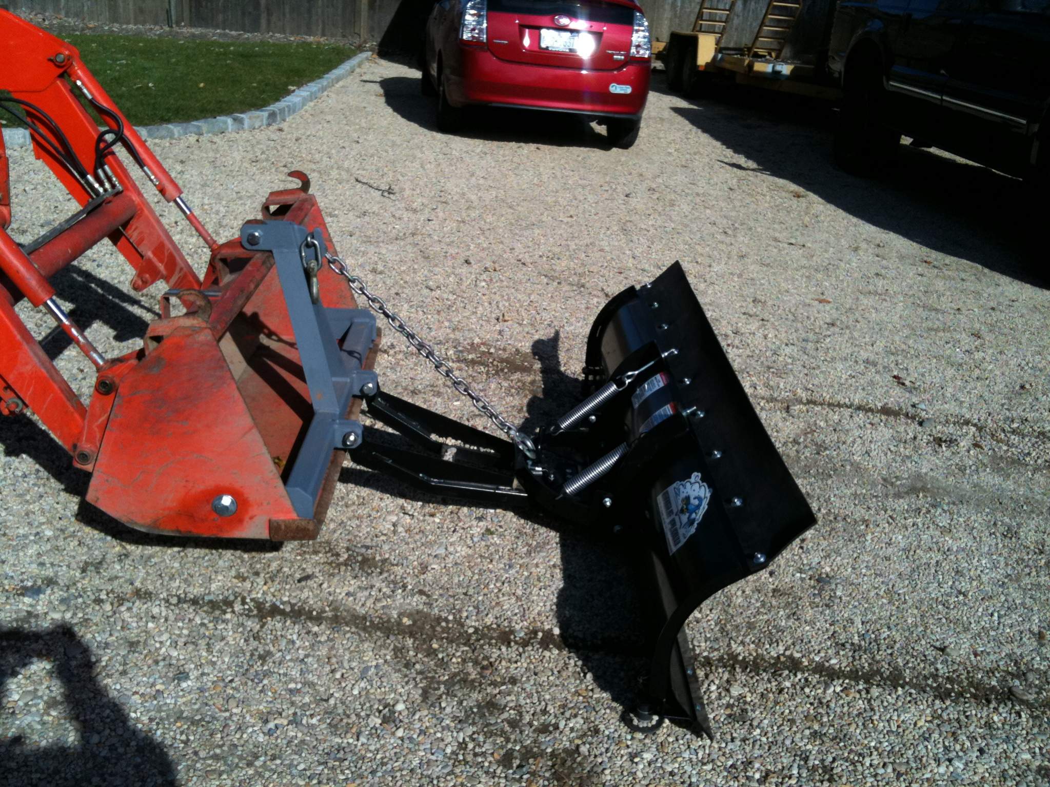

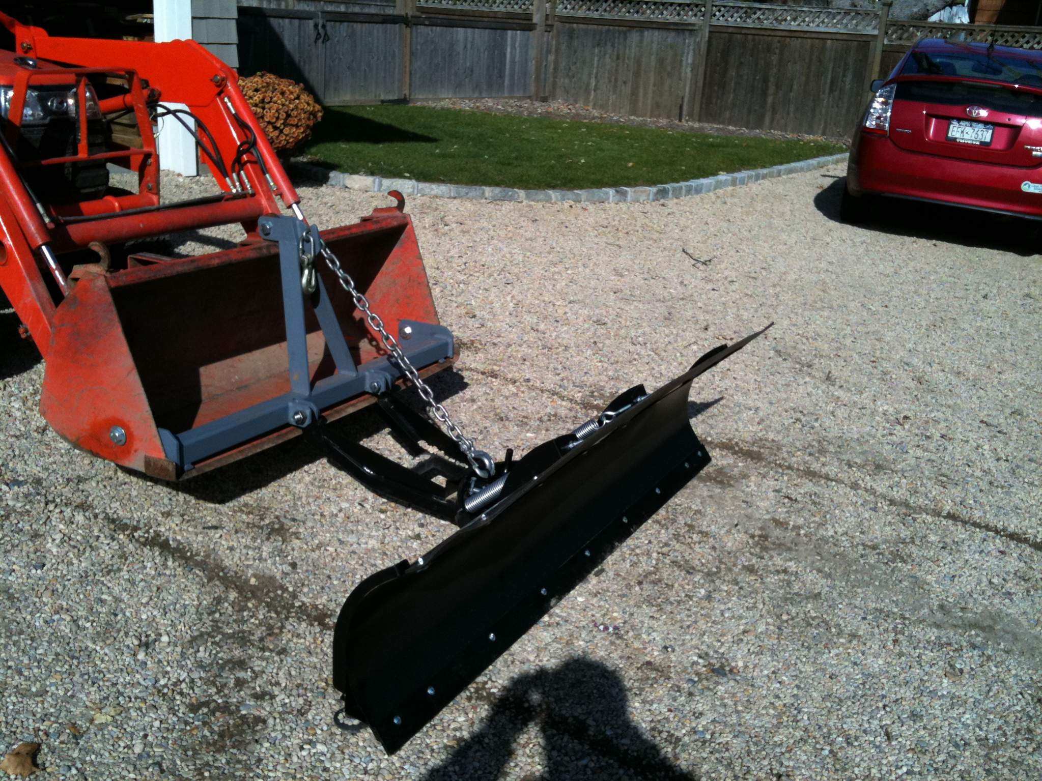

Finally got my Kubota setup for plowing this winter. I purchased a 72" manual angle UTV plow setup and welded up a custom hookup for my bucket. I already had holes in the sides of my bucket for the teeth so I was able to use the same holes as attachment points. I also already had the hooks on the top of the bucket for my forks. Seems like it will work pretty well in my dry testing in the driveway.

Excellent looking work you did on that adaptor.
Maybe make it to mate with your 3pt for more versatility.
