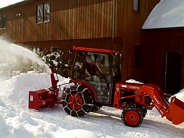

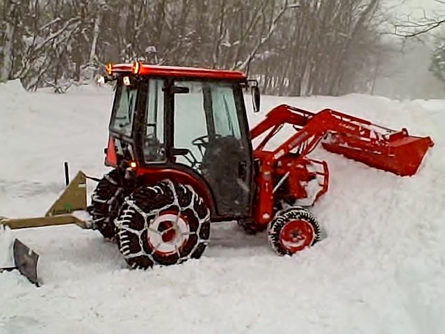

I think that if you don't get a lot of snow, a rear blade would work fine. In addition, if you are plowing paths over lawns or gravel, you can reverse the blade and not do much damage. I used a rear blade for years, then one year we got so much snow, I had no place to put the snow. I now also have a rear-mounted blower for the big stuff. However, if I had to choose between a front blade or a rear blade, I would pick the front blade.
