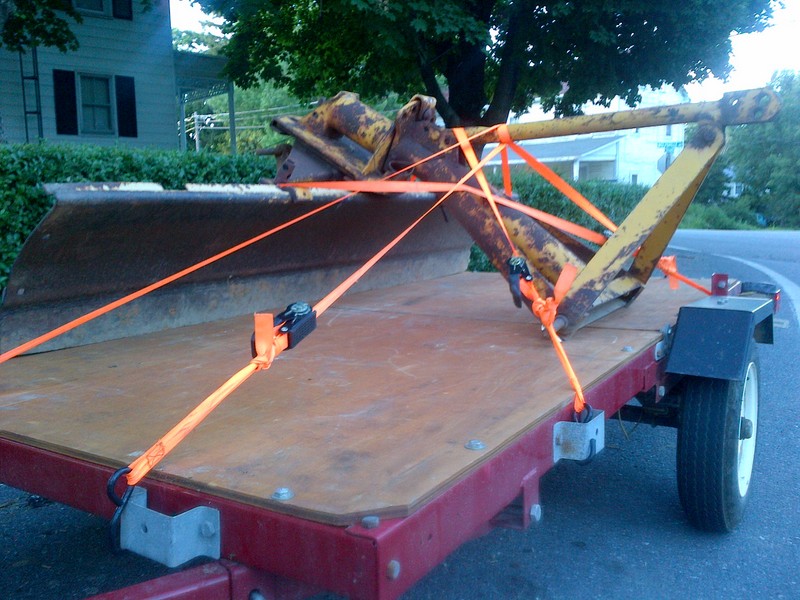

I picked up a 3-way 7foot Ford tractor blade today.
Something like this.., only 7 ft. will post pic tomorrow.
It's a little rusty, but all surface rust. Doubt that blade will ever need replacement, especially once I recondition it to Kubota colors. "They don't make them like this anymore"

Nice looking blade - I see it offsets, which will come in handy for your driveway work.

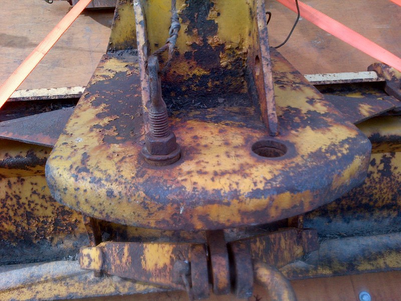

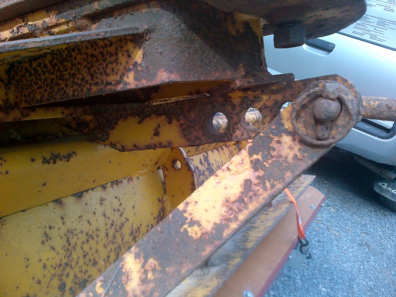

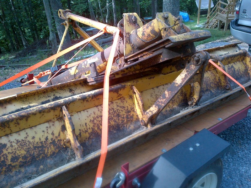

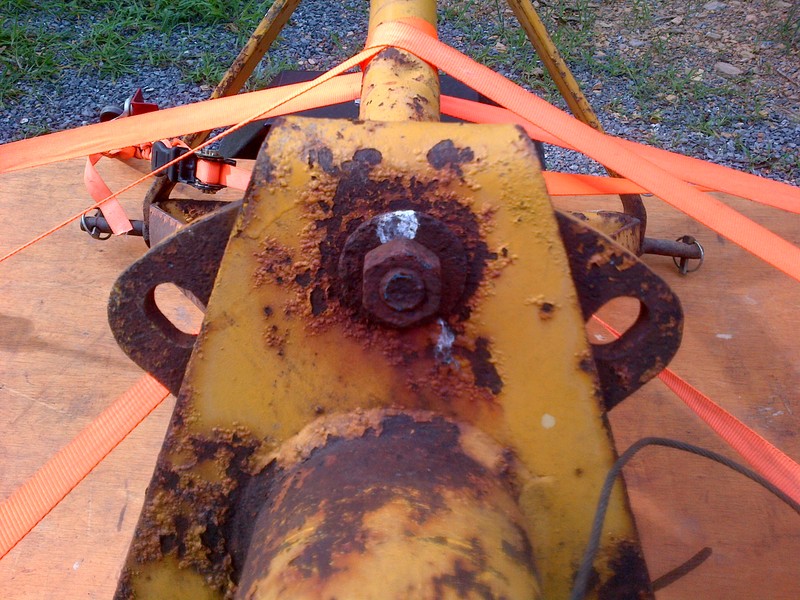

Some pics
Not sure the "offset" was ever used. In fact I struggle to understand how it works, the bolt inside is rather short, and probably would have to be sawed off.

It looks like the blade offsets in increments equal to the distance between the ribs on the blade. Notice the holes in the bottom of those ribs? I believe they are where you would reattach the lower ends of the stays that control the attack angle of the cutting edge. Looks like it would be a pain to change on a frequent basis, but could still be useful if you need the blade offset to one side for a long time.
