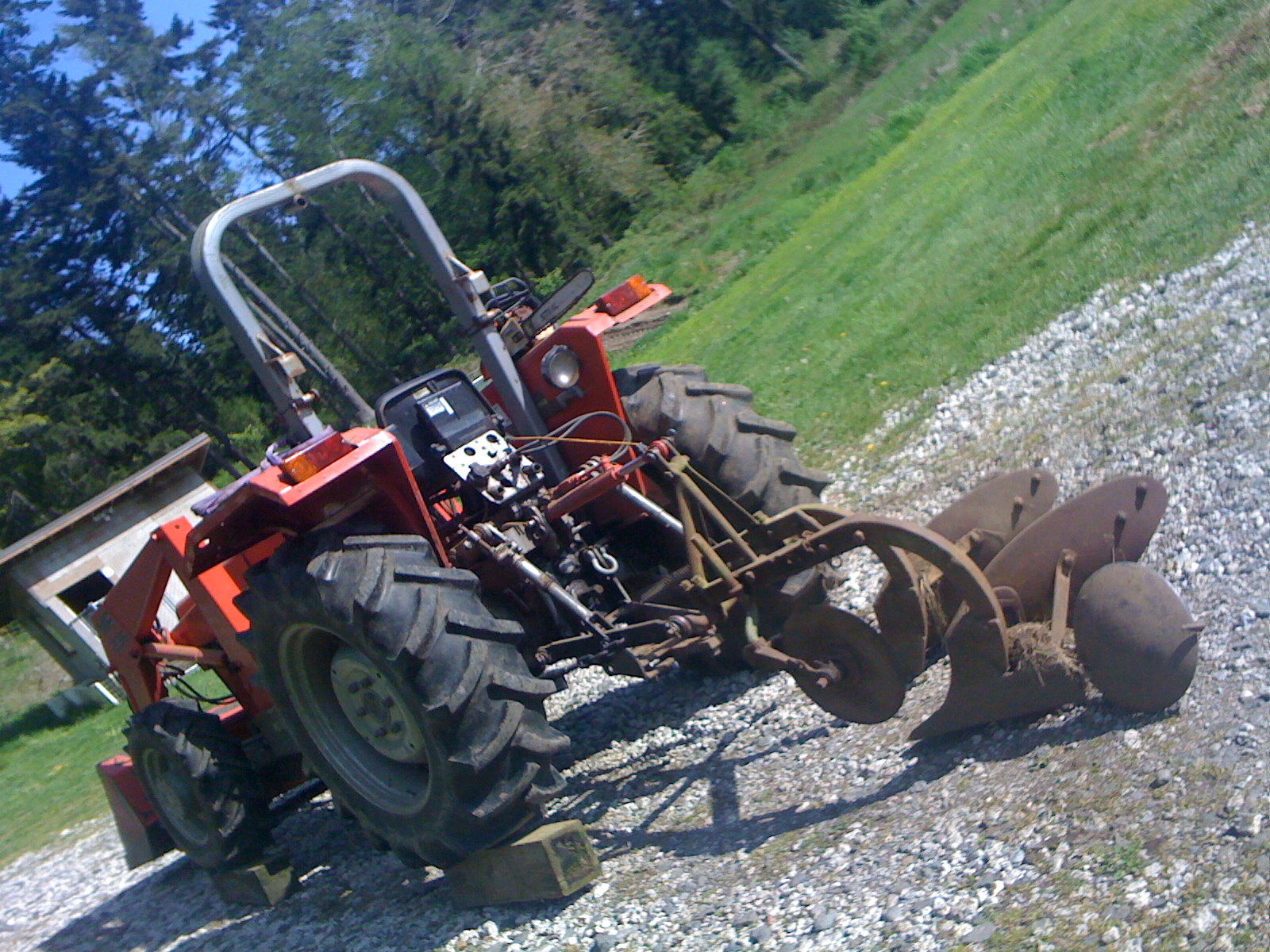

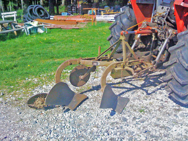

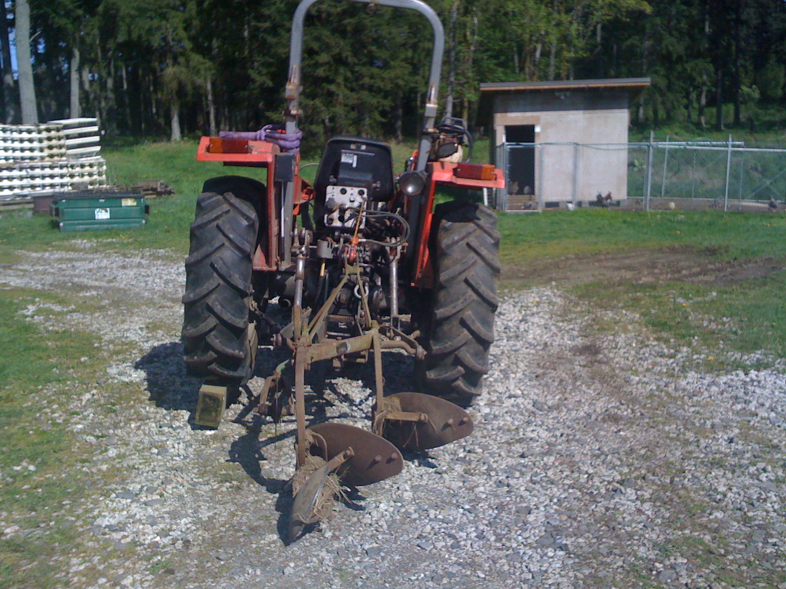

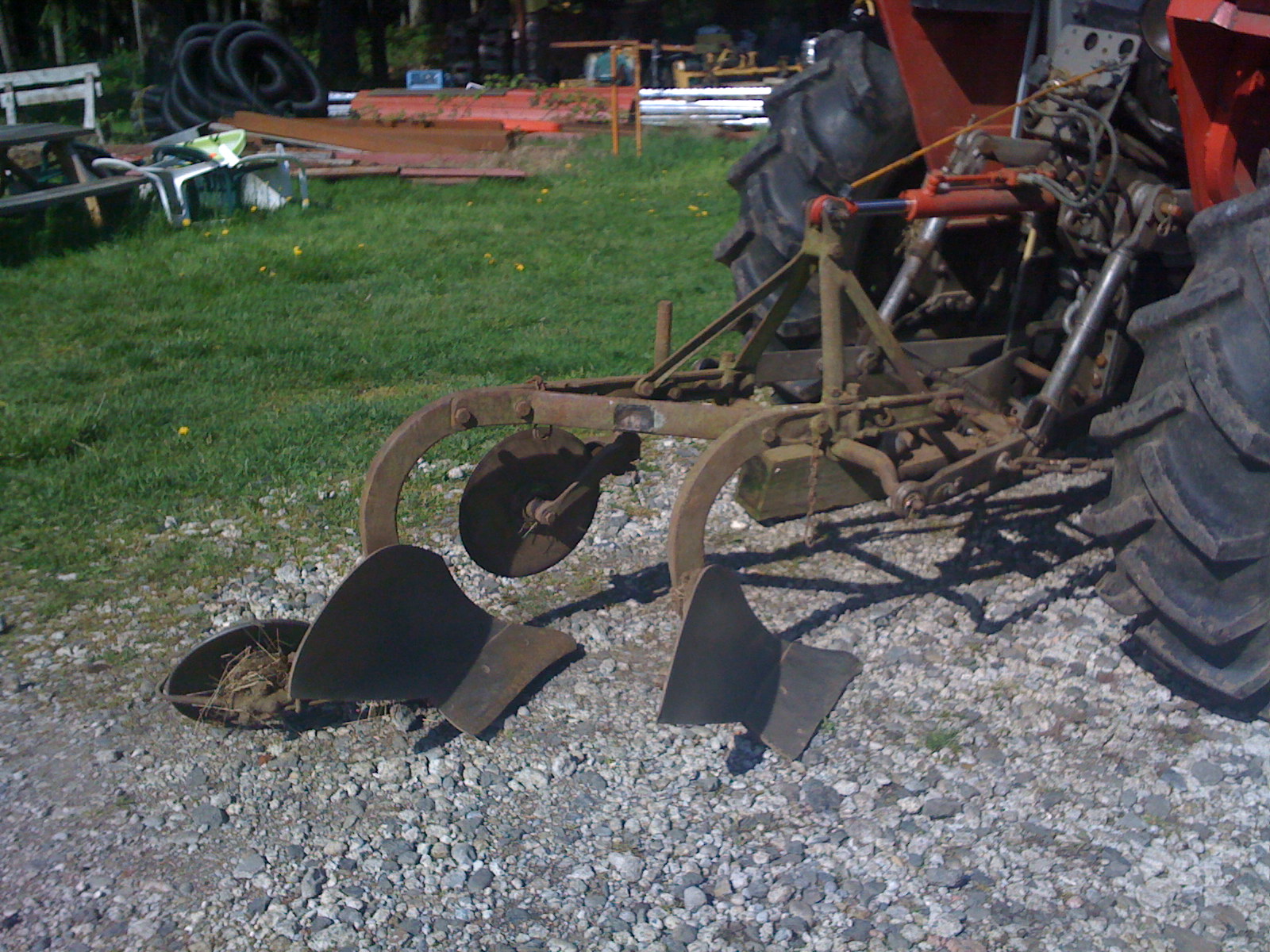

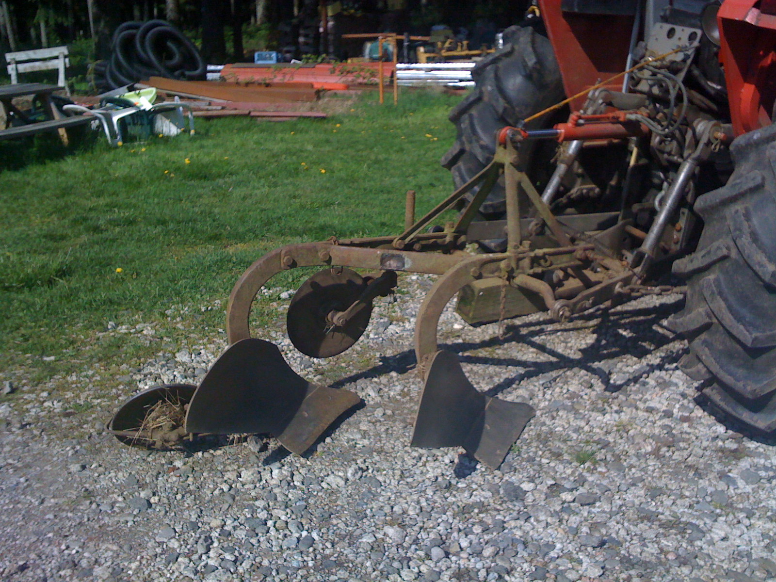

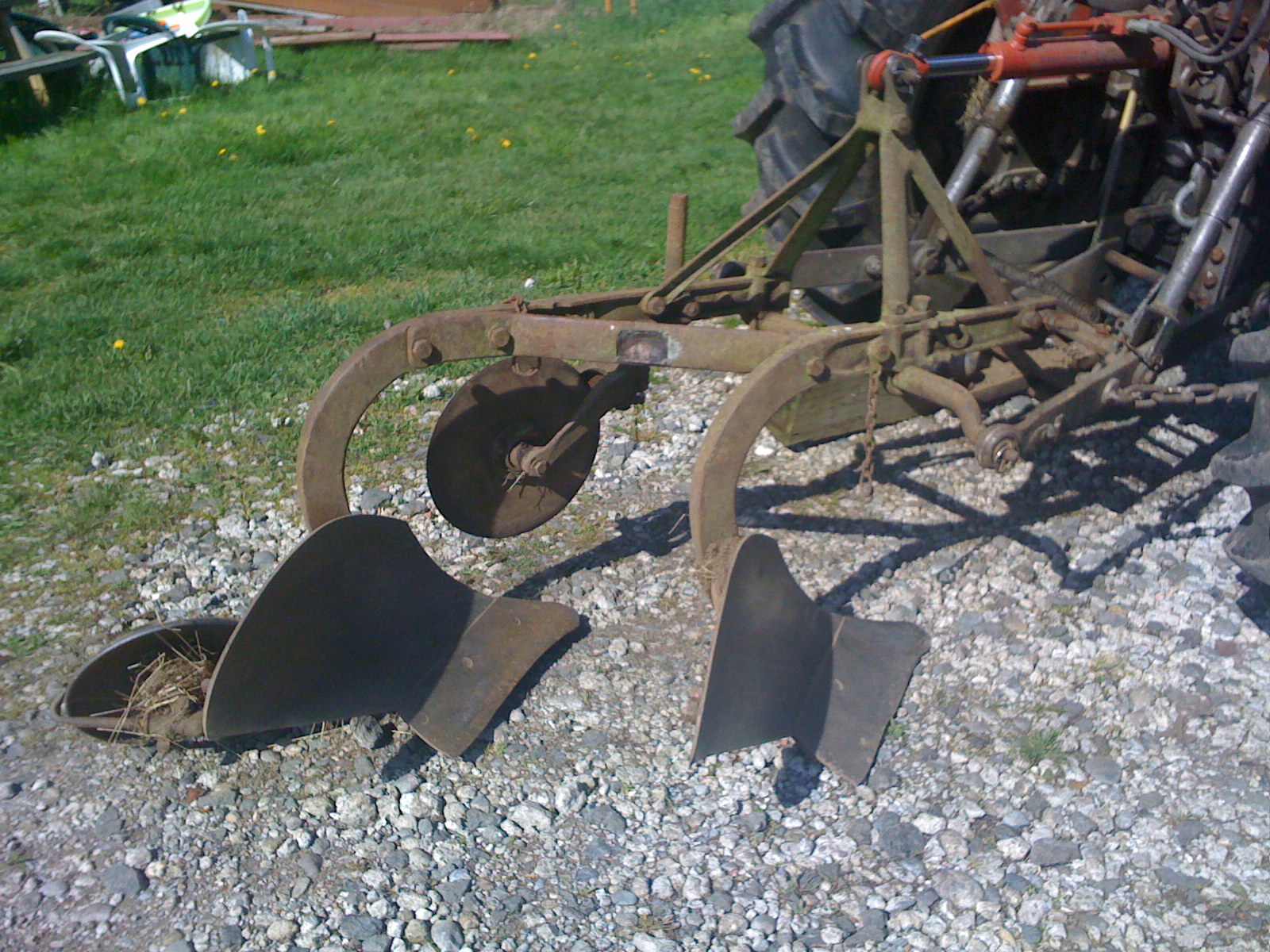

OK---daughters phone has camera so lets see if I can send these out for your review--

As you can see in the photo's the forward share is level and on the ground and the rear is about 2+ inches off the ground---I was able to figure out how to adjust the lift arms and now they are even, so while you have a look-see I'm going to go try it out---

Honestly....., from those pictures, it's difficult to see why you'd be having any troubles. Plow looks fairly level front to rear/side to side. I'm a little curious about the width of cut on the front bottom. Looks like offset drawbar is a bit far to the furrow side. That would cause front bottom to cut a wider slice and give the appearance of moving more dirt even though it was at the same depth. Other than that, looks like you're in the ballpark on other settings.
I noticed the gap under the rear share. I was wondering how level the gravel is under it???? Looks like the rear landslide is parallel with the ground like it should be. Maybe try to extend top link a bit more ????? Too far and the plow will want to ride up out of the ground.
Plow too deep, and the tractor's tires ride in a furrow that's too deep, causing the tractor (and attached plow) to sit out of level, low on the right side. That might make the front (right) bottom sit slightly lower.....just a guess..... Try plowing at 6" to 7" deep and see what takes place.
If at all possible take yet one more photo directly from the LEFT side, 90degrees to the tractor/plow and far enough back to include BOTH in the photo. Pictures can be deceiving....looks like the tail end of the plow MIGHT still be a tick high, which would explain everything.
When I have my MF66 plow hooked to the 150, and it's adjusted correctly, it appears as if the plow is way LOW in the tail end when raised. It runs level in the ground though.
One last wild guess....How much slack is there in all the linkage? Once a plow is in the ground, the top link will be in compression. With a little slack here and some more there, it's not impossible for the cumulative effect to add up to enough so the plow raises a couple inches or more in the rear.
Is the plough aligned straight with the direction of travel?:confused:
Horizontal alignment back to front as you have mentioned?:confused:

The gravel area under tractor is very level in the photo's---I was able to adjust the lift arms to level out the plow while on the 8x8"s(although I'm at the limit of travel on the right one)---went out and played with it some and it's much better now although not perfect.
It works "pretty" good in soil worked(tilled) last fall but is rather poor in virgin pasture---perhaps I expect too much but have been playing hobby farmer for only a few years and the tiller makes wonderful seed beds, the grasses and clover seem to return with a vengence and starve out the vegtables before they really get a chance---I thought by plowing I could beat the grass and clover, enrich the soil and grow good veggies---pretty new at this you know!!!
Will continue to tune and practice---
when daughter gets home will tru to get more pics.

I would put money on it that the rear bottom is sprung. Sight it from the rear and see if the 2 bottoms set at the same angles. If not it is sprung and probably won't ever do a perfect job of plowing. I hope not but I bet it is.
I'm not saying it ISN'T sprung, but it doesn't APPEAR sprung in the pictures. Along with the bottoms looking mis-aligned, a sprung rear bottom USUALLY ends up with the front tip of the share pointing noticably towards the ground (in contrast to the front) It's almost impossible to tell without "being there" though.
Another thought....It MAY be the way the pictures look, but it appears that the rear share may be worn quite a bit more than the front. It's not UNcommon to break the point off of a front share. At that time it may have been replaced, leaving a much more worn rear share.....and as time goes by, they both wear more, the rear becoming "worn out". Dull or overly worn shares don't like to go in the ground.
Sight along the edged of both shares. Does it appear that the rear has a slight curve as oppose to a straighter edge on the front? And again, the pictures may be deceiving, but the front share appears WIDER (from bottom edge to edge nearest moldboard) to my 61 year old eyes anyway.
