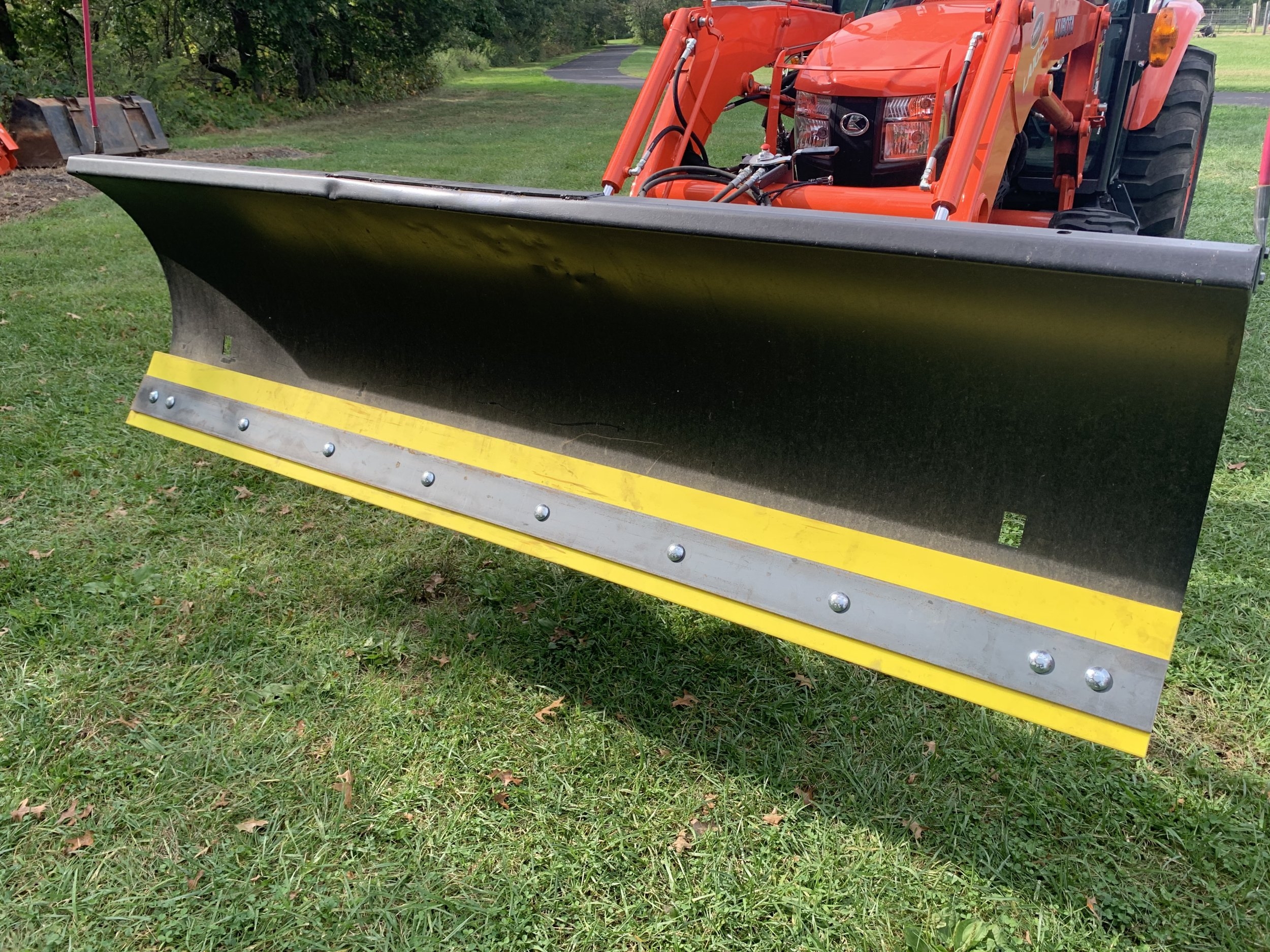

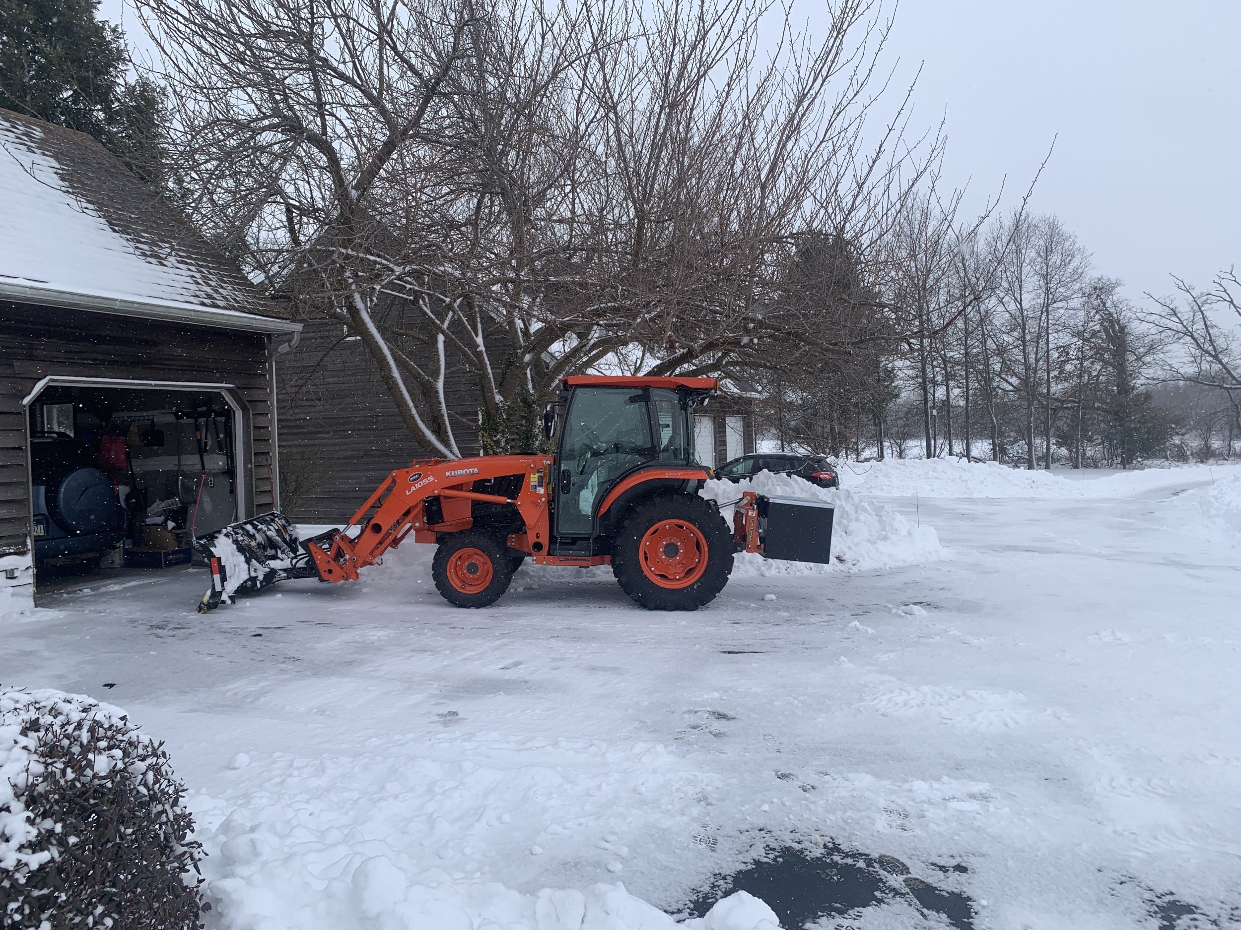

My vote is for the front blade. I put a 96” hydraulic angle with urethane edge on my L6060. I’ve got about 1500’ of smooth pavement to the road plus parking around the house. Chains are helpful, but rarely needed if I keep it under a foot at a time. I do put the ballast box with about 1000lbs on the 3PT.
