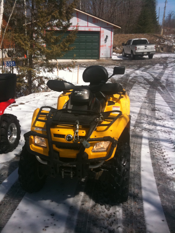

An ATV will be fine. Mine is only 700 pounds, and it works great for snowfalls up to 8 inches or more, and the OP says that he generally gets 6 inches or less. Even so, with heavy snow, you just take more passes and you don't go the full width of the blade each time.
This is what I use, with a 5' plow.
