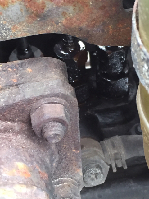

Just seen there is fuel coming out of 2 of the 3 lines coming out of the pump. They are tight any clues of the cause ? ImageUploadedByTapatalk1452714614.803268.jpg
   / Plowing engine trouble #22
is the sealing part deformed? i dont think this is why it would not start though?
   / Plowing engine trouble #23
Just seen there is fuel coming out of 2 of the 3 lines coming out of the pump. They are tight any clues of the cause ? View attachment 453612
How cold was it when the problem started. If water was in the filter it could be in the lines and froze then expanded and damaged the seals or lines themselves.
#24
It was low 30s. I guess it could have been doing that earlier. I have it in the garage now will be going out soon to see what is wrong with it.
#25
That about when it died but it got probably 5 over the night
#26
Got the Yanmar back together. Had to bleed the whole system. She fired up and went and plowed my huge driveway and it did great. I am loving this tractor.
