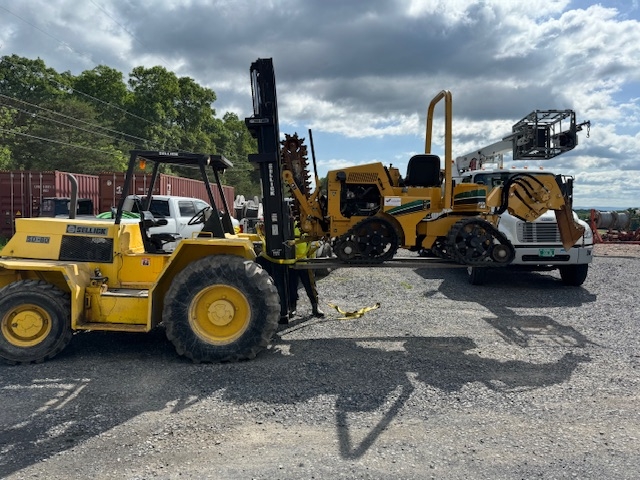

It’s here and about to get to work.

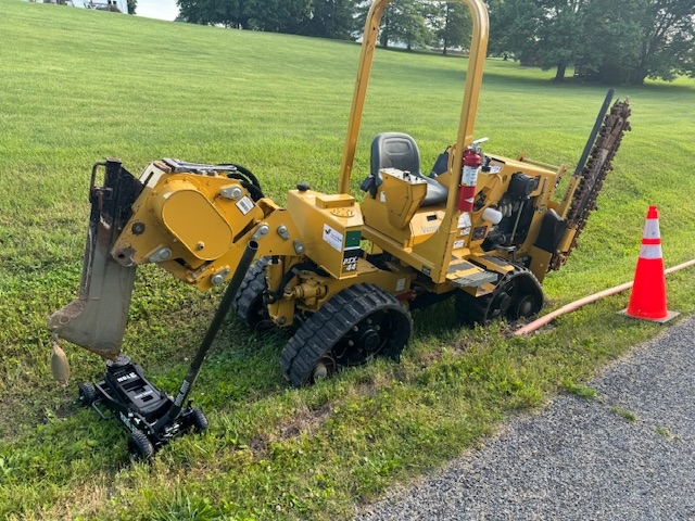

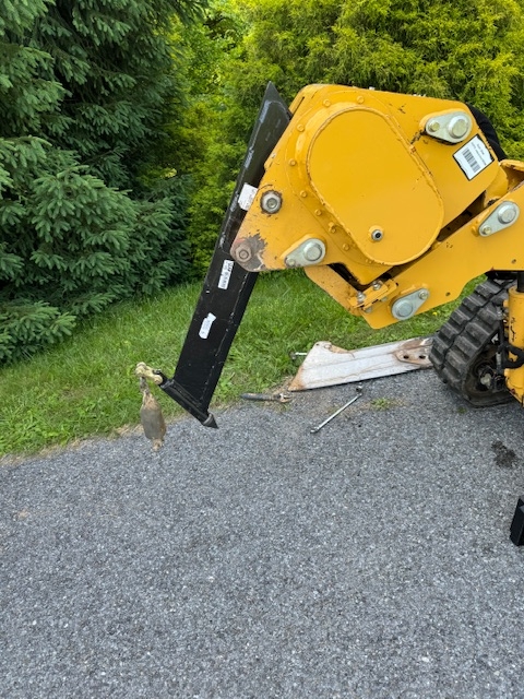

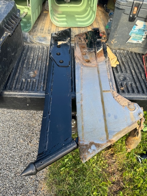

Swapping from a feed blade for direct bury wire to a pull blade. The new one gives the option of 12, 15 or 18” cover over conduit.

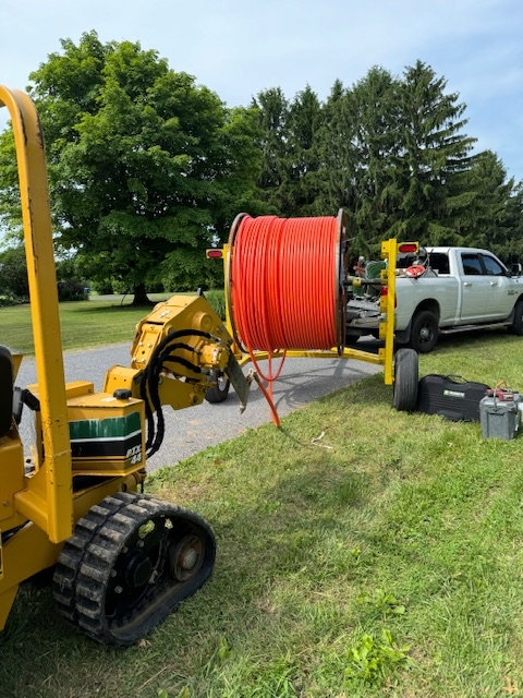

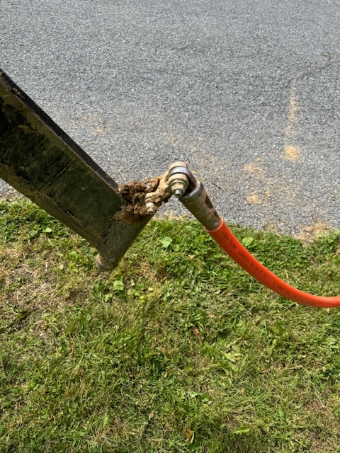

Plowing in some 1” for house drops.
