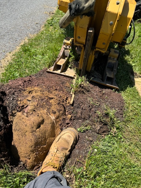

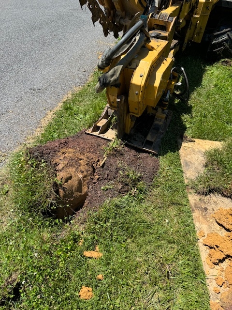

I’ve been plowing in cobble rock soil and it actually plows easier than hard clay back home. I had to cut the extra toe off the front of the plow tip because it was pulling down too tight trying to suck the pads in to. Every once in a while it pulls up a basketball sized rock and that is kinda annoying to clean up.
Horizontal drilling in the cobble rock is a different story. Crap it’s hard on the machine, drill rods thumping and bumping all over the place. 400 or 500 hundred feet puts more wear on the rods and drill head than 5000 in sand or clay!

The rocks don’t slow the plow down but they do add restoration time. If I don’t pull rocks out of the ground you can’t even tell I’ve been there.
So far digging and plowing through rocks is much easier than hard clay in the summer.
