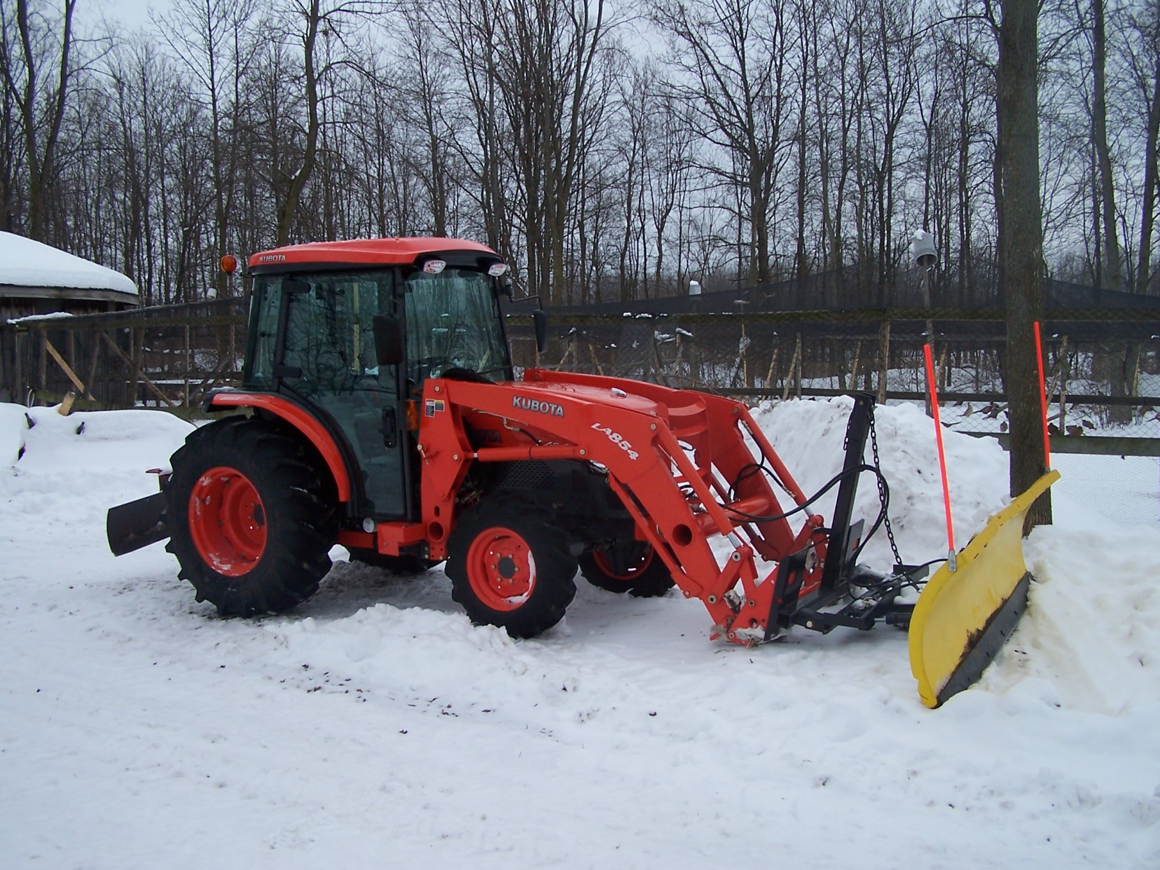

I have a loader mounted blade on the Kubota L4240. It does fine on the black top and you can run the loader in float. I am having trouble from keeping it from digging in on gravel. I can work the loader up and down myself but my driveway is not very level and it is hard and I can only run 2.1 MPH doing that. I have seen guys with trucks plow on gravel and not dig in and the same for the highway department on back roads. I was on a dirt road today that had been plowed by VDOT with a loader and it was not all messed up. I have heard of people splitting a piece of pipe and putting it on the cutting edge but I think the blade still may sink in. One thing that would help would be a good hard freeze but where I live the ground is constantly freezing and thawing. How should my ski shoes be running, level or slightly higher in front? The ski shoes are 6.5" and they are round. Is there any trick to it?

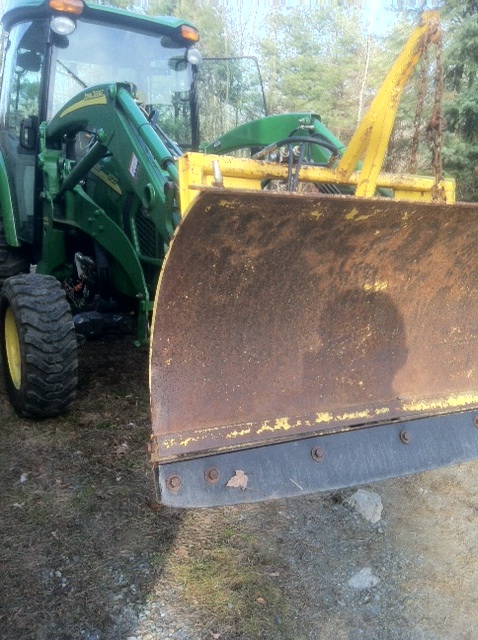

Until you get a good freeze and base, going slow is the best option. Also having a fixed blade can wreck havoc on any crown you may have had. I used to remove the crown BEFORE the season prior to getting a plow that floats. I knew it was going to happen and at least i had some control where it ended up! LOL!
As you are well aware, there is too much weight to float the FEL and what works the best for me is this:
I raise the plow about a foot and angle the blade to the right. Because my blade rotates around the center the right side will then hang lower. As I lower it the right side skid hits first and as soon as the left side skid hits, I stop. I make sure the bucket indicator is level and plow away. Works great for me!

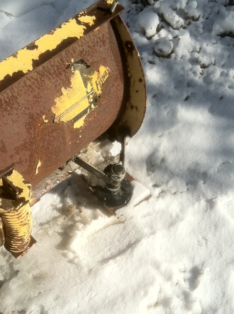

Dave, Nice plow- What brand is that? And if you don't mind, $$??. I'm getting tired of my "junk yard dogs" Attached picture shows front of Fisher-I think its an "H". A buddy gave me a set of new skid shoes (Bought a new F-250 and doesn't use the shoes) so I fabricated up an attachment point per picture. Bottom line they help but will still dig a bit-catch 22 as I see it-either you move gravel with cutting edge or the shoes do damage. Solution is FROST! this last 8" storm we had surface was frozen, so off came the shoes. Until surface is frozen, trial and error as I see it-fine line between moving snow or moving gravel!

Its an HLA 2000 and cost about $3500 here's a link:
HLA Snow
I've tried a lot of blades and this by far is the best I have ever used. You would be surprised how many blades aren't designed to "roll" the snow and that contributes to the digging in and unwanted removal of gravel from the drive. Too many blades just push snow. It also has a crossover relief valve that allows the blade to swing around if you accidently hit something hard. It also has lateral float that follows the crown of the drive and moves a lot less gravel. It's not cheap but man is it sweet!
