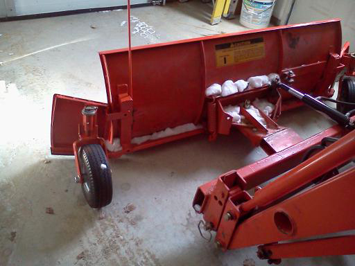

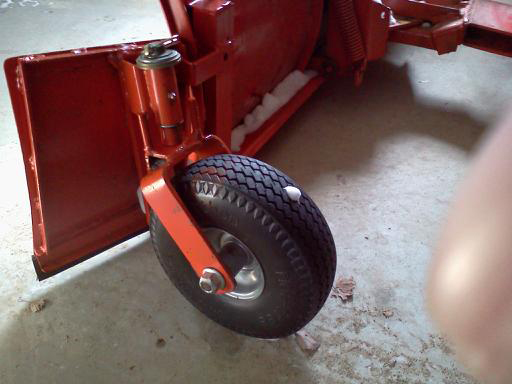

Hello skyhook. Sorry it took a while to get a couple of pics of my setup that you asked for; I'm currently on crutches and a little slow. Anyway, here are a couple of shots of my gauge wheel setup. Let me explain that my plow is a 4 and 1/2 foot blade from an old Case tractor that I modified by adding a pair of homemade 1 foot wings. I had to mount the wheels on the wings to get them outboard enough so they wouldn't interfere with the crossbar at my maximum angle.

Thanks for those pics, zmansmac, I saved them for future reference.
nice setup you have.:thumbsup:
