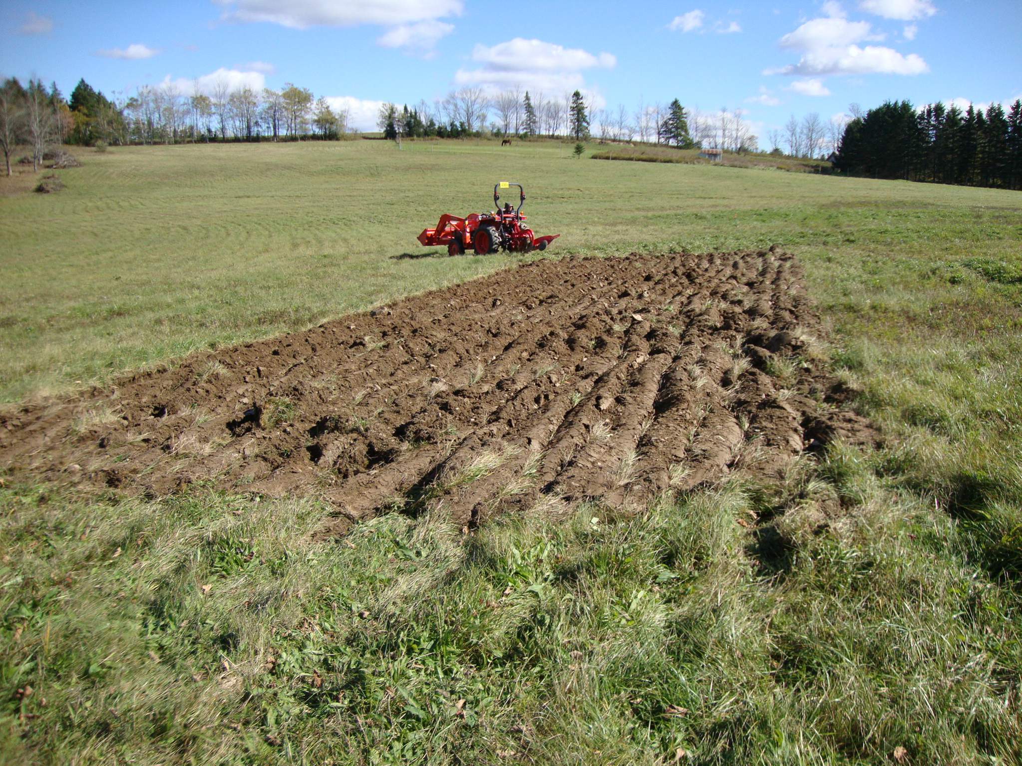

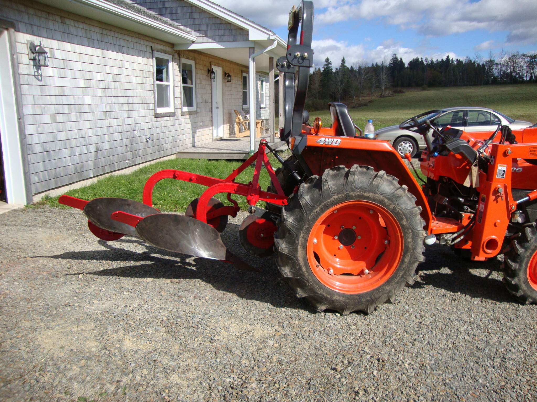

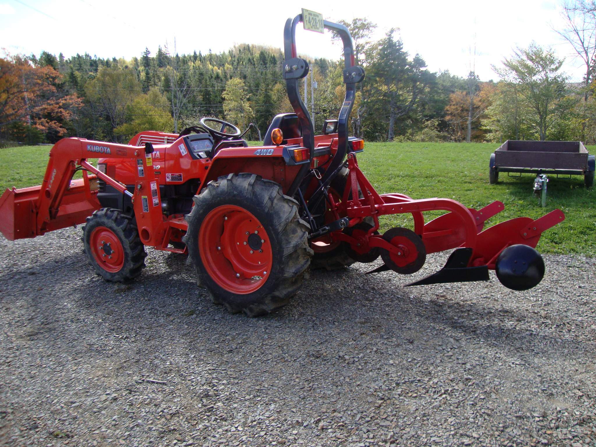

Is there anything more fun to do with a tractor than plowing? Here's a few pics of my handywork from this morning. This is virgin ground. It's been stumped and leveled a bit, but never turned. I've got a Kubota B2630 with unloaded R-4's and I left the loader on. Used the diff. lock the whole time, though I probably didn't need to.
My plow is a very early 40's Ferguson single 16" extra deep bottom. I'm plowing pretty deep - about 9-10 inches. The tractor does fine. Doesn't even struggle. A little messing around and I had her set up perfect. Plow tracked straight as an arrow and didn't want to steer me at all. I'd like to try a 2-12 sometime. I even turned up a couple of basketball sized rocks.
It's mesmerizing watching the ground roll off the plowshare. I could do it all day. I haven't been on a plow tractor since the 80's, and I was just a kid. We were running a Deere 4020 powershift with a turbo and 5 bottom Kverneland.
Next time will be in a couple of months after the buckwheat has gone to flower. We'll see how it does then!

Well I would say you did pretty well. I would love to try it, and have 7 acres, but its all wooded and a lot of it is quite steep, and the dirt is very shallow, over rock shelves. So no plowing for me, but I loved to see your nice looking plow, and the nice looking results.:thumbsup:

Nice straight rows, you have done this before. :thumbsup:

I understand why plowing isn't done so much anymore, but I still say it's really too bad. The big operations have deep rippers to get through the compaction, but for the little guy, plowing is really the only good option for deep tillage. I guess maybe a middlebuster, but I don't think it would take the abuse the plow will over the long haul.
For me, on such a small plot, I'm doing it because my tiller won't go down half as deep as the plow will. My plow is really huge for a single bottom. I've been averaging about 9-10 inches deep with the 16 inch plow, and she'll go even deeper. I could probably plow 10-12 inches without too much trouble. My way of thinking is some deep tillage will help. I realize I will probably get a hardpan layer, but the hardpan would be that much shallower if I used just the tiller. Rye will be sown every fall, and hoping those roots would break through the hardpan, so maybe too deep is bad.
Any thoughts?

Nice work. :thumbsup: Your plow looks in nice shape. I wish I could find an older single plow as there doesn't seem to be any available up this way and a new one is $700.

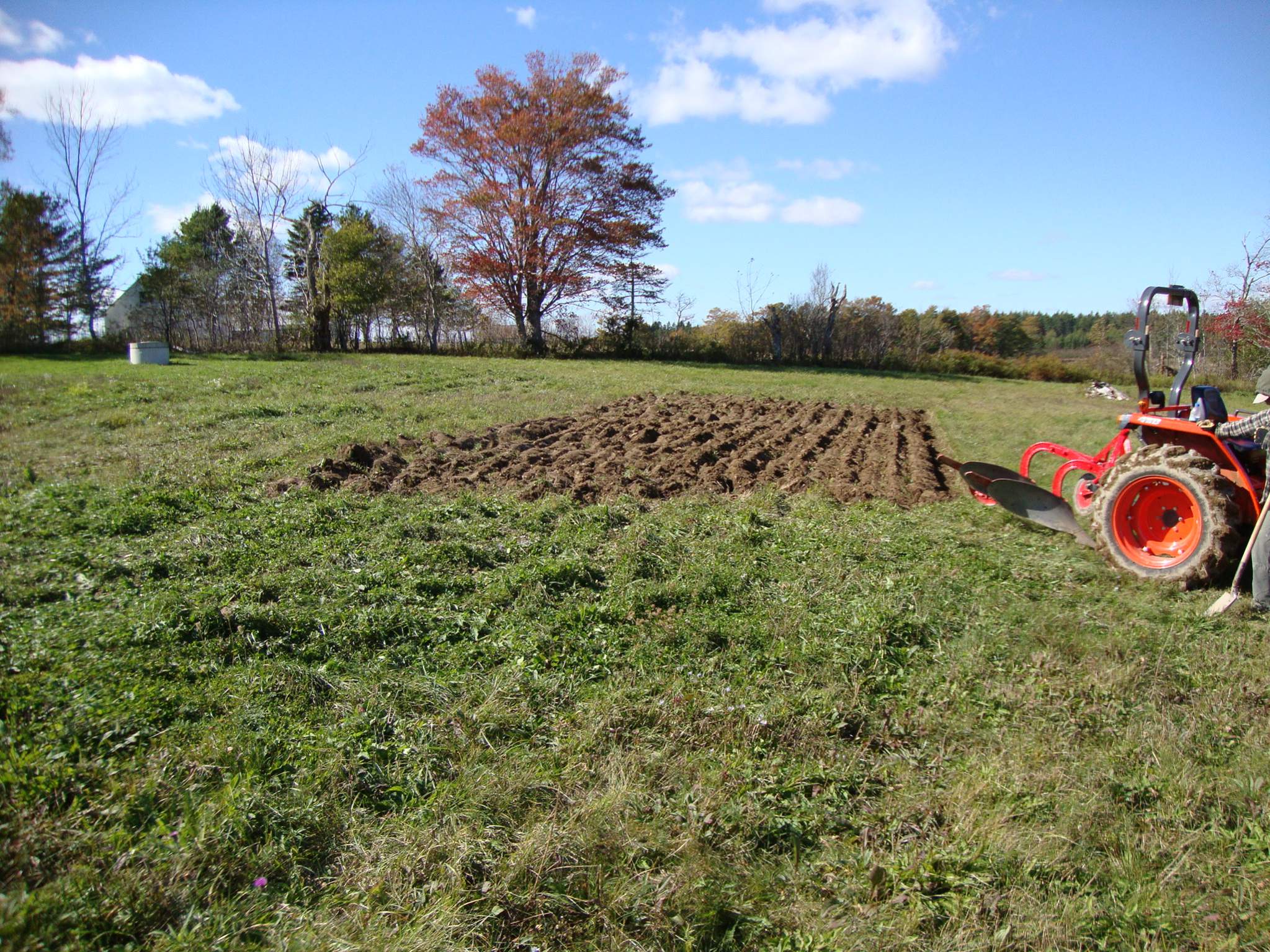

And the pics I forgot to add...

Very nice pictures.:thumbsup:

The plow's not nearly so pretty now after sitting under two feet of snow most of the winter. I've got to find something that'll hang on to the shares for rustproofing, I tried Fluid Film with limited success. I don't want to paint them again since I have to grind it off every time I use the plow, but it only gets used a couple times a year. I guess I could paint them with grease, but I want to be sure I get it all off before I plow the garden again.

We left ours out in the weather too, but it looked pretty rough even then as it doesn't get used much either. When I was farming, we would grease the shares when putting it away for the winter. In those pre-environmentally aware days, a little gas took the grease right off. After you run a plow for enough time the shares will look like chrome. We don't use ours enough for this to happen anymore, but really need to bring it up to the barn, do some maintenance and put it away. We have an old Ford two bottom and Massey Ferguson three bottom and it is a shame to just let them rust.
