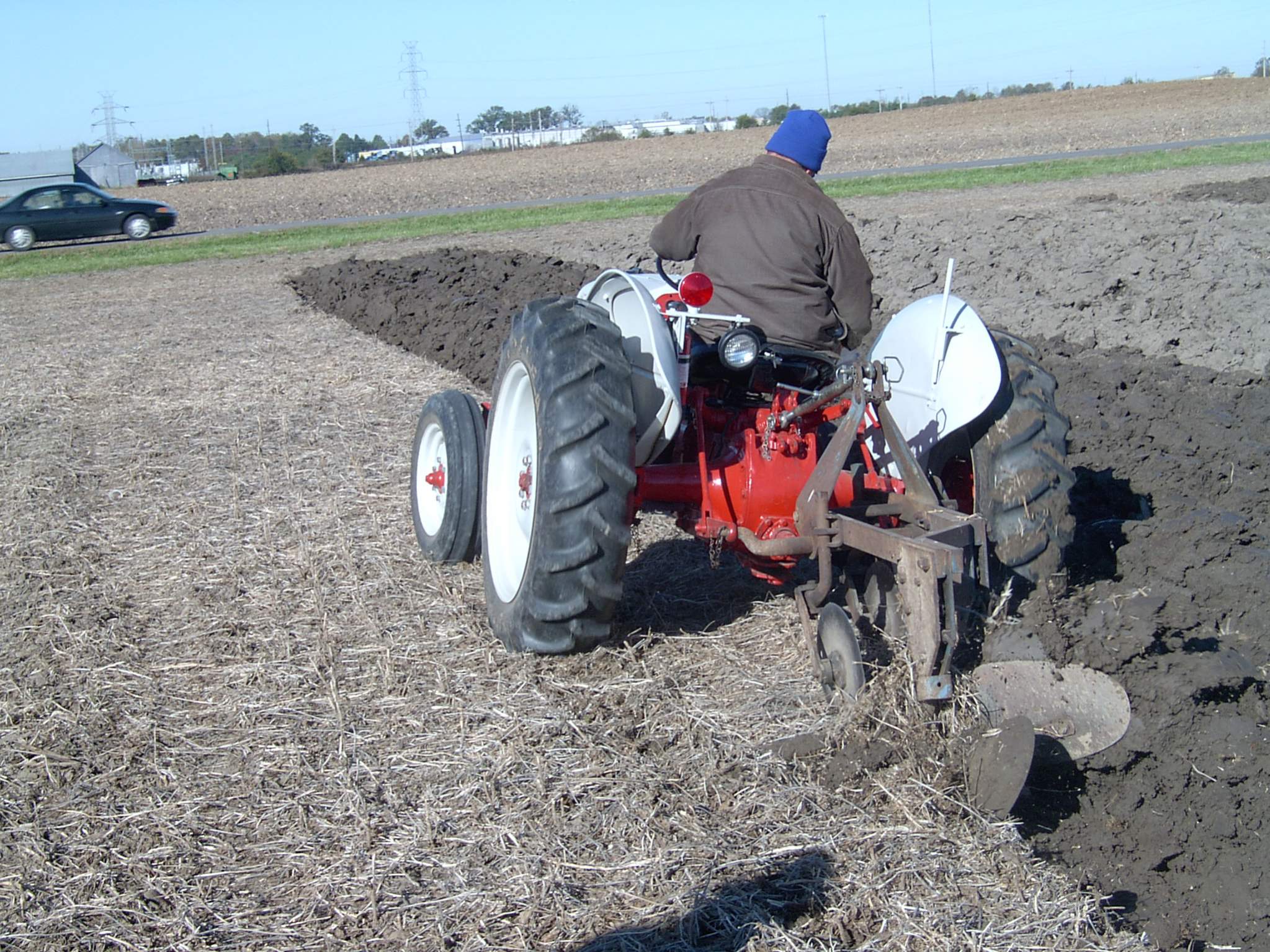

Maybe I'll just keep my 861 Powermaster to plow with.. I was thinking about selling it to help offset some of the cost of a new or newer Kubota.
But it probably wouldn't bring much, and it's kinda like an Old, Loyal Dog - one that I'm still quite fond of
