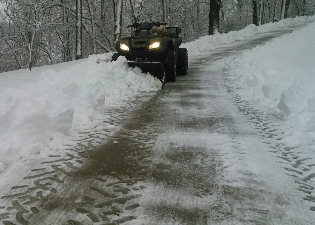

Mine is a Honda Rincon 680 with a 60" Warn setup. Our concrete driveway is 1500 up the side of a ridge and pretty steep and curvy. I would never try to run my tractor down that driveway on the snow. The ATV handles 5 - 6" fine. I take a run down the middle and up and down both sides. I keep the plow angled all the way over to the right but can change it for cleanup. If it's more snow, you can take smaller bites or skim the top. I wore out the plastic wear bar in two seasons but my neighbor bought a stall mat and let me cut a slice off to finish up on the last episode.

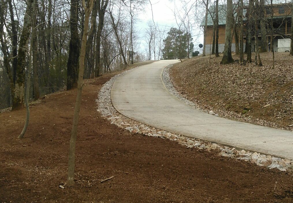

Here is the driveway before snow. It is scribed with grooves across it but it still needs plowed when it snowed. We got a light dusting a few weeks ago and I blew it off with the rider mower. It was 6 degrees so there was no slush.
