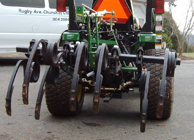

My 4010 with turf tires (R3s?) will pull a soil ripper with all 7 cultivator tines buried.
Ralph

RalphVa
What brand ripper is that on your 4010? It appears to be missing one shank or is that an optical illusion?
How deep will those shanks rip?
Thanks for your consideration.
Arkaybee

Ralph, and my BX1860 will pull all 6 tines of mine. But I gotta say, only with 4WD engaged. The R4s shown do all right, but I gotta believe that R1 would be slightly better. We didn't have all these conundrums 50 years ago when we got our Massey-Harris. One tire only. Folks were just glad to be off steel. :D:D
