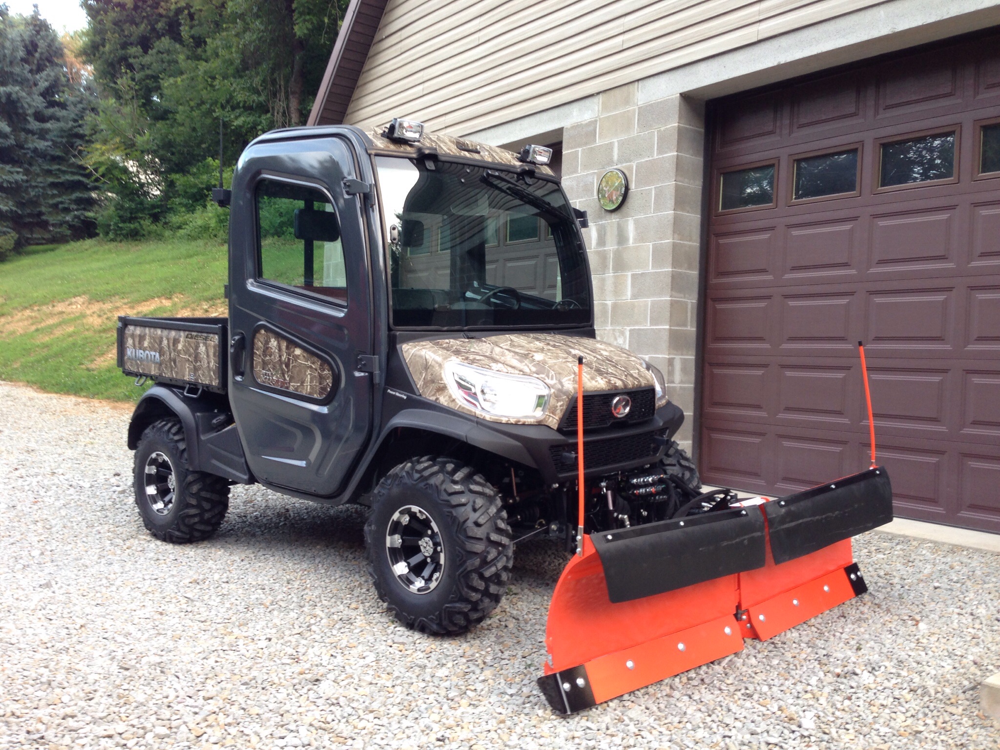

This is my set up and I love it a cab is they way to go heat and Ac is awesome.

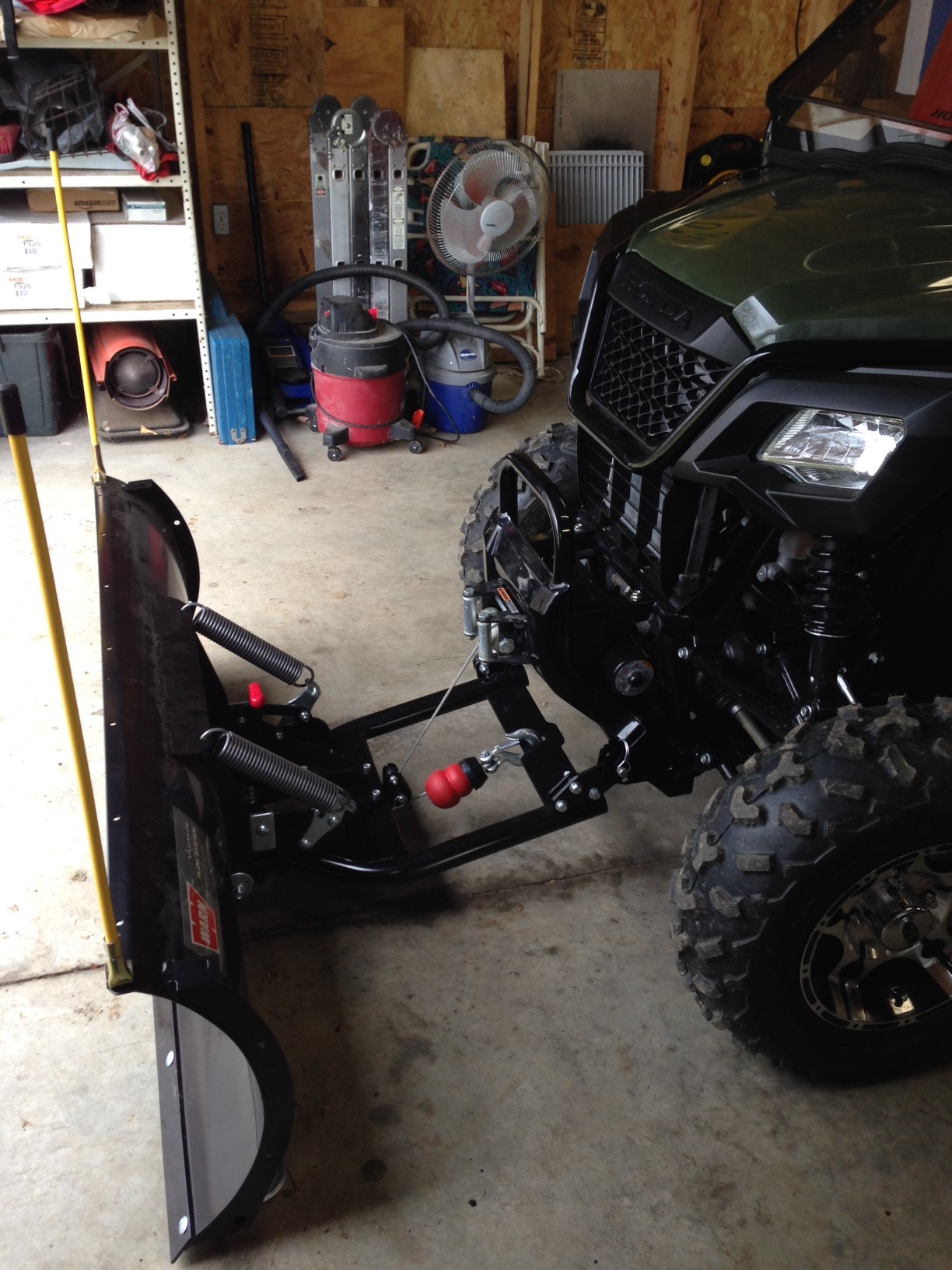

I am plowing with a Honda pioneer 500 ,this being my first utv,I was amazed at how well it pushes.
