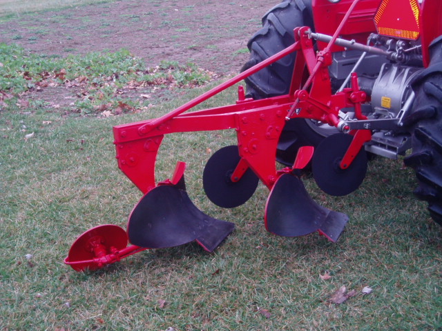

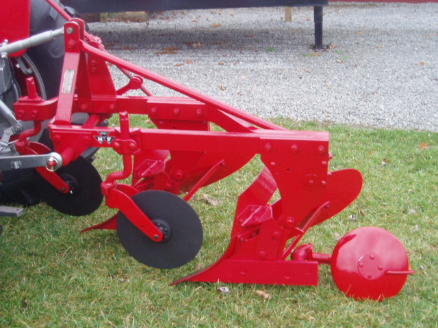

Here's the #66 Massey plow I re-did last winter. Parts, freight, paint, and decals set me back over $650.

Sorry--She's a mf254 w/calced tires around, mfwd, loader,etc. Perkins has been warmed up a bit( enough to comfortably till with a c&c 6' tiller @ full depth). Just want to roll over the sod a couple weeks before tilling.

That is one nice looking 2 bottom plow you have there!! The tractor, what I can see of it looks pretty good too. What model MF is the tractor?
