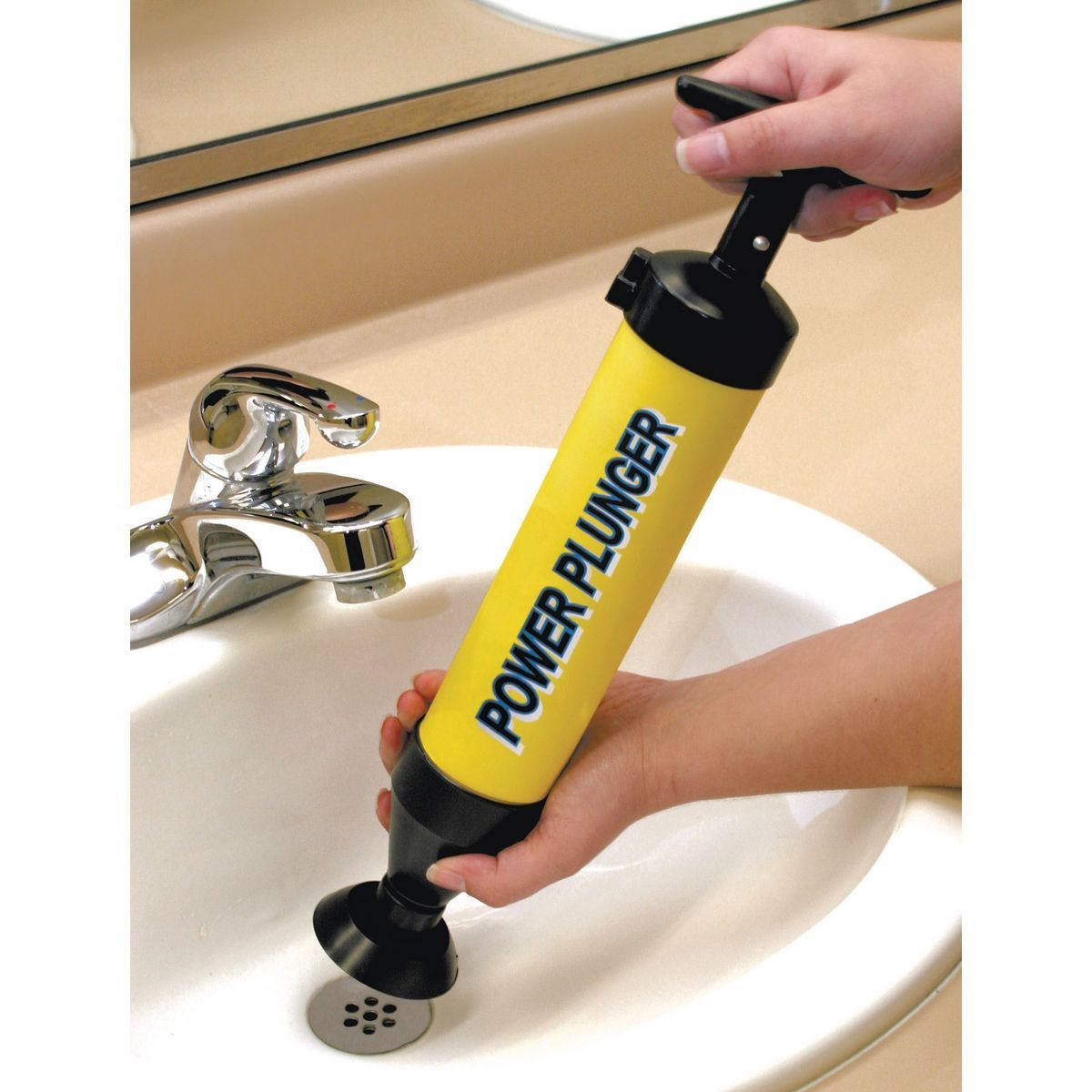

Anyone ever try one of those pump or pressure plungers? They have one in Harbor Freight for $9.99 and it got good reviews. Might be worth a shot for that price.

I stopped at Harbor Freight today and purchased one of those "As seen on TV" power plungers for $9.99.
I plugged the outlet from the dishwasher and started running hot water. It was not long before I had a bunch of water in the sink.
I pulled the plunger arm to get as much water into the device as I could. I hammered it with everything I had. I did this several times.
Soon the water ran freely down the drain and did not back up anymore.
I'd say it was a win for only a few bucks.
I want to thank all of you for your comments and options. It's what makes this forum such a great place to come for advice.
