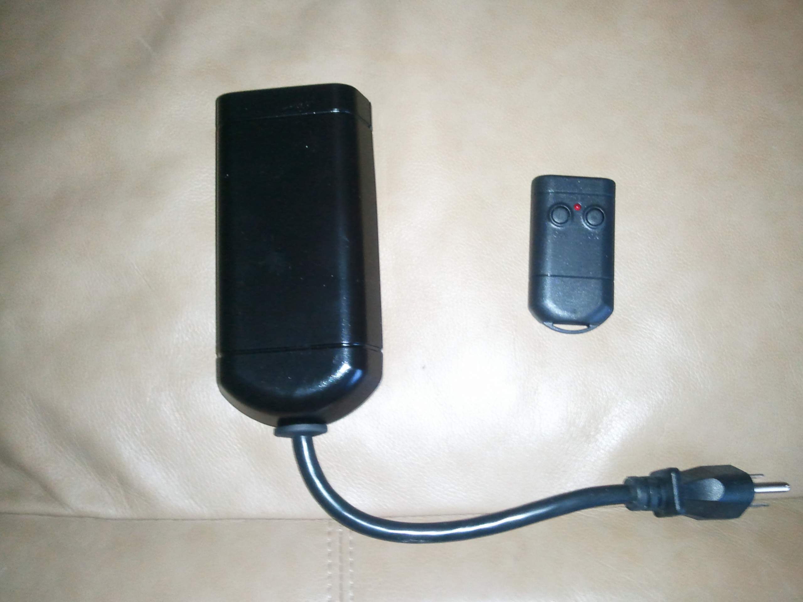

Ok so I can't take credit for this cause I read it here on TBN first but thought I'd share it anyways. This is brilliant!
I bought this at Ace Hardware for like $25 bucks. I'm sure it's sold elsewhere. I plug my engine heater into this and click it on from the house.:) No need to go out in the cold to plug in your baby before you go out to plow. The only badfall about this is that you can't really tell if it started by just clicking it.....(no on light).....sooooo I plugged a worklight along with the engine heater so now when I click from inside the house and see the worklight come on.....I know the engine heater is on also. GENIUS!!!:thumbsup:
I LOVE this place!!:p

The only problem is the device has a range and beyond that it will not operate the relay. My building is out of the range. I go out early and plug in because it gets me out of washing the floor , vacuuming ,and doing the dishes.

My barn is 3/4 of a mile from the house.............
Plus, barns do not like unattended electrical devices..........

That is a great concept, but be careful to check the wattage/amperage rating of timers, remote relays and such. A lot of that stuff is built for smaller loads than the average block heater creates. When I was farming I used a couple 1200 watt rated timers; they were about $40 bucks each at the time IIRC which was more than triple the cost of a light duty timer.

Okay; now install a remote stater kit to complete the job!:thumbsup:

I wrote about automating my barn here http://www.tractorbynet.com/forums/rural-living/187856-barn-wiring-home-automation.html. X-10 will work those long distances and has properly rated devices. I think the OP's idea is a great one.
Craig, I can certainly understand your reasoning. I just don't like the cold, so I want to get started right away.
Dead Horse, I lived with an unattended house (this was our weekend farm until last summer) for 25 years. Like all things, there is a risk with unattended electrical devices, but those can be mitigated by using the proper equipment and follow safety procedures. Still, I wouldn't try this if I wasn't comfortable with it.

I use X10 20amp 3pin appliance modules and our office computer to control the heaters in 3 of our tractors. Automatically turns heaters on and off in our equipment shed from house. Warm engine it starts like summer time and quicker heat.
