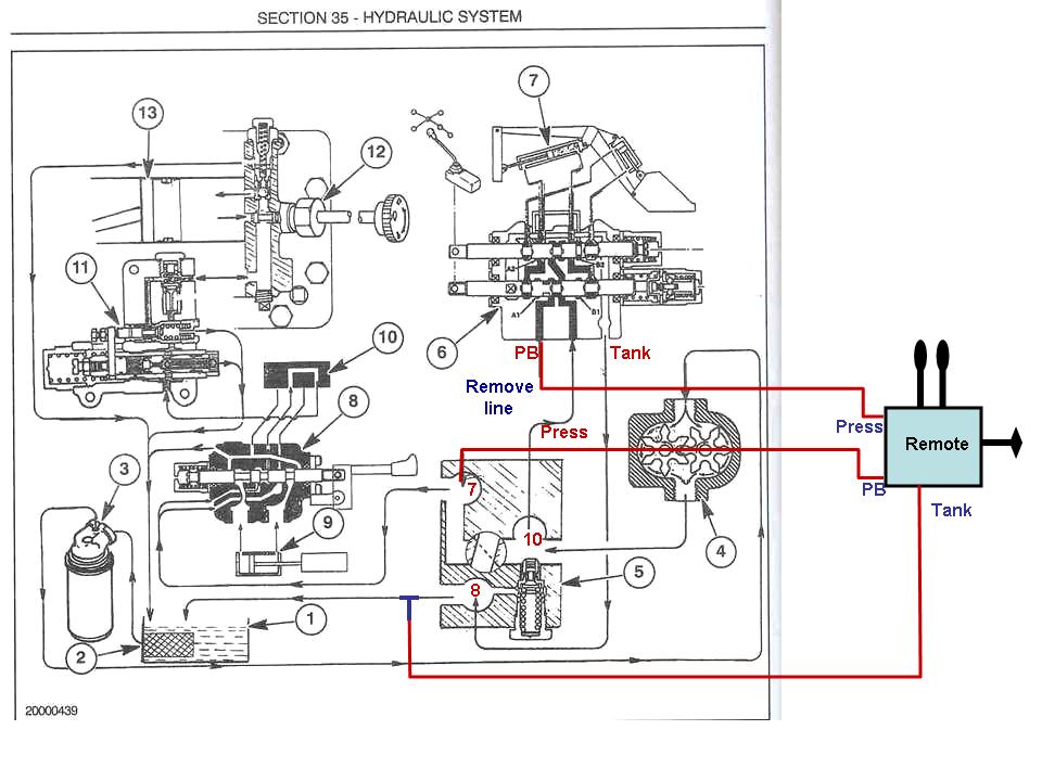

SS, is the backhoe a New Holland hoe? Can it use a factory remote hydraulic adapter instead of re-routing lines?
You can plumb in the backhoe by interrupting the power beyond line going from the FEL to the 3PH. That's actually the standard way of doing a hoe attachment. Two quick connect fittings are installed into that line, one male and one female. Those attach to a male and female on your backhoe. If your backhoe has a "T" tank fitting, it can be returned to a port on the remote adapter blanking plate. When you attach the hoe, you disconnect the quick attach and hook up the hoe. When you remove the hoe, you MUST re-attach the male-female quick connects on the tractor to provide hydraulics to the 3PH and keep the pump from dead-heading.
I strongly suggest you look at another tractor with a backhoe before you attempt the plumbing. It's a simple thing if you do it right and a mess if you do it wrong.

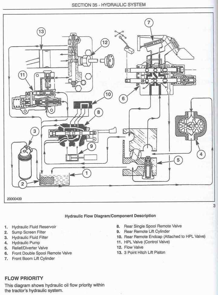

Below are two diagrams that show basic flow in the hydraulic system. The first diagram (with no thumbnail) is unmodified and should be compared to the 2nd. In the 2nd diagram, a remote valve is shown. Instead of a remote valve, just consider this block your backhoe. All connections to the PB, Press, and Tank lines are made through quick connects.

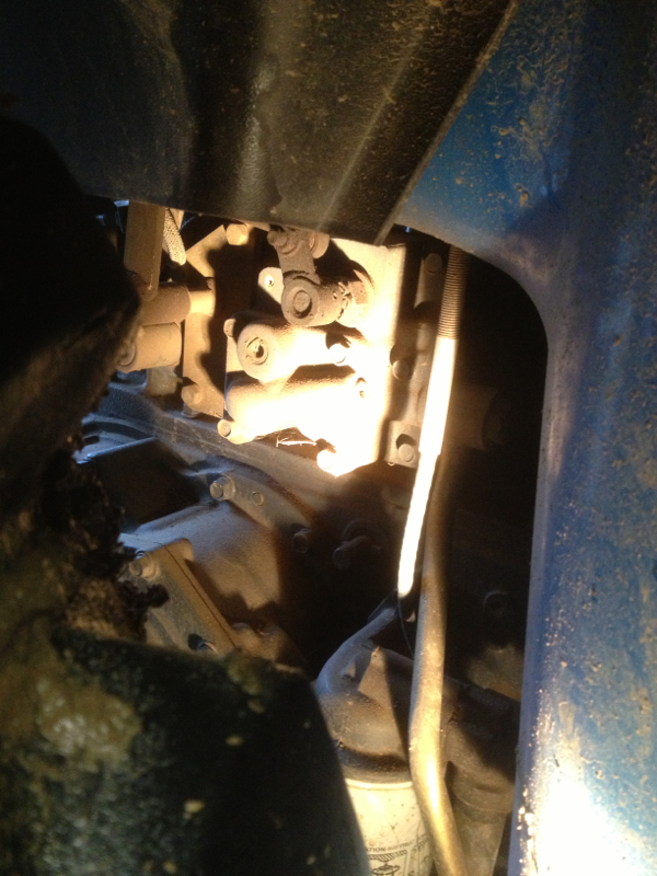

Seems like There is a spot next to the right rear wheel, there are 2 pluged ports ? Is either of these a correct ? Looked on eBay found nothing.. Thanks for the info

RickB, Can I at least do the return into one of those ports? And hook into the PB up @ the Fel ?

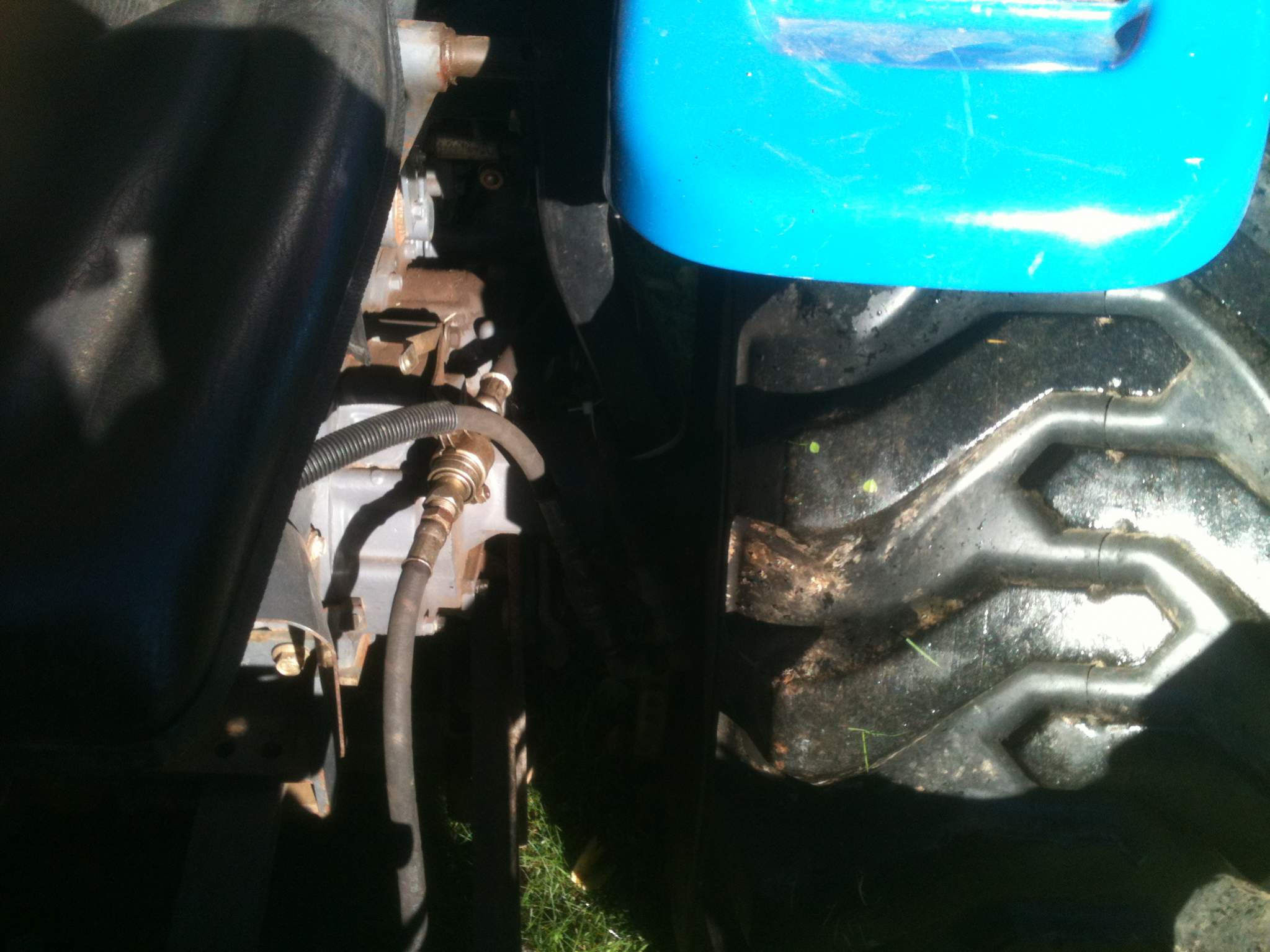

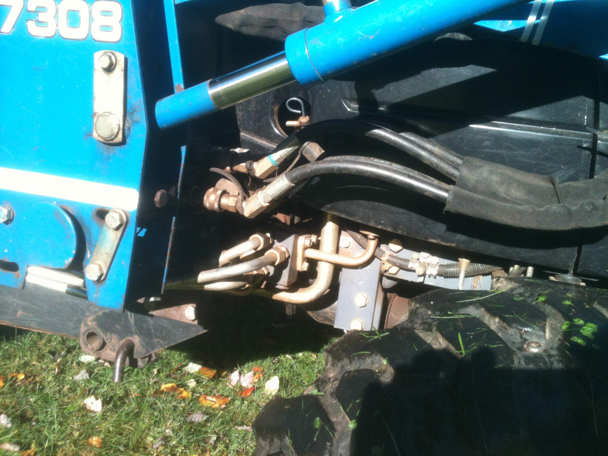

Here are some pictures of my TC29DA with a Woods backhoe.
There are two lines coming from the hoe, one connects to the hydraulic block on the right side of the engine, the other goes up into the control valve for the loader. I am guessing that one is the return line.

The guy on ebay may have taken his auction down, he normaly sells his part for about $50. The part can be purchased on the web from several tractor parts houses for $80, (TractorPartMart) it's made by Tisco part # HV4945. This plate will tap into the rear hydraulics and give you a port for a pressure and return line.
