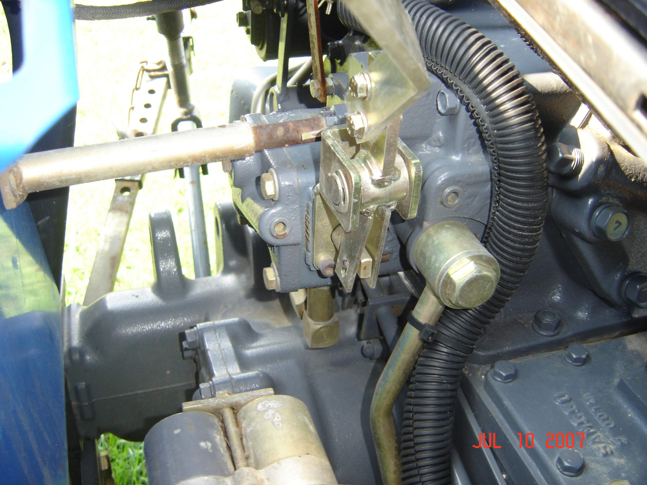

Picture 002.jpgI put a bush hog BH on my TC35DA a few years ago, and more important than the hydraulic connecting is making sure all the frame work of the BH fit's the NH supports and pins. I removed the rear tire and connecting the plate and other plumbing was a piece of cake. here's a pic of my plate attached
gary
   / Plumbing into Tc33D Hydraulic system for backhoe.
#12
Is that a new Holland plate it doesn't look like the others? Does it also have a valve on it or something? My neighbors TC 35 has a fitting coming out of that cover plate in the center which was used for a backhoe hook up. And his other line is hooked up in the FEL..

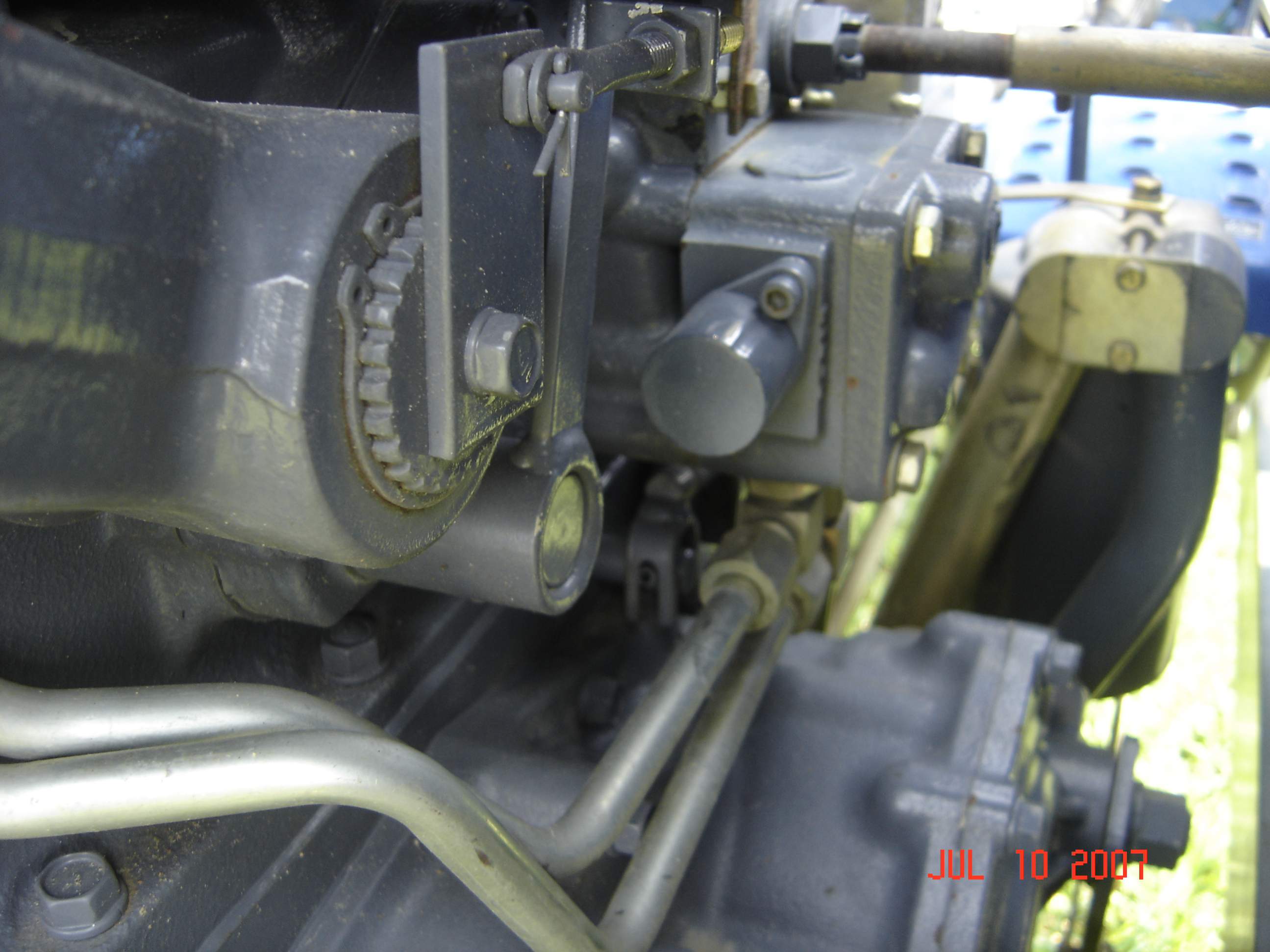

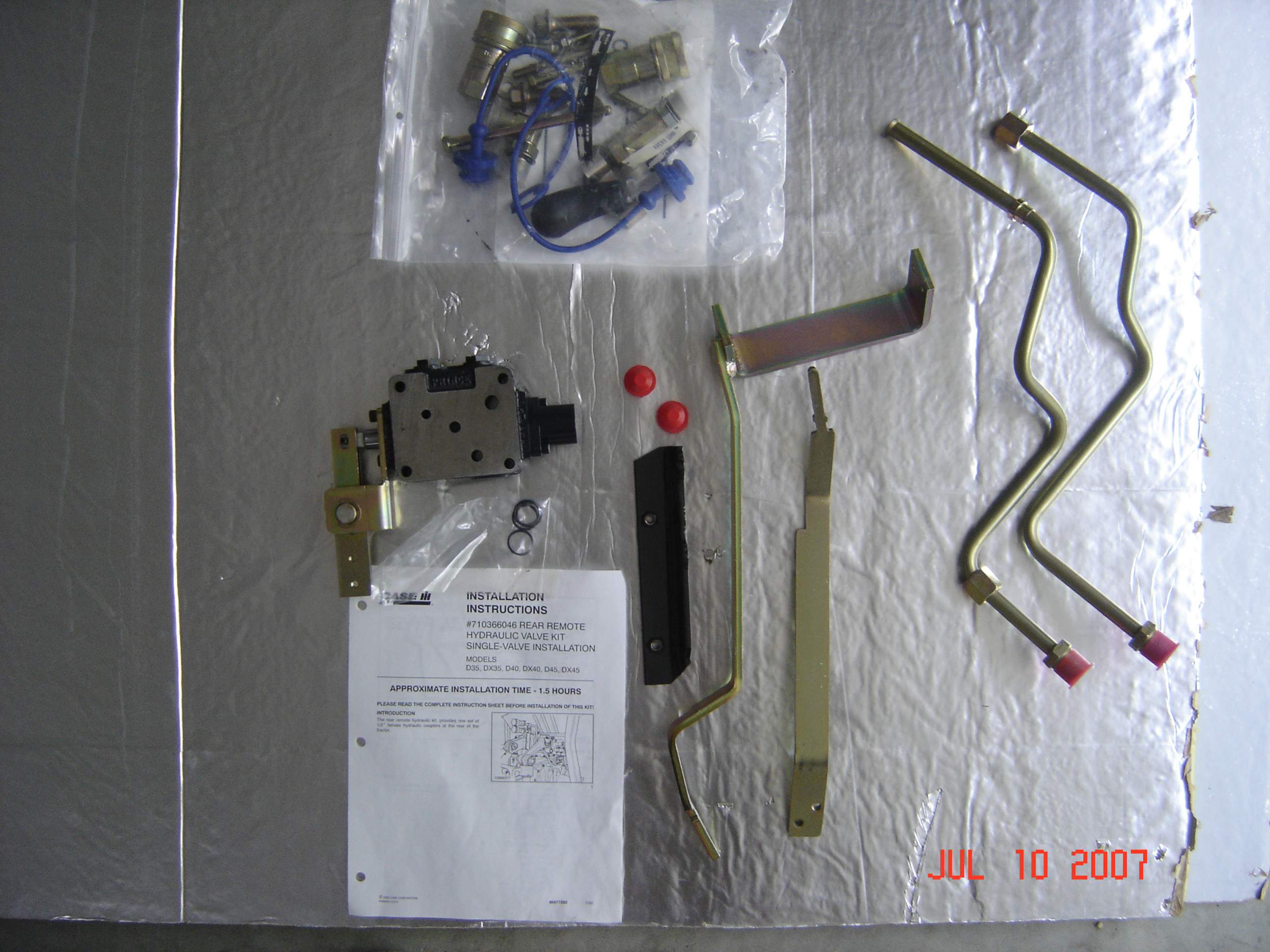

here's another pic
#14
Aaah the $600 newholland remote, Wish I could find a used one! Thanks for the input and pics!

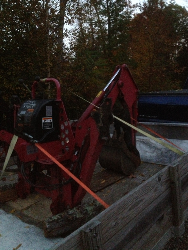

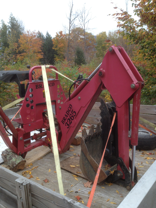

Made the purchace, now's the plumbing!
   / Plumbing into Tc33D Hydraulic system for backhoe. #20
Dang! Supersteer, that looks like an awfully big backhoe for the TC33. Maybe it just looks big in the photo. I'm envious of your thumb. I need to get one installed on my own full-sized TLB.
