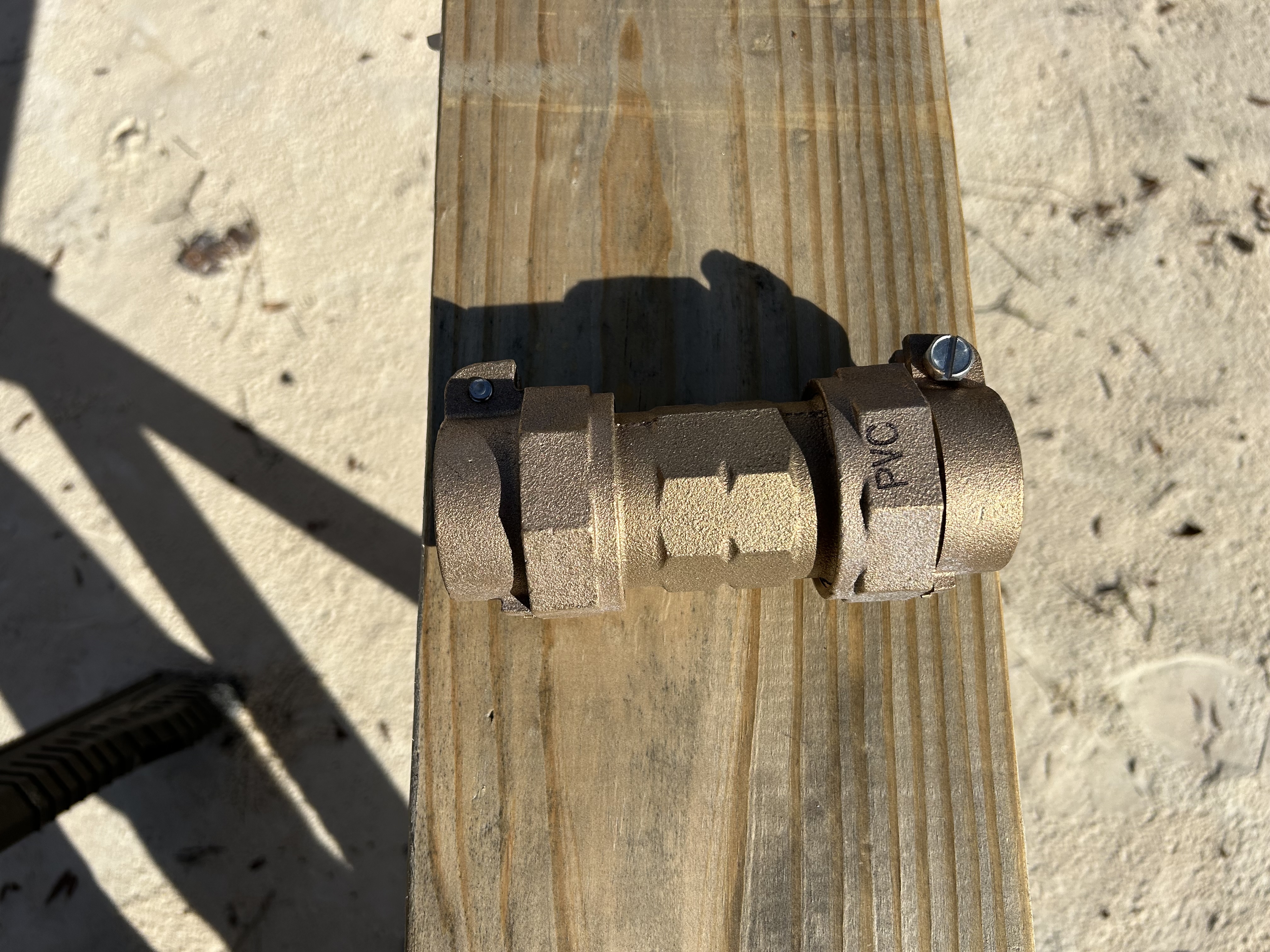

I live in a remote area and have a quarter mile buried water line that is my responsibility to the metro water line at the main road.
My neighbor had a leak he noticed in his water bill and had a plumber dig up our dirt road to temporarily install a boiler valve for the purpose of a leak detection company to pump in nitrogen and listen for the escaping gas hiss to locate the leak. However, in doing this the plumber nicked my line which is very close to my neighbors line.
At no cost to me, the plumber cut out the nick he made in my line and installed two of these compression fittings and a small section of 2 inch PVC.
The boiler valve was installed and the leak detection company came out and laughed at the work because it was worthless. Right past this area the pipe goes downhill. They knew the leak was in the downhill area and the leak detector guy said "gas doesn't go downhill." So he never did anything, drove away and billed for the visit.
Eventually, after long painful discussions about what to do next, I reminded my neighbor that this same plumber installed a compression union down hill a few years ago when he had a previous leak. The plumbers and my neighbor finally agreed to act on my hunch and dug up this existing compression fitting and found that it was leaking.
The reason why this compression fitting had failed was that at this point, the 2" water line starts a large bend where the pipe must turn 180 degrees down the driveway. We call this area of driveway "the switchback." If you zoom in on the picture you should be able to see that the pipes don't exactly line up in the compression fitting. There is great pressure of the pipe and the water in this fitting.
This got me to wondering if there was a better solution to this issue.
What I found was confusing and contradictory. The first solution would be to use a the PVC cement bond, but this plumber said that would be weak and didn't want to do it. I found references to a "stiffener" that could be added into the ends of the pipe when using a compression fitting but when I looked online, all I could find were the stainless steel stiffeners for other types of plastic pipe and none said specifically PVC. The last solution I found was the larger PVC threaded unions but those would still have to be cemented into place.
Has anyone seen or used a "stiffener" inside a PVC pipe in conjunction with a PVC compression fitting? Should I be looking at something else?
By the way, the plumbers charge $500 for each time they dig up and install one of these ball valves, so my neighbor had to install about 3 or 4 of them and that cost builds quickly. The ball valves were installed to narrow down the location of the leak the last time it happened.

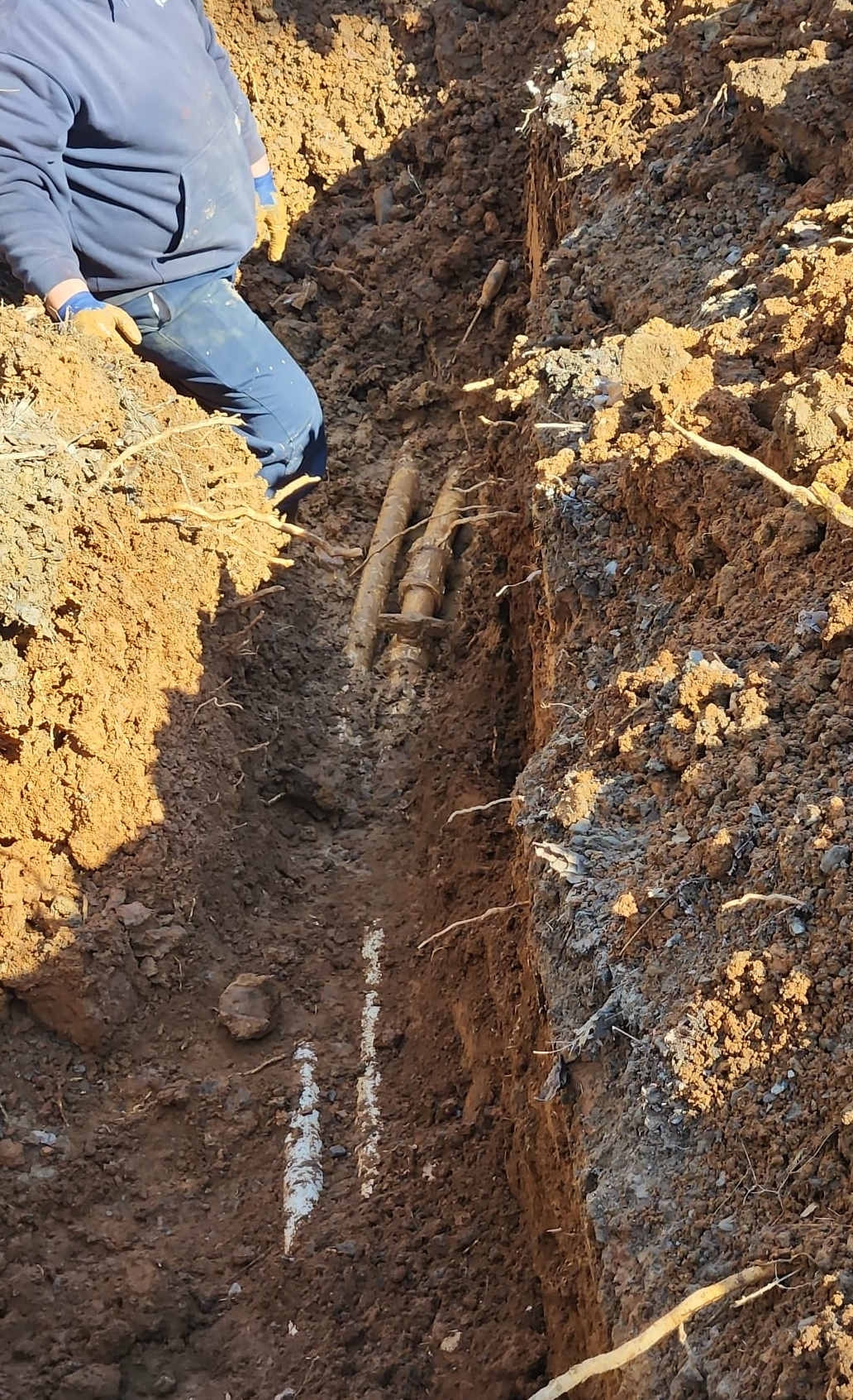

I don’t like to keep fixing water line. After the first repair is made the trend seems to keep on as your neighbor is experiencing. I’d about start up the ditchwitch and replace all of it. If that’s absolutely not an option I’d replace the bent section so you can at least couple it back on straight and correctly instead of fighting with misaligned pipe. My solution seems kinda excessive which it is but he’s already at $2000 in plumber visits plus the lost water which is frequently beyond $1000 per leak and it’s not even fixed yet.

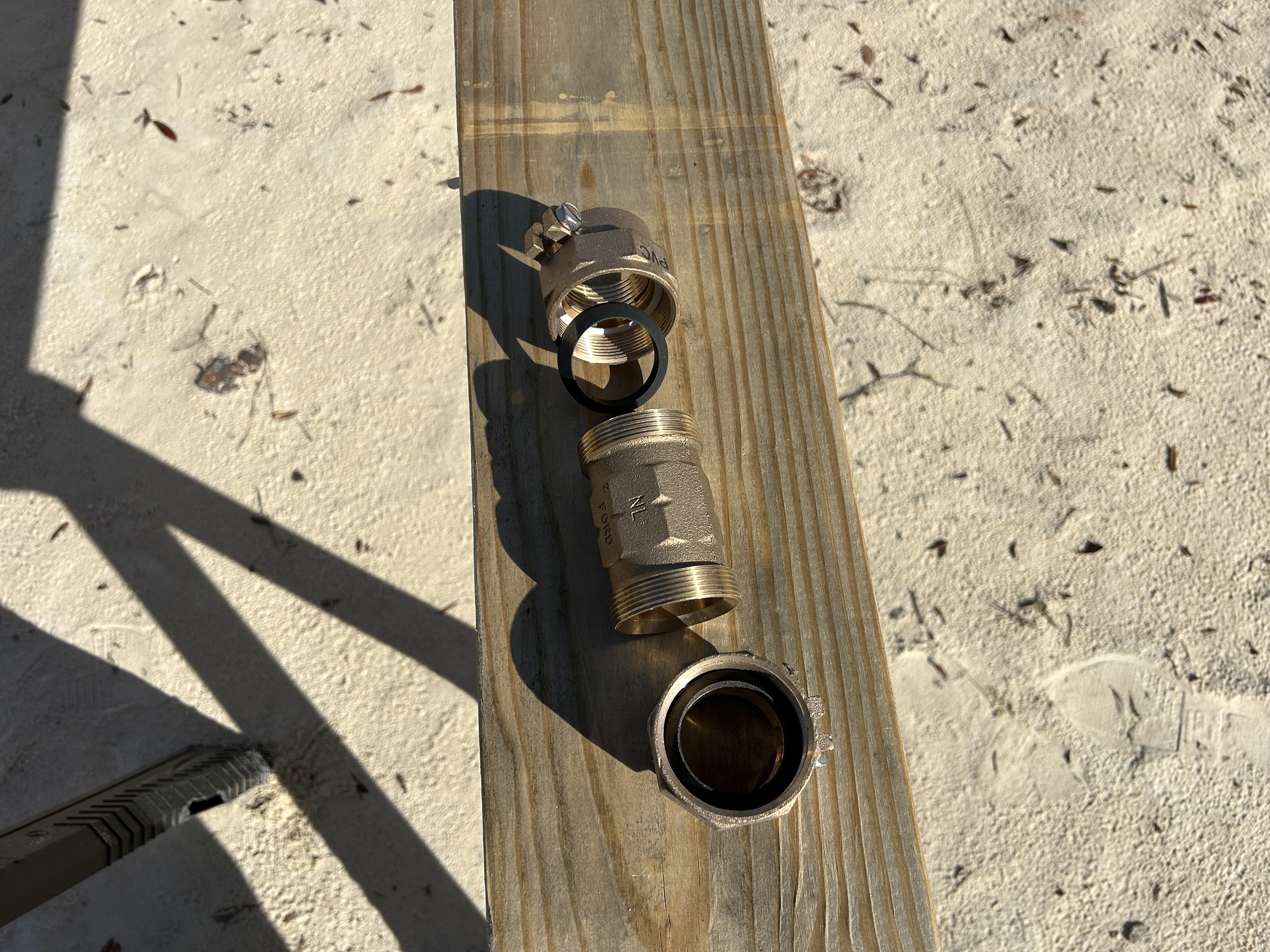

These are the couplings that I use for my buried water lines. Very heavy duty compression fitting.
This particular one is 1 1/4”
