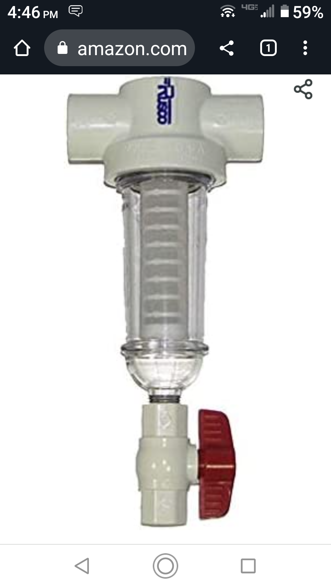

As was earlier mentioned, adding a high molecule filter will drastically slow your water flow as well. Our pump is set for 20/50 psi. We can't go smaller than a 10 micron filter or we also experience major reduction in water flow, even with the 5.7gpm kitchen faucet.
