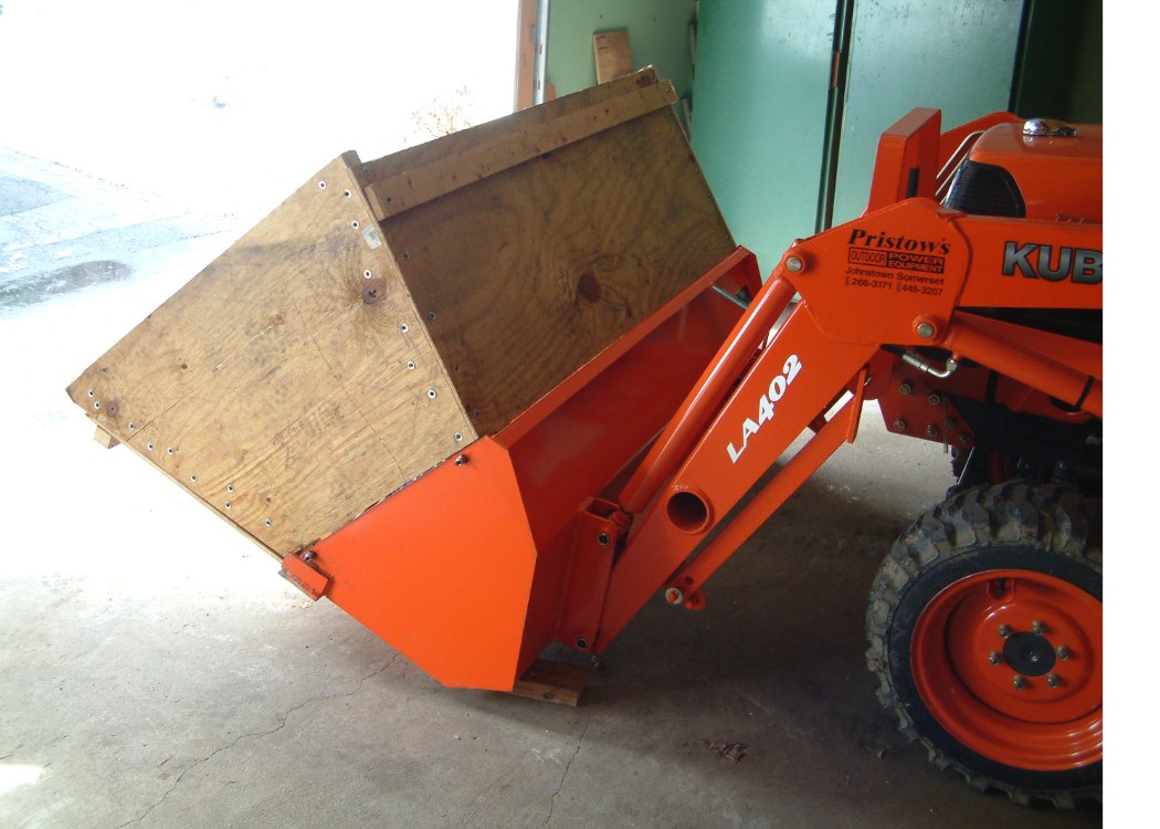

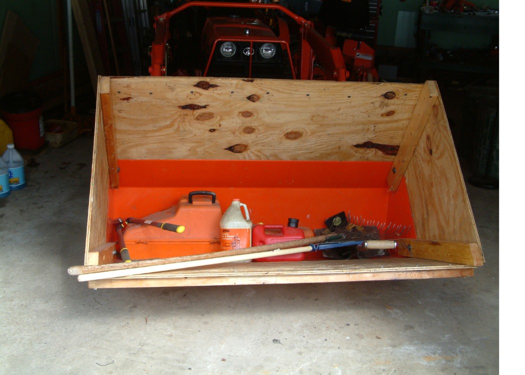

Here are some pictures of the carry-all I made. Good for bulky, lighter weight material. Made from ½" plywood, 2x4's, and furring strips, screwed and glued. I believe I used ⅜" bolts to fasten at each corner of FEL. Probably takes five minutes or so to install or remove. Only bad thing is I have to remove the tooth bar I just made in order to install the carry-all. I might try to make some modifications to the carry-all so I can use it with the tooth bar. Hope this gave you some ideas.

That is a neat idea. I bet the install wouuld be even faster if you simply ran straps in order to hold it on. I saw that you have it bolted to the bucket.
   / Plywood cary-all for the FEL??? #13
Strap option does sound pretty good. Never though about doing that. Also would make it easier to modify for use with tooth bar, because carry-all mounting holes are covered by tooth bar side mounts.

Dirtdiggerdug....you're a #$%^ genius! That's just what I'm looking for with two mods:
1) on/off in 30 seconds thus the webbing tie-downs to the bucket hooks that kwolfe suggested. The brushhog resides on the 3pt. all summer and a snowplow all winter plus I want to be able to dump it on top of the burn pile....rules out the back.
2) Too lazy to paint it so its got to fold flat inside the already crowded barn--since I'm a rep in the door business, hinges can fall off the back of the proverbial truck pretty easy.
