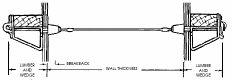

Wow!! This sure went off track. I apparently did not word my question correctly, but the answer appears to to be that either PT or regular plywood will work for me. So let me try again to describe what I'm doing. I'm putting a storm shelter inside my house. First of all there is already wood framed walls in place. I want to use the studs and nail 3/4" plywood to it as one side of the forms and use the form ties to provide the proper spacing of the plywood. Once the concrete is poured I will only have access to one side of the wall, so the forms on one side will have to remain in place. My concern had more to do with long term rot since the wood will always be in contact with the concrete. Then on the side I do have access to, since the plywood is already in place and the lath is the same thickness, why not just leave the plywood in place as the lath and I can mount anything anywhere on the wall. There's the moisture issue again. This was intended more as a question about after the concrete is poured and now ready to remove the forms, what happens if I don't. Sorry for the misunderstanding.
Sounds like I will be fine using regular 3/4" plywood for the forms and leaving it in place permanently (with the addition of the proper bracing with 2x4s).
I'm guessing your existing wall is 16" on center 2x4 studs 8' tall?
If so, that's not enough bracing for a plywood form for an 8" thick wall.
You'll probably need to run horizontal 2x4s on edge perpendicular to the existing studs on the side opposite from the concrete to act as bracing. I can't remember the distance apart, but you'll need that bracing in both the vertical and horizontal axis's. If you only use the existing 2x4 studs backing the plywood, there's a decent chance the plywood will bow the 2x4 studs, they can snap, then you have concrete pile on your floor. And as we all know... its not easy to clean up.
Look at these forms and how they are built.
how to build concrete forms plywood - Google Search
When I did my barn foundation and walls, I made plywood forms following directions from the company that manufactured my form ties. I also rented the lock pieces that held the form ties outside the forms from the place I purchased from. As I recall, the locks were wedged in with the horizontal 2x4 bracing, and came out by hamering the bracing out. I'd have to go back in time to remember how they worked exactly.
You'll also need some temporary diagonal bracing perpendicular to the wall. It's a lot of weight to keep from tipping over. Even if its anchored at the top and bottom, it could tip over or blow out.
If you have a local concrete contractors supply store, go there and consult about which form ties to use, what types of form ties to use, connectors and locks, spacing of bracing, form release agent so you can pull a form off if you want, etc... that's the best place to get your hands on the products, and some instruction on how to use and assemble the parts to create a strong form.

Like these, as I recall...
