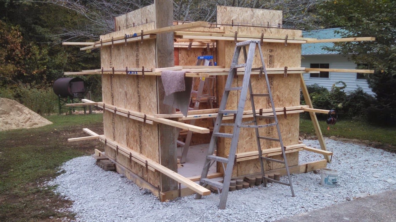

This is my 8' square x7+' high storm shelter wood layout for my storm shelter. It is not complicated but need snap ties and double 2x4s around inside and out every 2'. But can be reused later for other things.
Once the wall is done I pulled it all off and made the roof.
