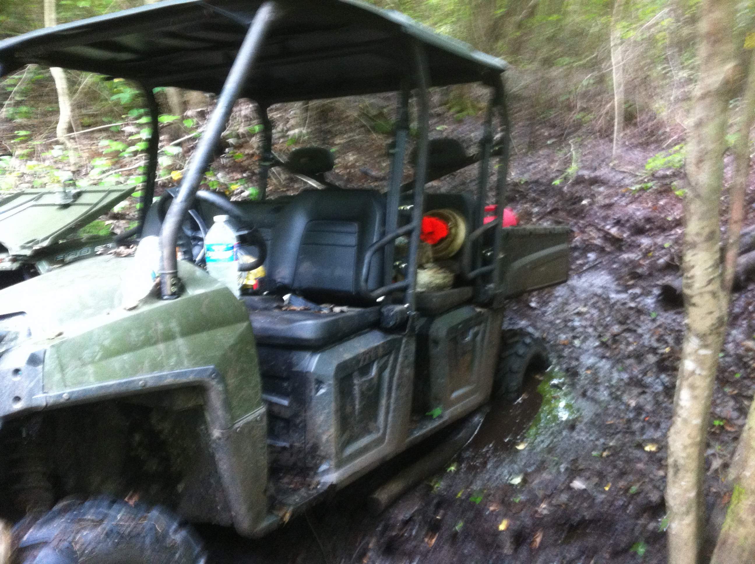

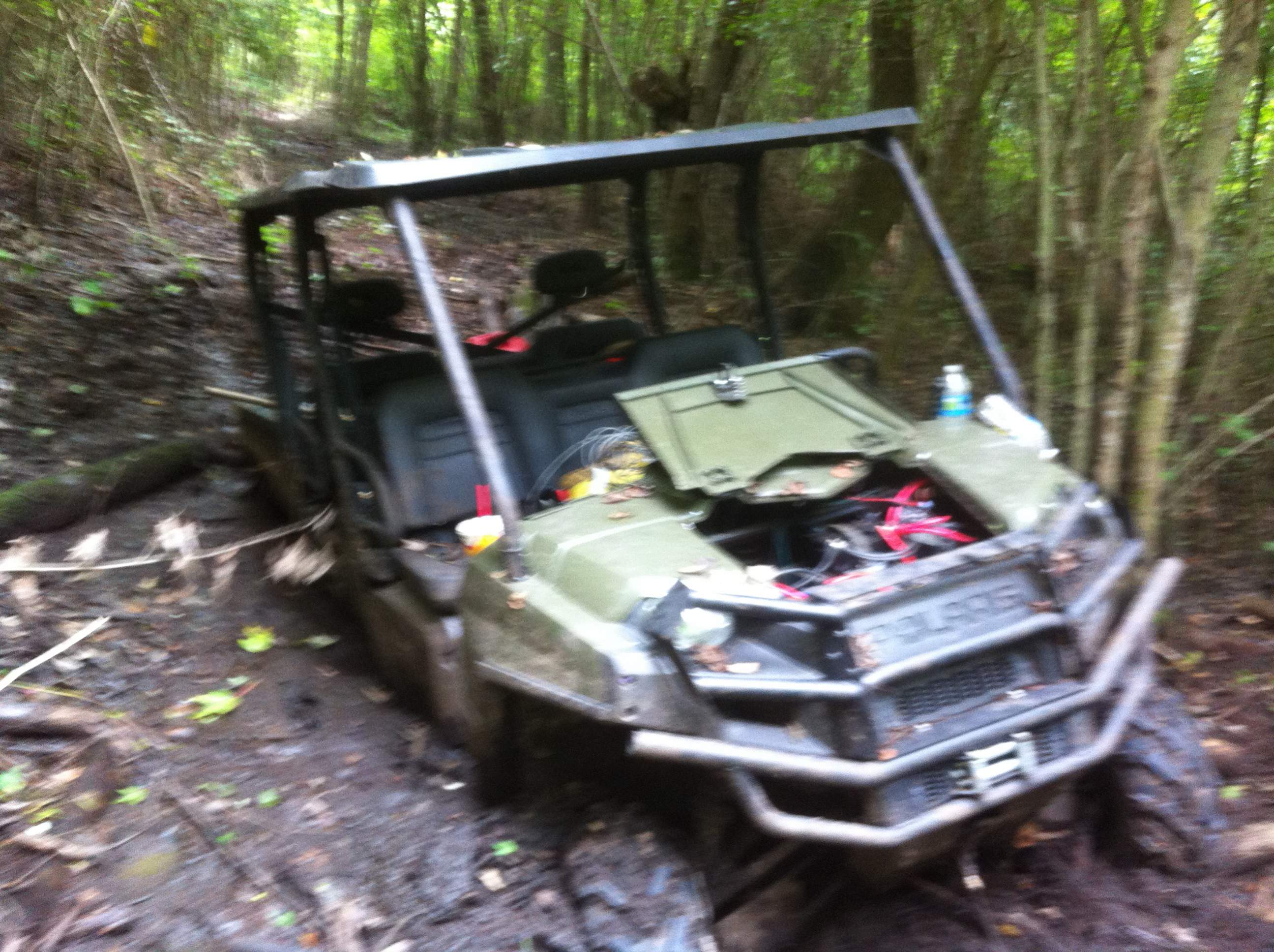

Wel....still trying to get the Polaris out, and it did not move today because some guys a week ago appeared to have broken my winch and two electical winches which we needed today. Trying again next Saturday. Attached are some photos and maybe a poor video in which I was falling most of the time! Jim IMG_2787.jpgIMG_2795.jpg

Here are a few others.

We are going to try Saturday. We did not expect the broken cable, so we did not bring the tools. It appears the guys pulled the cable full length and then tried to pull out. The end of the cable is connected to the winch by what looks like an "eye-bolt" and it broke off.
We have to take off the "bush-guard" to get to the winch.
The mud is like quick sand. It did move enough I could see it is stuck on and between small stumps. We plan to pull-lift and have a winch pull it to the left at the same time. What an experience..every will loan my equipment again! Thanks, Jim

That's pretty stuck but looking at it I can't believe it can't drive out....I would have expected if you jammed some staggered logs under the tires and used 4 wd along with a light pull from the winch that it would pull right out. I would have thought with mud that much like quick sand it would have sunk in deeper by now. I wonder what type of damage there will be when it finally gets out?

Can you hook high up on one of the trees to the side or slightly behind with a come-along and lift it first, then block up the wheel and pull it forward?
Good luck and if you have a snatch block it maybe worth taking with you!

DixieD, You are right that it should have sunk more in back. It is held by the stumps just under the area between the front seats. We are going to try the lift rear and pull forward next weekend. We have a front strap with "come-along" high up a tree to the front right as we hoped to pull it slight sideway and then forward. This did not work because of it being stuck or weged between the stumps.
So next weekend we are going to run chain high up two trees near the rear, stage a boat lift "thinga' ma duche" with a hook and rachet to lift the rear with slack in the chains between the trees so it can come forward.
