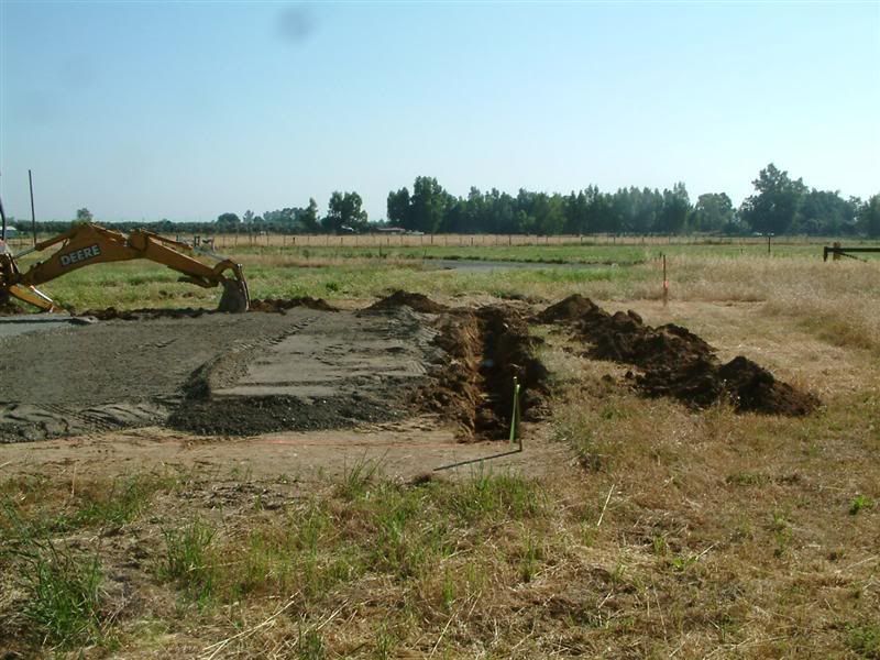

Thanks for a great amount of information, opinion, and wisdom. Here's an update:
Bought the 30x40 pole barn package from southerlands for $4100 with a few design changes in mind. On the narrow end I added a 16 x 30 loafing shed for livestock, and on the opposite end a 10 x 30 covered shed for parking the tractor and implements. My initial question was what to do about the floor. Budget didn't allow me to pour a slab right now. I left the floor dirt and will tackle that later. I plan to insulate with 1" rigid foam and then place three quarter OSB over that.
My new question is "What's the one thing you wish you would have done (or glad that you did)when building your shop/barn?"
Thanks

I built 32 x 64 x 12' H one thing should have pipes in floor for radient heat . Collectors on the roof with photovotaic pump. Keep it at 35-40d all by itself.
second thing steel roof I did shingles.
Good things
vapor barrier and foam under the concrete. 5 x 10 flats of wire
4 inches concrete did not do control cracks should have but did not really matter
6" insulation at the 12' ceiling and the walls. 4' drywall up the walls to cover the wiring.
in the gable end 10' w x 11'3" door 3 " thick with power opener. in the long wall facing south 10 patio glass replacement panels 30" by xx standing vertical starting 4 ' high
So building is dry , fairly lite up for walking in and finding things, insulation under the floor keeps the concrete from being a cold trap.
The windows all have broken glass sensors tied into an alarm system, Really big horn.
UMM I have seen the creek out of its banks 10' from the door once and 1 foot from the door once in 20 years. SO maybe 12 " higher. But then it is a barn.
