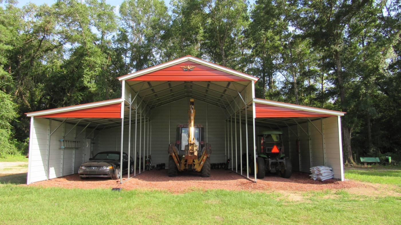

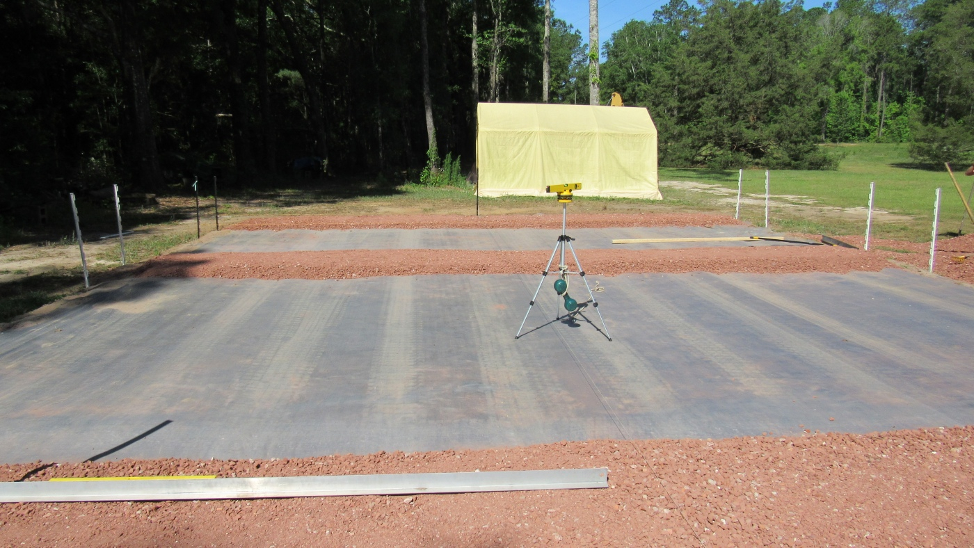

Check around on pricing.
Flooring depends on your needs and if you just want dry storage or a work shop.
I had Carolina Carports put up a 3 sides enclosed 31x42 in May of 2020 for $11,400. They were running a 10% off sale for buildings over 10 grand. It is three section with 9' outer walls and 14' center section walls. They advertised it as Florida Spec for 170 MPH winds with the upgraded 12 gauge metal frame. I much prefer metal over wood.
I had about a grand in ground prep before they arrived. I leveled the slightly sloping area with clean sand and drove my backhoe over it multiple times to pack. Then I re-smoothed it and covered with a large heavy duty tarp. I topped it off with 4 inches of crushed red brick. I didn't have enough of the brick to start so I laid out four, 4' wide by 4" deep sections for the main frame runners to sit on. I had enough brick to fill the centers with about 2" before the builders arrived. I hand tamped and checked and rechecked for level with a HF laser. My SIL checked behind me with a self leveling Bosch unit and I was within a 1/4" all around. CC said they could work with a 3" variance. The uprights slide onto the bottom runners a foot or so. My level was good enough all the uprights are bottomed on the runners. After the building was up I filled in the rest with more crushed brick to level it all out.
Two men showed up with the materials on a trailer and pulled out two and a half days later with my barn standing finished. Construction quality was AWESOME! These guys knew exactly what they were doing. Popped chalk lines for every row of screws and not a screw out of place. They picked up pretty good but I did have to go behind them with a magnet to find the stray screws they dropped.
This photo was taken before I filled in the rest of the brick. I also added about a 15' apron on the front.
