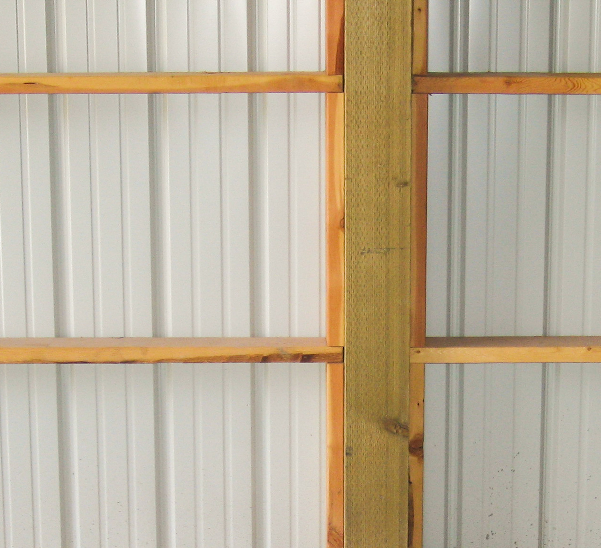

While I'm waiting for delivery I have too much time to think :unsure: since we ordered 2x6 gerts maybe I could bookshelf them for that "just in case" scenario.
So instead of blocking between them I could notch each one into the 6x6 posts ???

The genius of a pole barn is in how much strength you get in such a simple design. When you change the engineering of that simple design, you create other issues. The basics are poles in the ground and purlins attached to the side of the posts for the full length of the building. This ties everything together in a very strong design. If you change this, you have to compensate for the loss of strength. Notching posts to run purlins on the flat in between each post will create a building with less strength. It's doable, but it will cost more and take longer to build.
No way! No notching of the main support posts is allowed (except at the very top for carrying the roof trusses, if you like to do it that way). The posts hold up your walls and roof, you don't want to weaken them.
Yes, these are bookshelf girls and no, they are not notched, these are fine as they are just attached to the 6x6.
you would not even need to add those vertical 2x6, just toe nail the 2x6’s horizontally to the 6x6.
the end result is the metal can be screwed to the 2x6 on the outside and the drywall can be attached to the same 2x6 on the inside.
the insulation will lay on top of the horizontal girt.
this is exactly What I am doing in my 60x60 pole barn. The posts carry the load, no need to build a “secondary” wall within the wall as it’s not carrying any load. It’s just used to run wire, keep the insulation in place and screw the drywall to.
if you are gonna go down this route, look at some articles on advanced framing.

I should note, my girts are just 2x4’s and they run across the outside of the pole all the way down. So I have an extra 1.5” from the metal to the post.
I have added the 2x6’s between each post as the bookshelf, for insulation and drywall.
like eddie said, you can create the structure in a bookshelf fashion, but it may be more labor intensive.

Here is a picture of what I am doing…maybe this will help.

I see you still have the girts at the outside.
Yes. but Once the building was up, I learned that you could have had it constructed in a complete bookshelf manner.
point is, you definitely do not need to build a wall inside of the posts, you will just be wasting lumber.

I have access to a Sheetmetal shop down the street maybe fab some 5"x1.5"x1.5" 20 gauge L brackets even C type brackets.
   / Pole barn build now or wait? #56
If you didn't want to use full verticals, you could also simply take the worse of the boards and cut them into ~2" x whatever cleats for the horizontals to sit on. Simplest way to go.
This is really not necessary. I used a nail gun and toe nailed a nail towards the outside (2 nails) and one underneath the middle. I weigh 200 lbs and can stand on these.
the only purpose this serves is a nailer for drywall and to hold insulation in.
I think you may be overthinking this.
