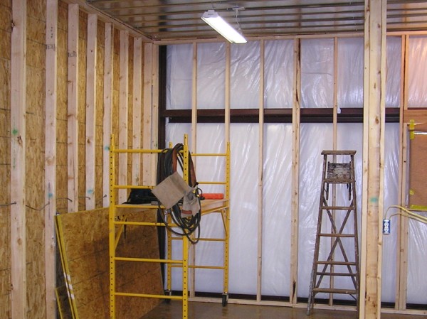

I'm in process of building a weekend apartment in my metal barn - used v-groove panels for the ceiling. here's the best shot I have of it. We like it.

As a comparison, me and a buddy put up an OSB ceiling in my 32x40 polebarn about a month ago. I found a good deal on 7/16" OSB for $6.95 for a 4x8 sheet. 40 sheets and less than 5 pounds of drywall screws. I rented a drywall lift and we did the job in about a day and a half. I already had lighting, fans, garage outlets for garage door openers, garage doors, and a chain hoist installed that we had to work around.
